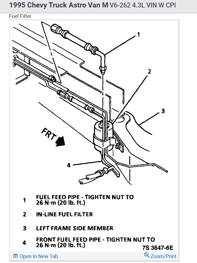

I would change out the fuel filter as well if you have not done that with the tune up.
and
https://www.2carpros.com/articles/how-to-change-a-fuel-filter

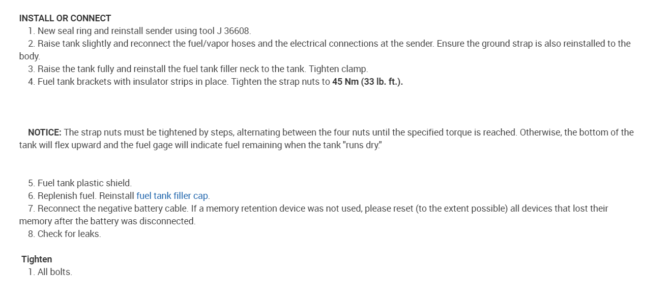

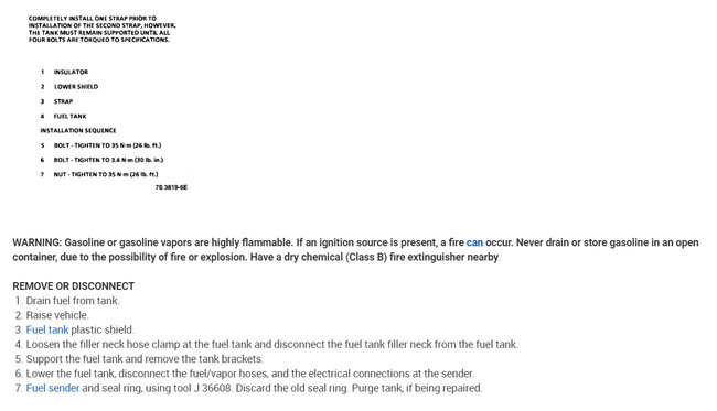

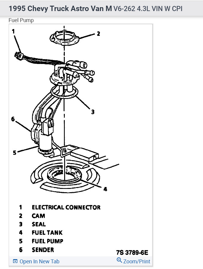

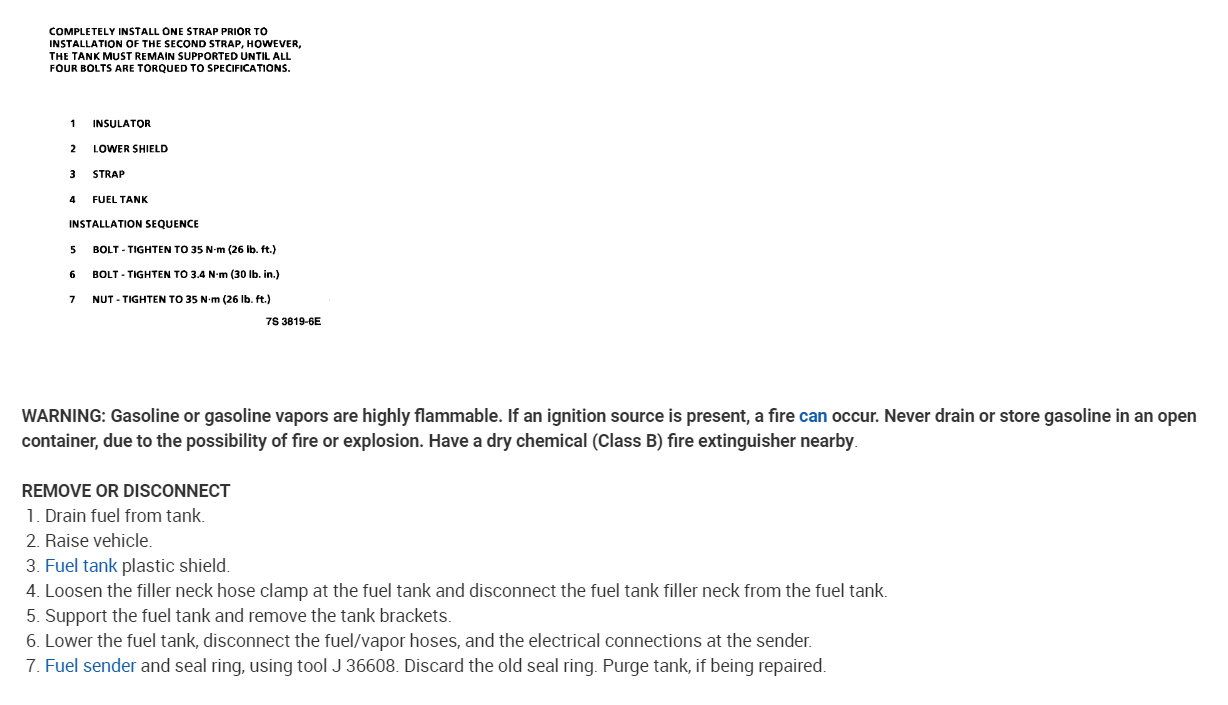

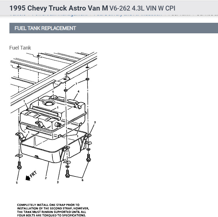

Instructions and location for your car are in the images below. Check out the images (below). Please let us know what you find. We are interested to see what it is. The fuel tank will need to be removed to change the pump out. Be sure the gas tank is empty before you start.

The fuel filter was extremely dirty, also changed out ignition coil, air filter and added a bottle of gum out injector cleaner. Runs great, thanks.
