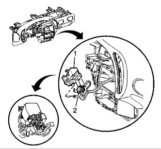

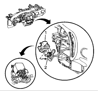

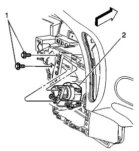

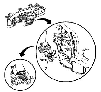

Hi and thanks for using 2CarPros.com. Here are directions specific to your vehicle for removal and replacement of the switch. The second set of directions are for the cylinder replacement and include a section for Without key
Ignition switch replacement.
REMOVAL PROCEDURE:
Remove the Instrument panel cluster trim plate.
Remove the radio.
Remove the ignition lock cylinder.
Remove the fasteners (1) from the ignition switch (2).
Push and release the retaining tab at the rear of the ignition switch.
Pull the ignition switch through the radio opening.
Disconnect electrical connectors (2) from ignition switch (1).
Remove the ignition switch bulb from the side of the switch.
Disconnect the shift/park lock cable from the ignition switch.
INSTALLATION PROCEDURE:
Connect the electrical connectors (2).
Connect the shift/park lock cable.
Install the bulb to the side of the ignition switch.
Install ignition switch (2) by routing through the radio opening and position to the retainer.
NOTE: Refer to Fastener Notice in Service Precautions.
Install the fasteners (1) securing the ignition switch to the IP retainer.
Tighten
Tighten the fasteners (1) to 9 Nm (80 lb in) .
Install the ignition lock cylinder.
Install the radio.
Install the Instrument panel cluster trim plate.

Remove the fasteners securing the ignition switch to the I/P retainer.
Remove the ignition switch through the radio opening in the retainer.

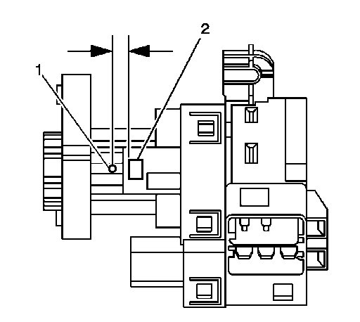

Locate the surface for the ignition switch lock cylinder release button (2) on the plastic ignition switch housing and center punch a location (1) on the "rib" approximately 3/8 inch rearward (toward the key entry end) of the cylinder release button.
Drill a pilot hole through the plastic housing with a 1/8 inch drill bit.
Drill a larger hole at the pilot location, and slightly into the ignition switch lock cylinder surface to break the release button retaining spring using a 9/32 inch drill bit.
Remove portions of the broken spring from the hole using a small suitable tool.
Grasp the ignition switch lock cylinder and remove it from the switch housing.
Remove any plastic "flash" from the drilling operation, and using compressed air blow out the ignition switch assembly, proceed to step 9.

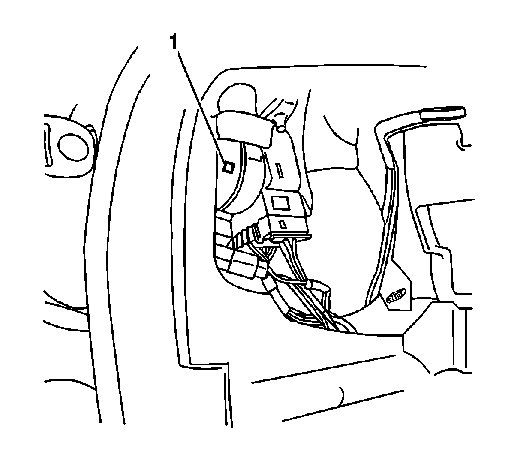

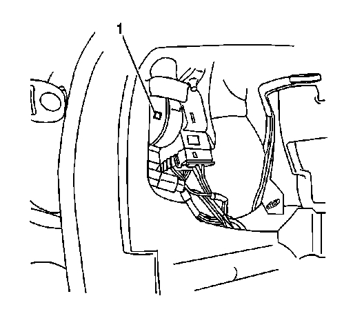

Look through the radio opening in the I/P and locate the release button (1) on the side of the switch.

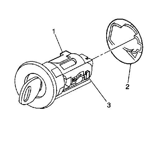

Depress and hold the ignition lock cylinder retaining tab (located on the right lower side of the ignition switch), using a flat-bladed screwdriver or other suitable tool.
Pull outward on the ignition cylinder (1) in order to remove the cylinder from the ignition switch.
Remove the reader/exciter module from the ignition lock cylinder.
