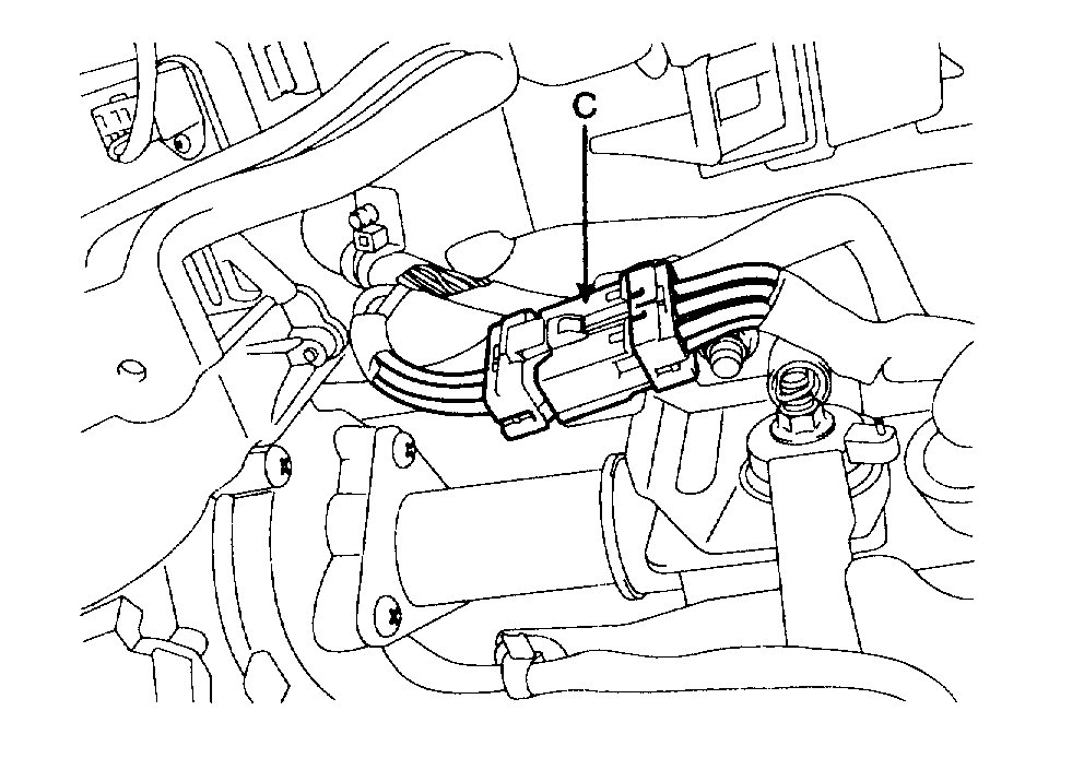

Picture 1

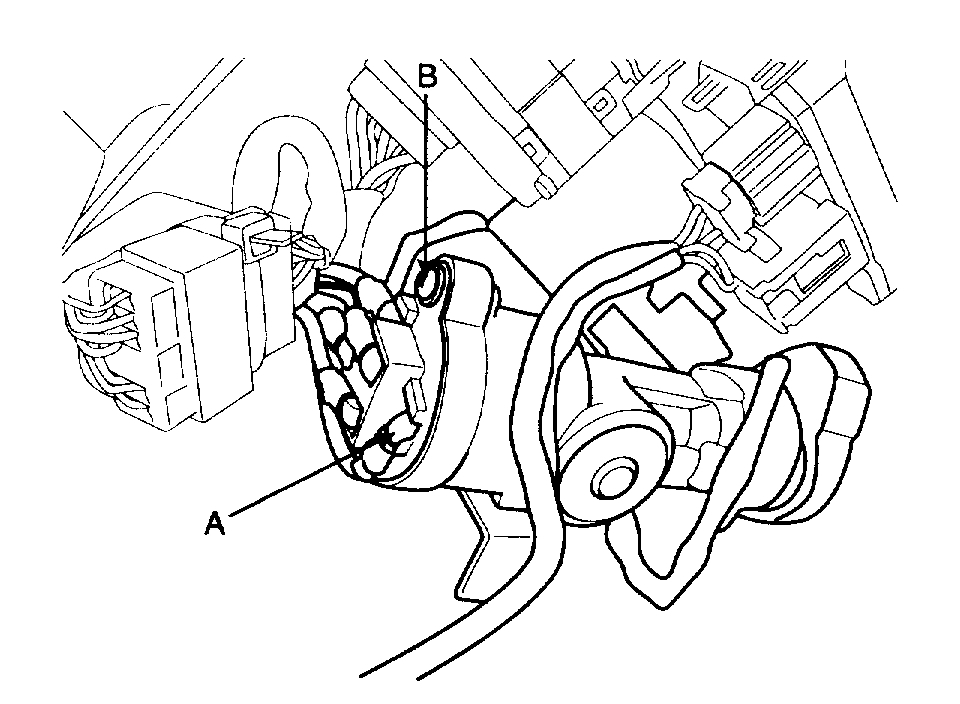

Picture 2
3. Remove the ignition switch (A) after loosening the screw (B) with IG ON and disconnecting the 6P connector (C).

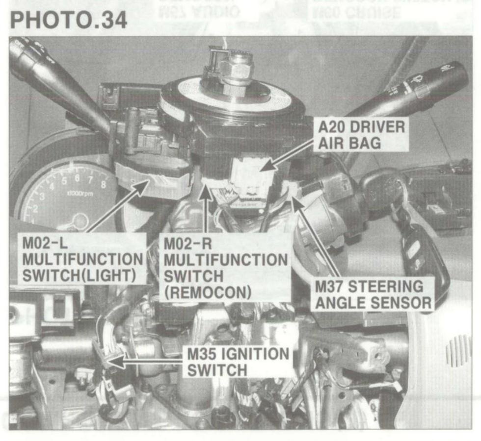

4. Remove the steering column cover.
Picture 3

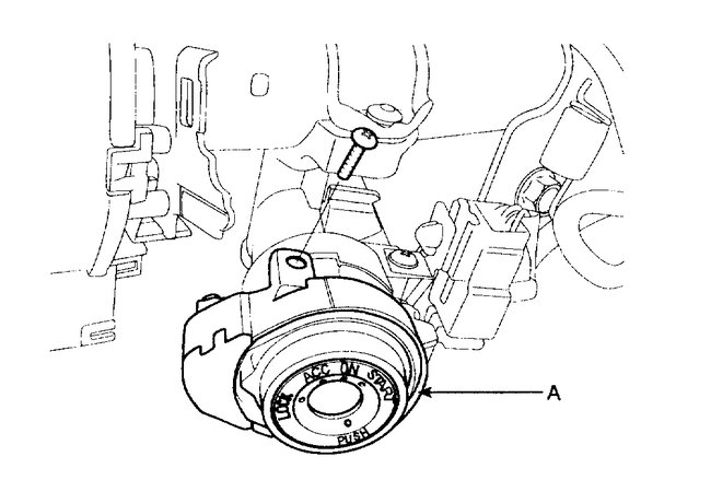

5. Remove the door warning switch and key illumination lamp (A) after loosening the screw and disconnecting the 6P connector.
Picture 4

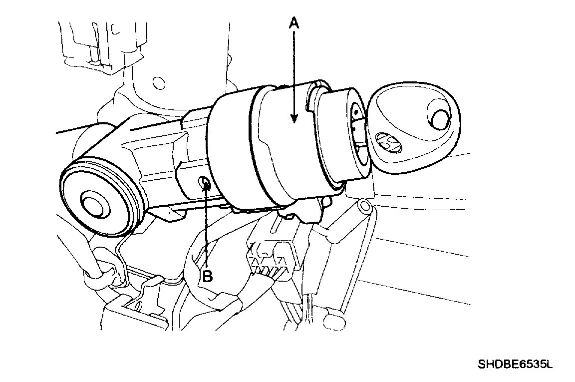

6. If it is necessary to remove the key lock cylinder (A), Remove the key lock cylinder (A) after pushing lock pin (B) with key ACC.
