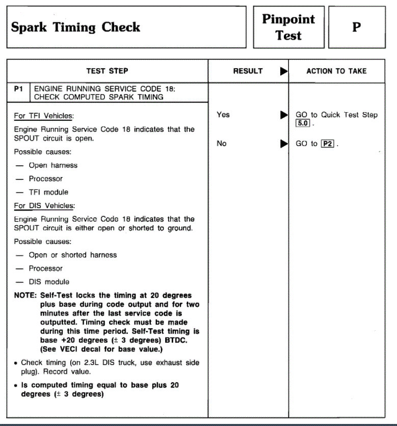

Now, the spark issue will require a little bit of testing. The code, 18, indicates an issue with the spout (spark out). Since you indicated the timing was all over the place, I jumped to step 4 in the testing. Take a look at the pic below and let me know if you are comfortable doing it.

See pic below.

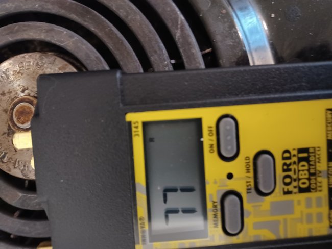

hi Joe, i just got the code reader. the code came back11 nothing wrong. when i did the test with engine running it said that the truck was a 6 cylinder and gave me 2 codes 41 and 77. is it possible for the truck to run if someone changed the ECM.

It could run, but how well is a different question. Code 41 indicates a lean fuel mixture and the 77 is a code related to a self-test. Have you ever have these codes before?
Let me know. Also, where did it indicate the six-cylinder engine?

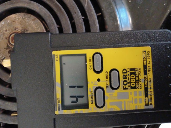

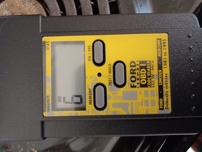

hi Joe. I ran to the code reader in the engine running key on. when i started it. it came up cylinder 6. then it gave me a 41, then 77.. when the engine is idling it has a surge like a bad vacuum leak but I have not been able to find one.
Mar 17, 2022 at 4:22 PM
JOHN EDWARD
  • 15 POSTS
this is a pic of code reader.
Mar 17, 2022 at 4:36 PM
Could that indicate an issue with cylinder 6? Is the scan tool able to do any other tests? For example, can it tell you fuel trims?

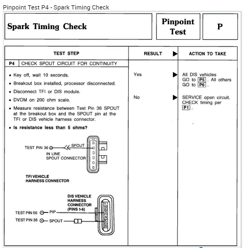

Code 18 (KOER) indicates a timing issue related to the SPOUT. That is one of the first things we identified.
Try the test below and let me know what you find. Based on the findings, I need to determine what to check next.

Hi Joe, sorry it took so long to get back to you. let's try this from the start again. I found the spout and checked it; it came back 0 ohms with it out i checked the timing the mark is holding solid at about 10 degrees btdc. with the spout disconnected i reran the code reader it came back code 11 and 11 . i started the engine with spout unhooked and ran codes they came back in this order 8 cyl. 12, 21,41,18 and 77 I hope this makes sense to you. thanks again, John

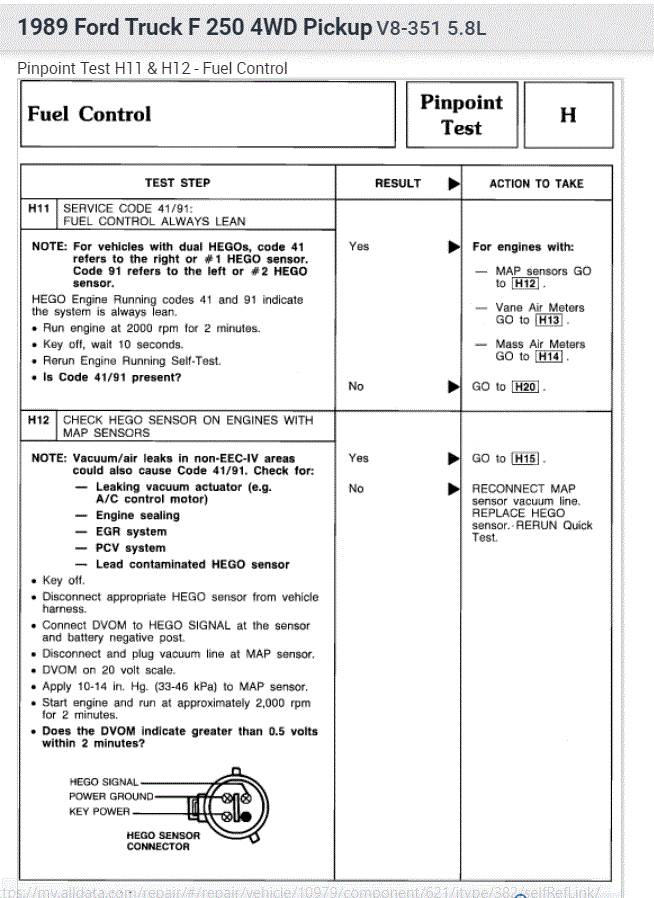

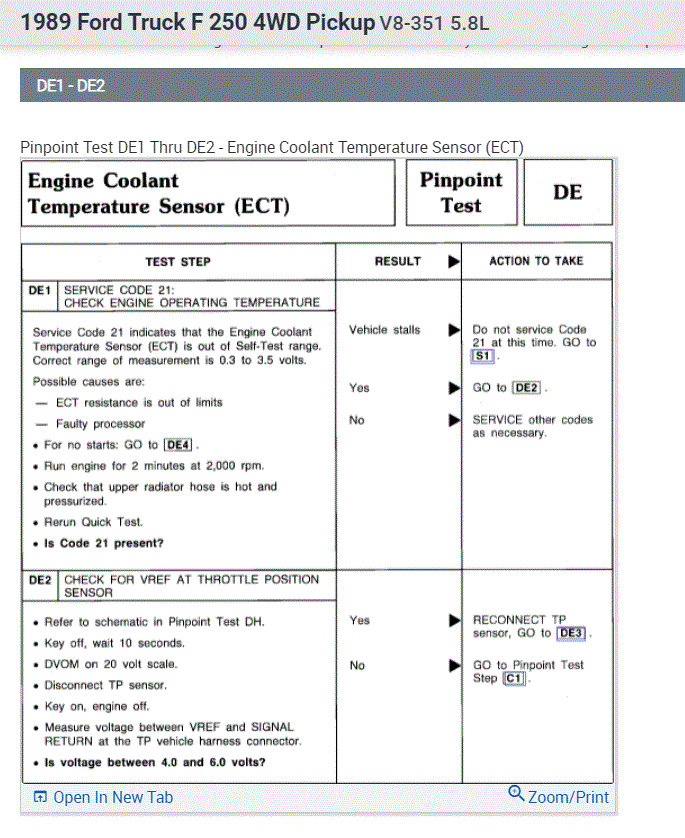

The new codes are all over the place. As far as the 0 ohms, that indicates there is a connection with basically no resistance.
Code 21 and code 41 are interesting to me. The 21 indicates the engine coolant temp sensor is out of range (which could cause an air/fuel mixture issue) and the 41 indicates the system is always lean. We may have a very simple issue dealing with a weak fuel pump, an engine vacuum, or a faulty heated exhaust gas oxygen sensor (HEGO).
I attached two tests below. Let me know what you find.
See pics below. Also, are these the only codes that were retrieved this time?
