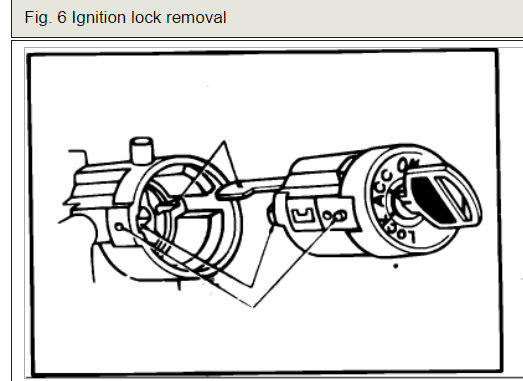

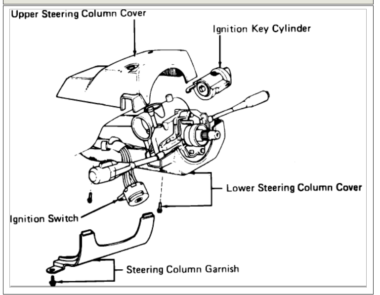

if rod isi inside steering column it's going to be tougher and if a tilt wheel worse. see pic for lock cylinder. car may need reprogramming after doing this so it will start.

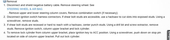

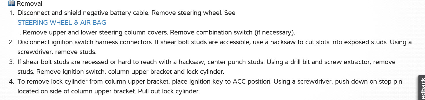

Hello
Here are instruction and diagrams below.
Disconnect battery ground cable.
Turn ignition switch to ``ACC'' position.
Insert a small diameter rod into hole located on side of lock cylinder, then while holding down pin, remove lock cylinder, Fig. 6.
Reverse procedure to install. Ensure lock cylinder is in ``ACC'' position.
Cheers
