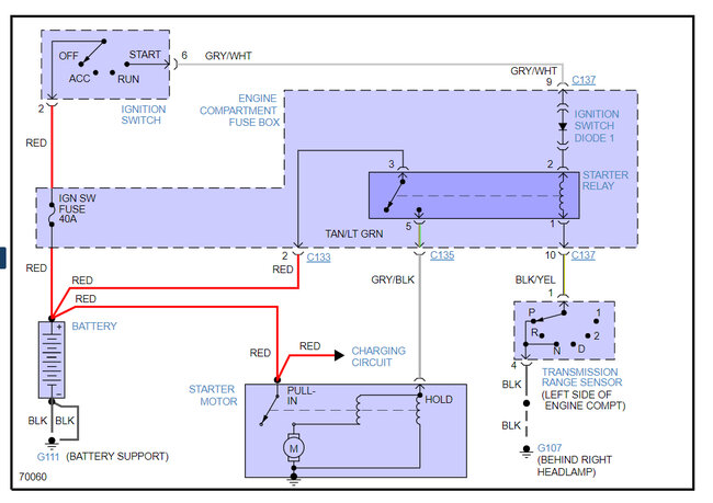

The vehicle had a interlock in it and was removed by the owner and the vehicle will not start. checked the wiring cam sensor, ignition relay, coil, timing, and codes all good. Help

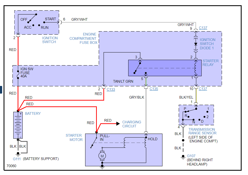

Is the security light flashing when you try to start it? If so the security system is engaged and wont let the car start. There is not a way to bypass the system because it is integrated into the computer of the car. I would check the 40 amp ignition switch fuse under the hood. Here is thes tarter wiring diagrams so you can see how the system works. Check out the images (Below). Please let us know what happens.

The security light isn’t flashing it tries to start but almost acts like it’s out of time but it not to get it to do this you have to hold the throttle down about half way
