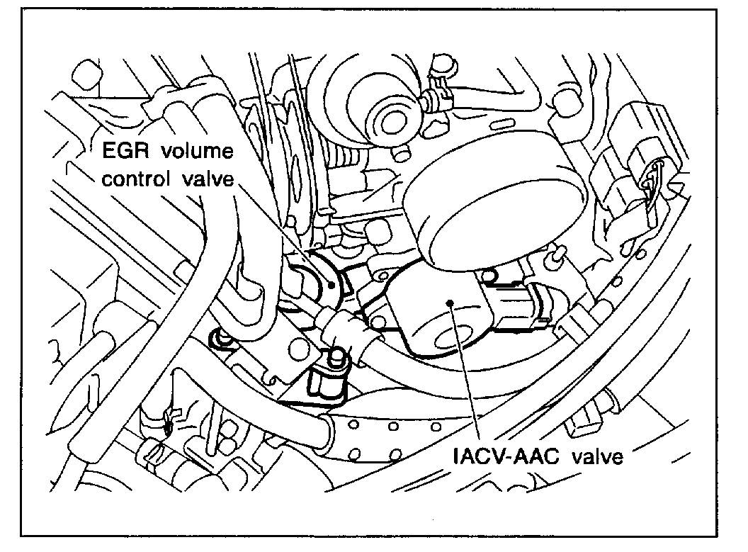

Based on your description, it sounds like there is a problem with the IACV-AAC valve. This system automatically controls engine idle speed to a specified level. Idle speed is controlled through fine adjustment of the amount of air which by-passes the throttle valve via IACV-AAC valve. The IACV-AAC valve changes the opening of the air by-pass passage to control the amount of auxiliary air.
Now before just replacing the valve, check to make sure there is no carbon build up on the throttle plate. If it appears clean and closing properly, then remove the IACV-AAC valve and inspect it for carbon or any dirt.

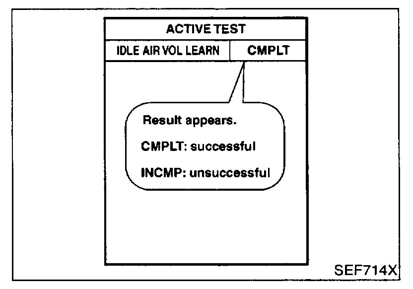

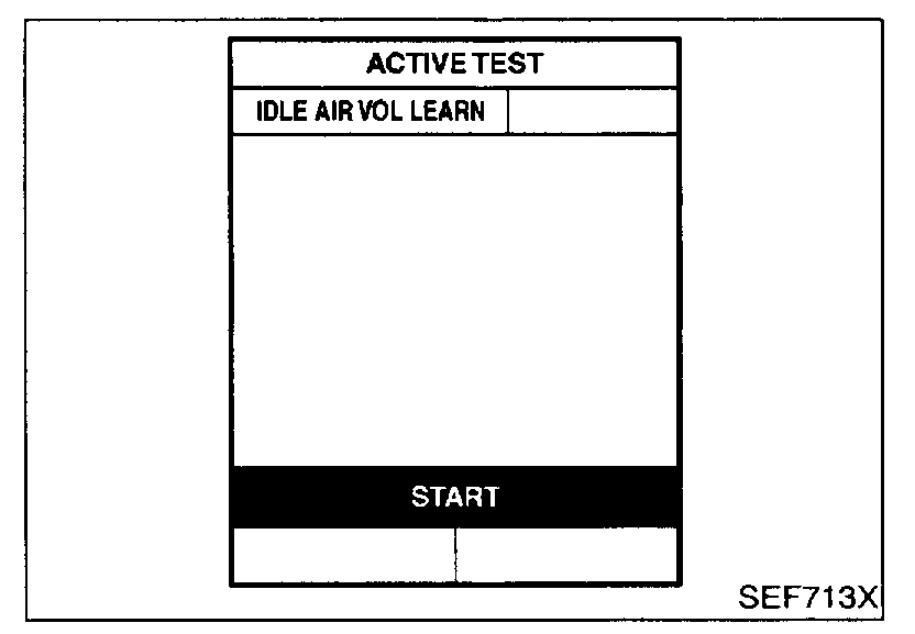

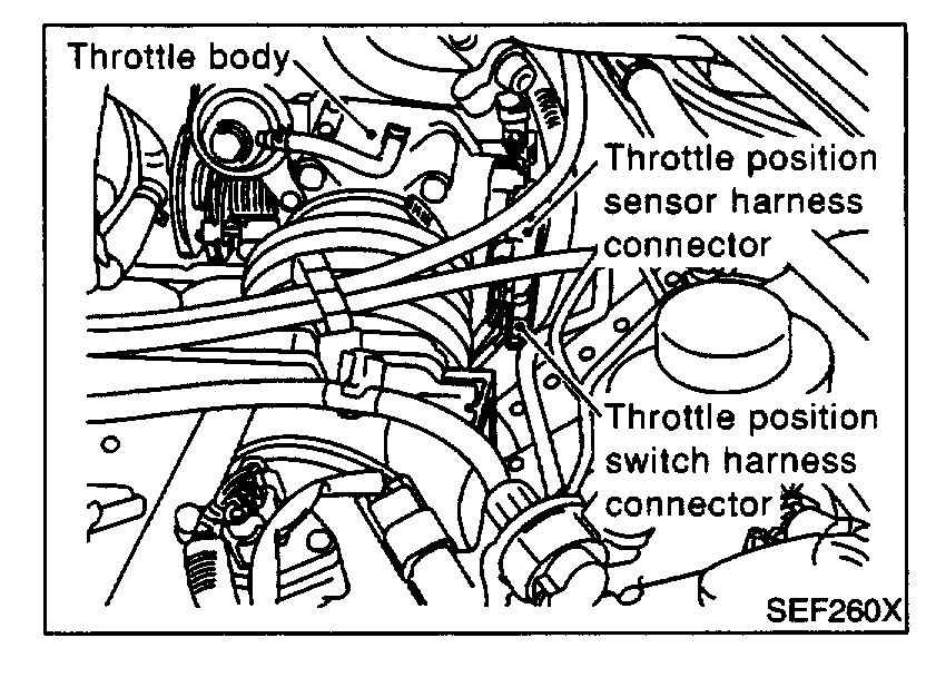

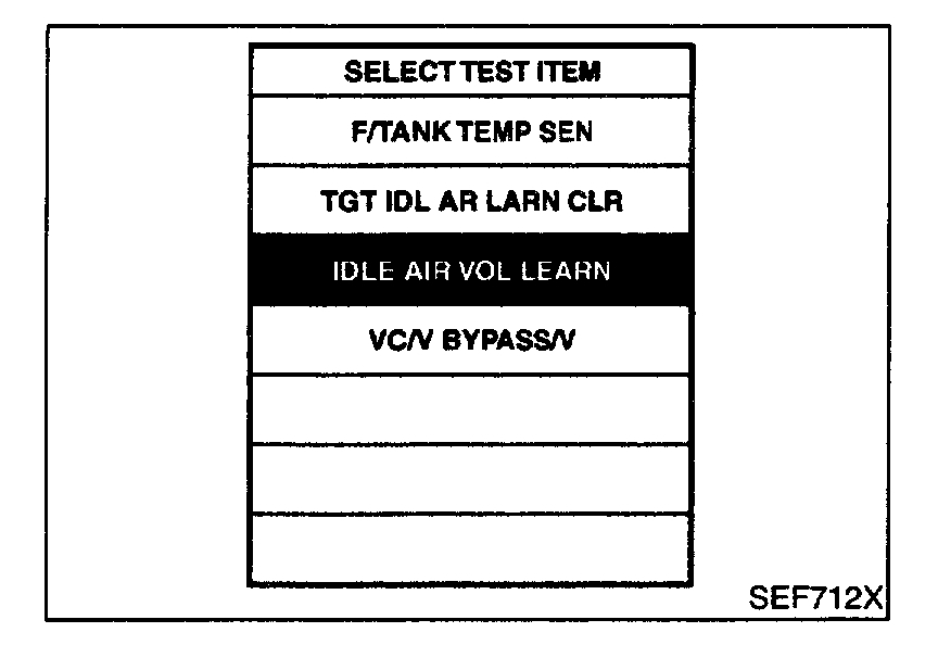

I have attached a picture of the component and location for you. If the valve is to be replaced, there is a relearn process that requires Consult II scanner or equal. Here is the relearn process with a manual transmission. Starting with picture 2, the remaining pictures correlate with these directions.

5. Select "IDLE AIR VOL LEARN" in "ACTIVE TEST" mode.
6. Touch "START' and wait 20 seconds.
7. Make sure that "CMPLT" is displayed on CONSULT-II screen. If "INCMP" is displayed, "Idle Air Volume Learning" will not be carried out successfully. In this case, find the cause of the problem by referring to the NOTE below.

5. Disconnect throttle position sensor harness connector (brown), then reconnect it within 5 seconds.
