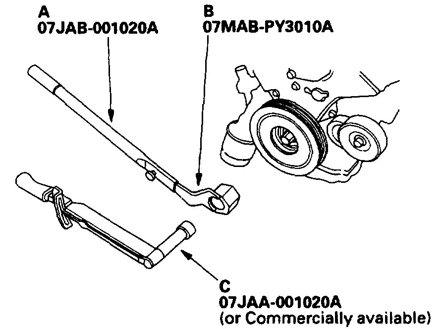

Special Tools Required
- Holder handle 07JAB-001020A
- Holder attachment, 50 mm, offset 07MAB-PY3010A
- Socket, 19 mm 07JAA-001020A or a commercially available 19 mm socket

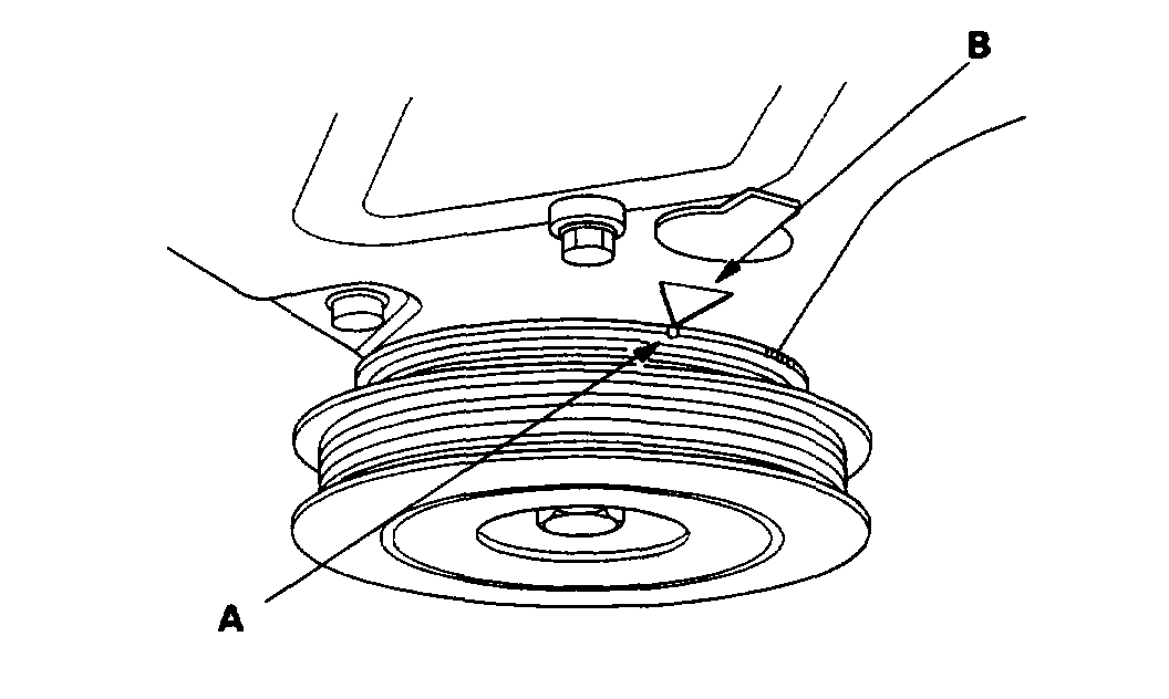

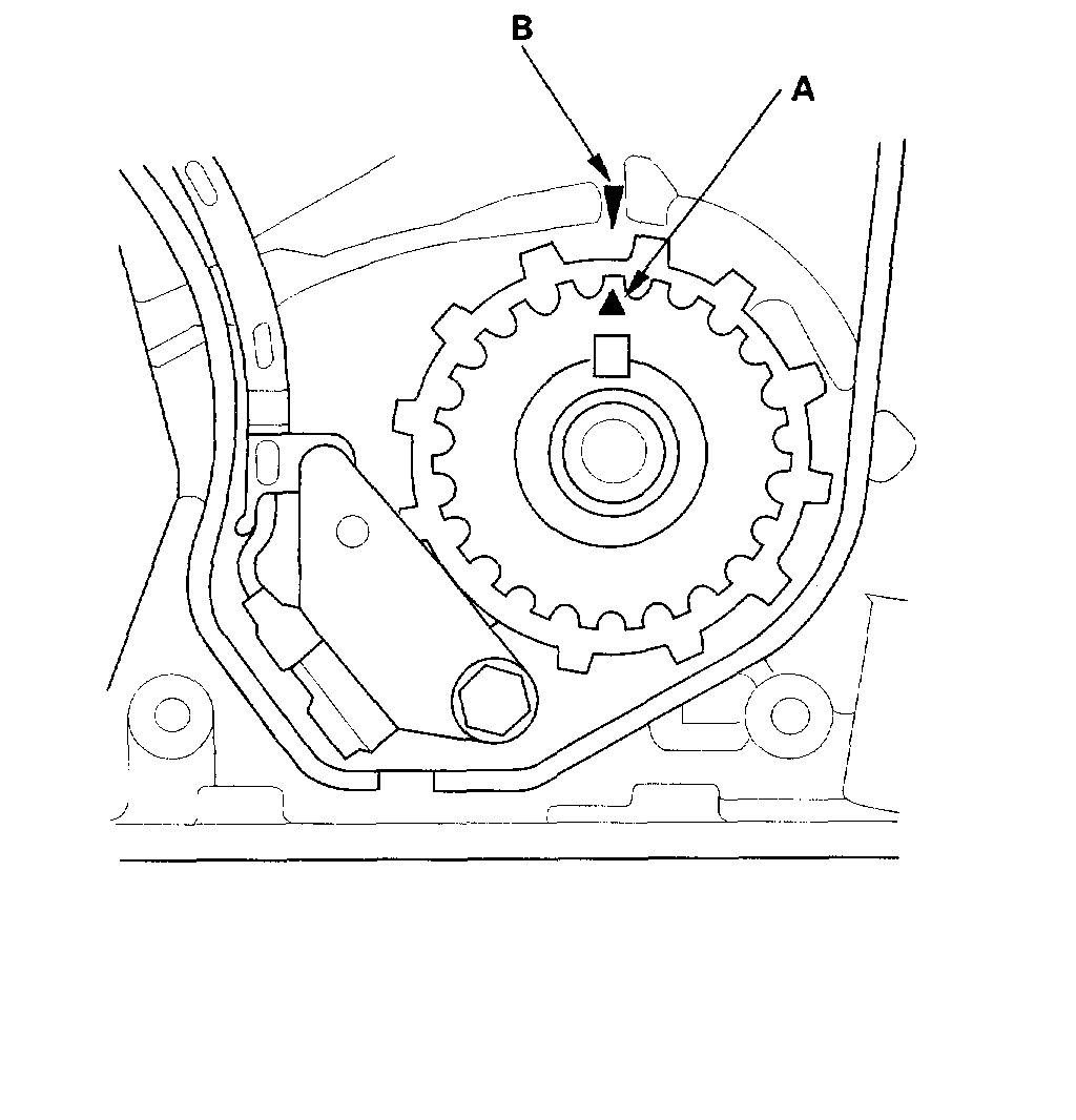

1. Turn the crankshaft so its white mark (A), lines up with the pointer (B).

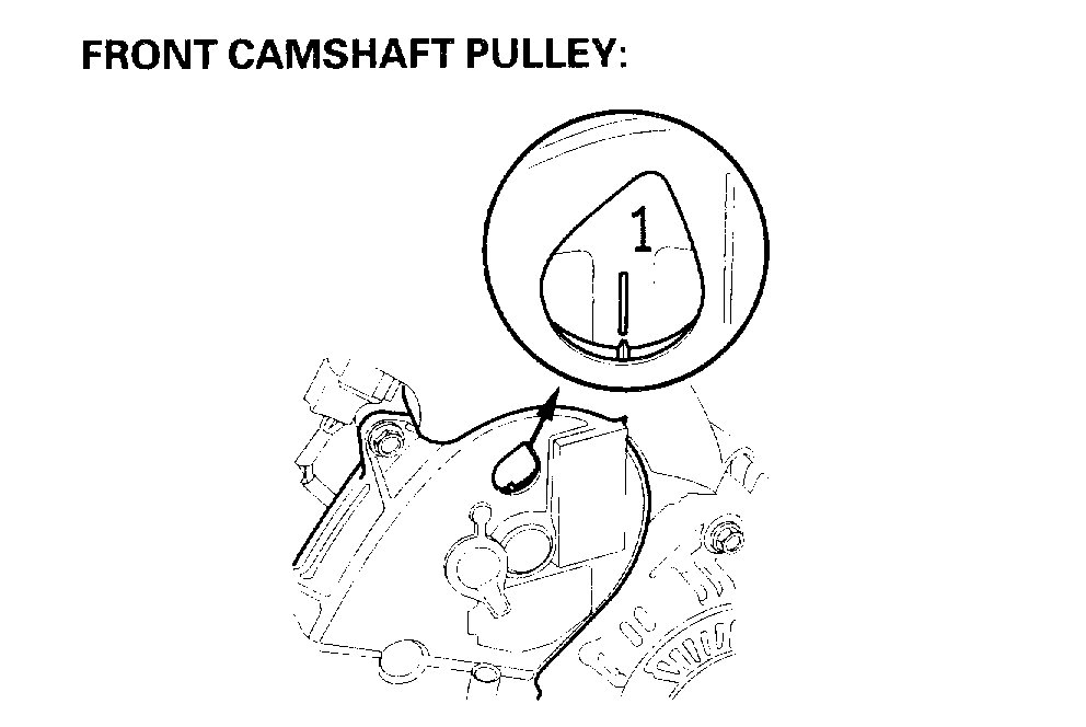

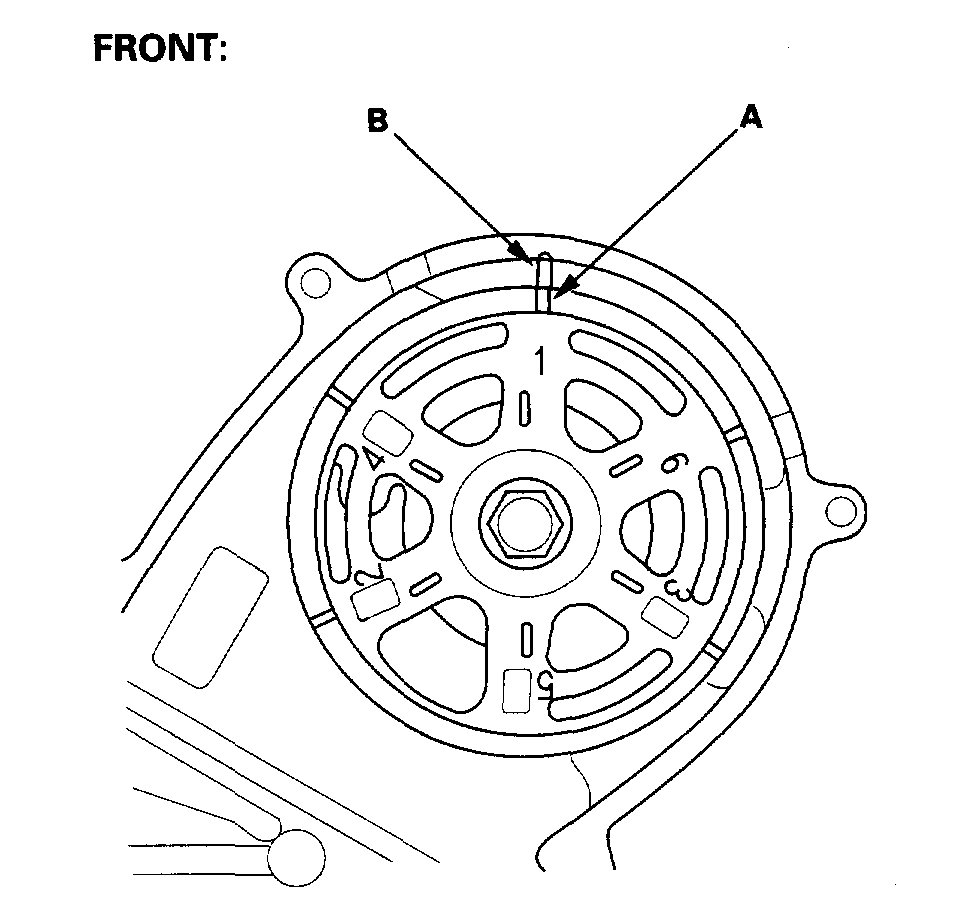

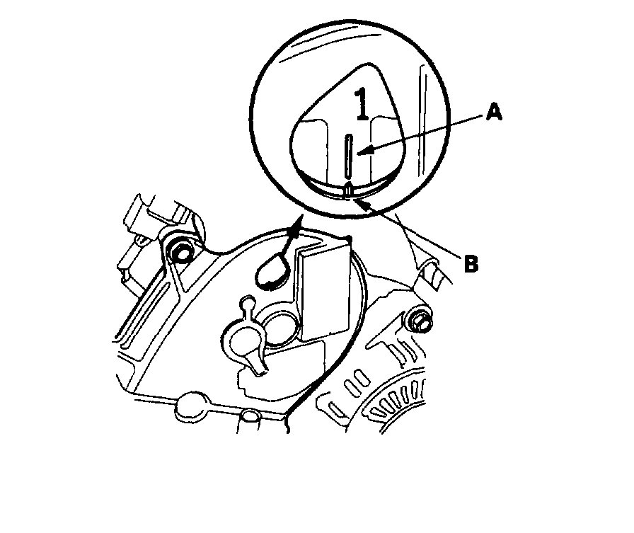

2. Check that the No. 1 piston TDC mark (A) on the front camshaft pulley and the pointer (B) on the front upper cover are aligned.

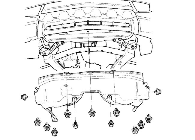

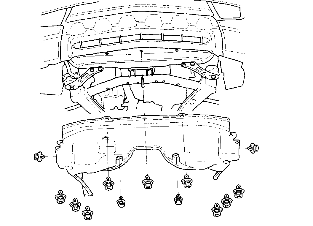

4. Remove the splash shield.

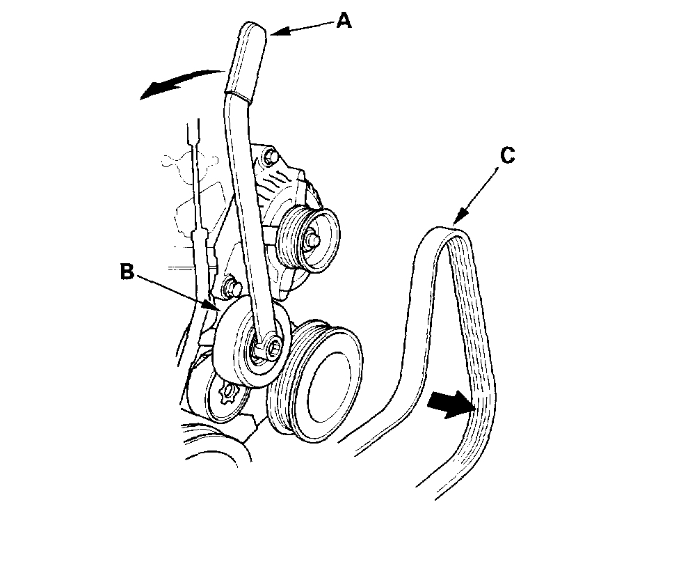

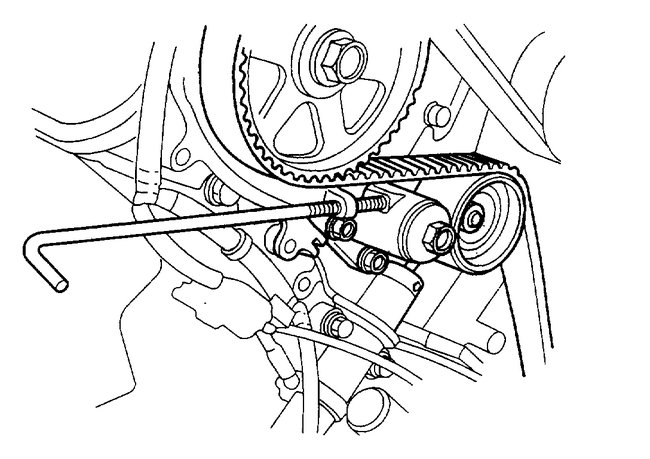

5. Use the belt tension release arm (A) to move the auto-tensioner (B), then remove the alternator belt (C).

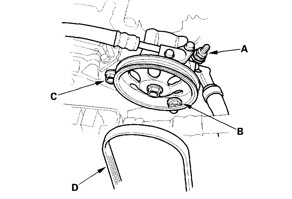

6. Loosen the adjusting nut (A), locknut (B), and mounting bolt (C), then remove the Power Steering (P/S) pump belt (D).

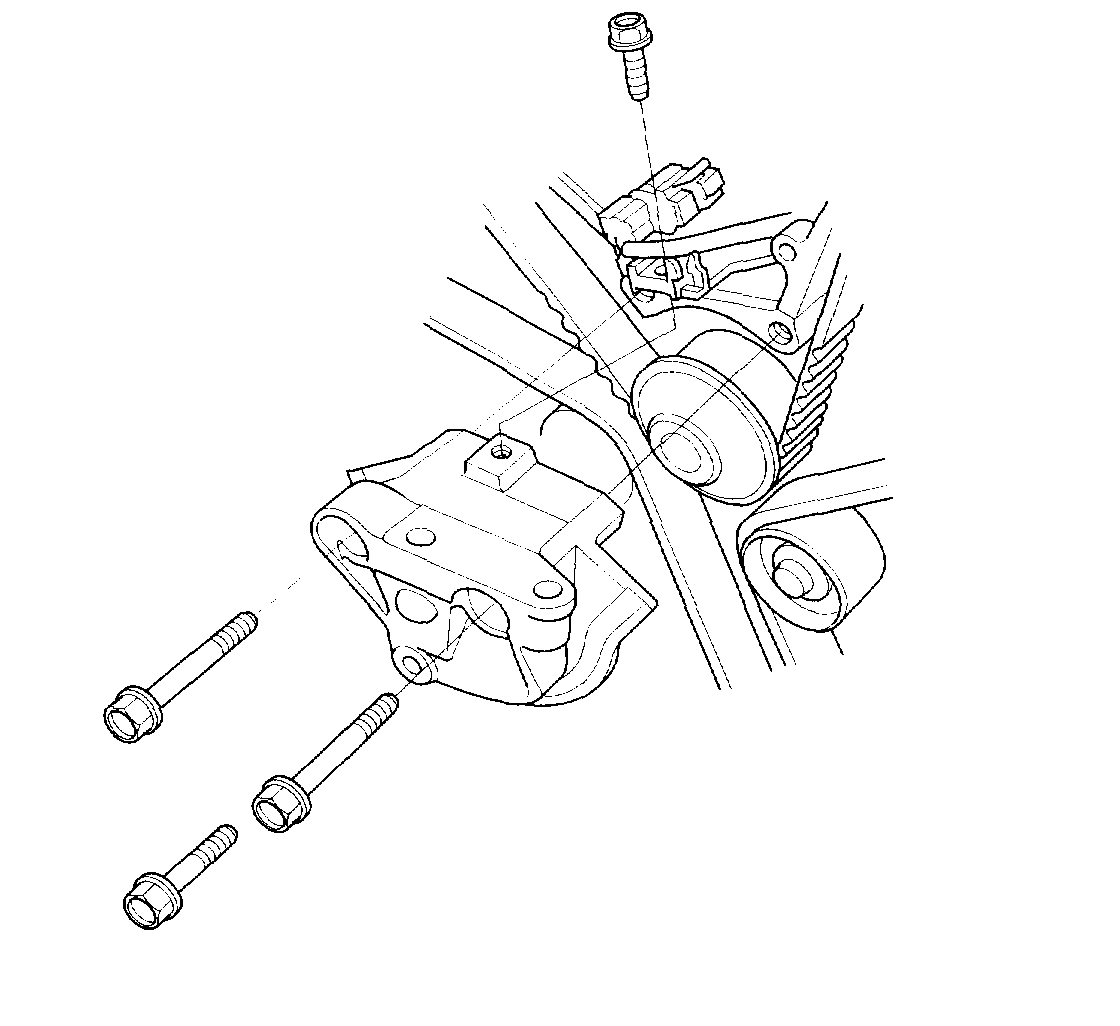

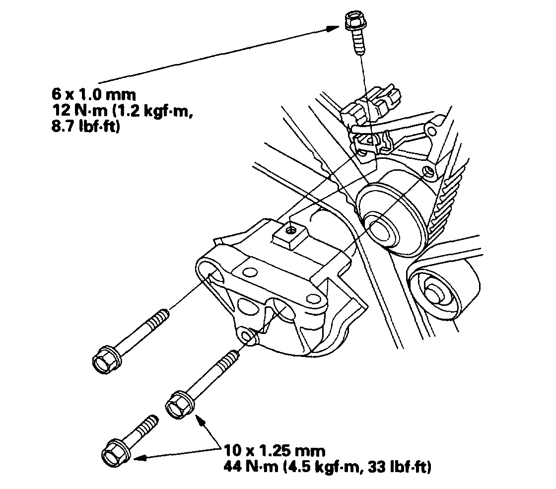

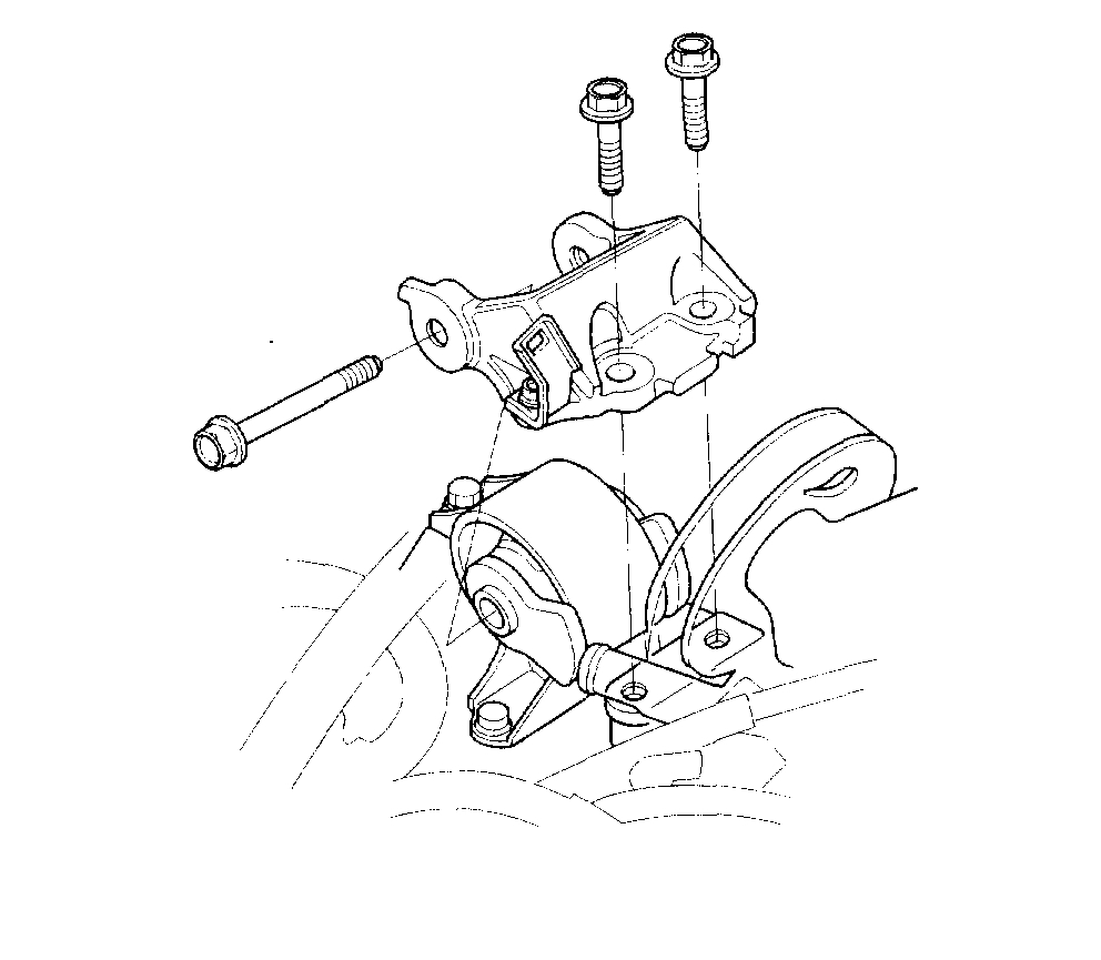

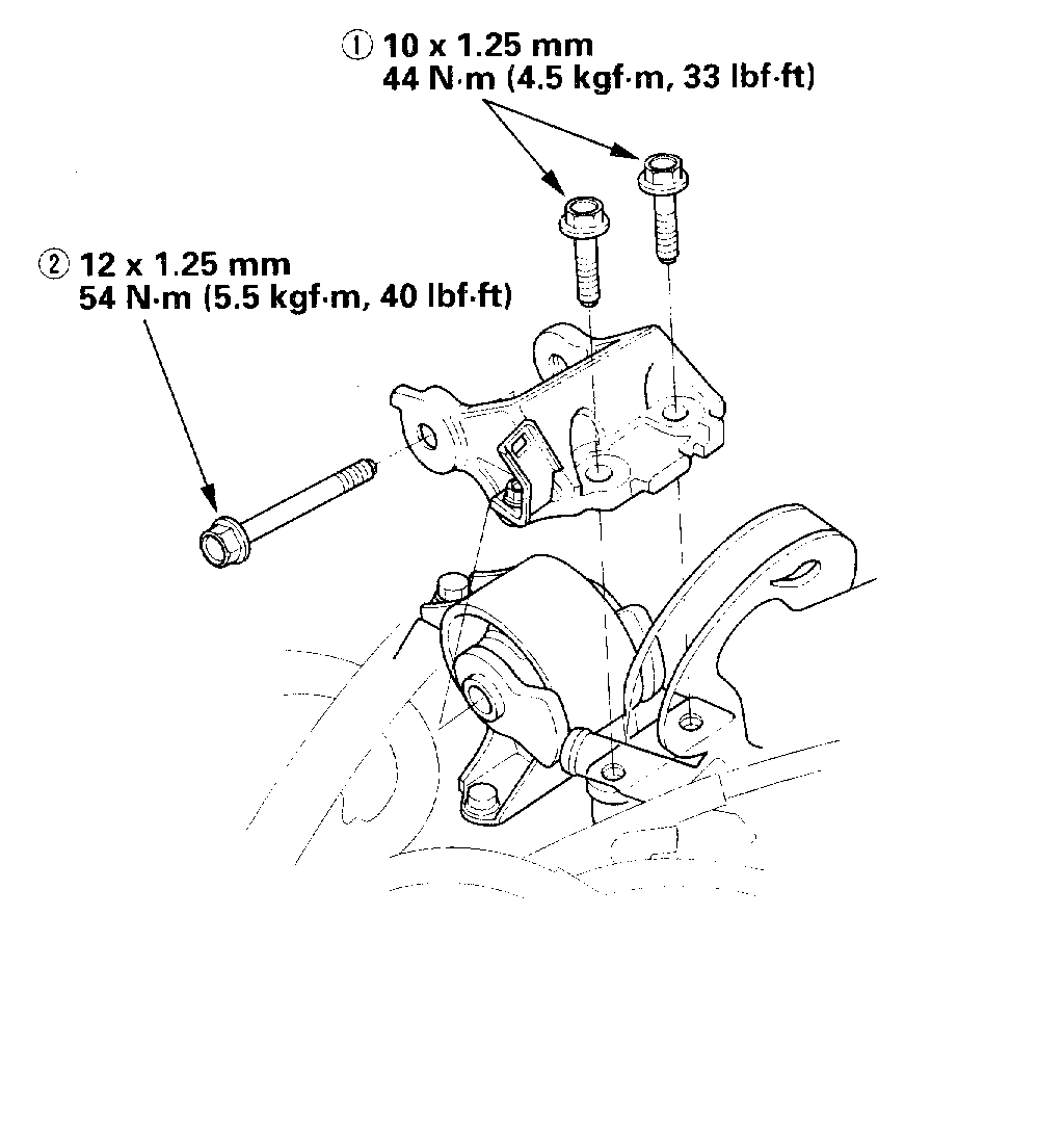

8. Remove the side engine mount bracket.

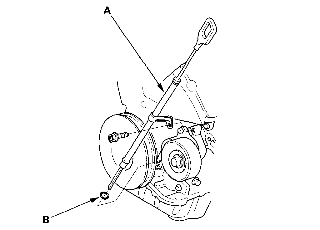

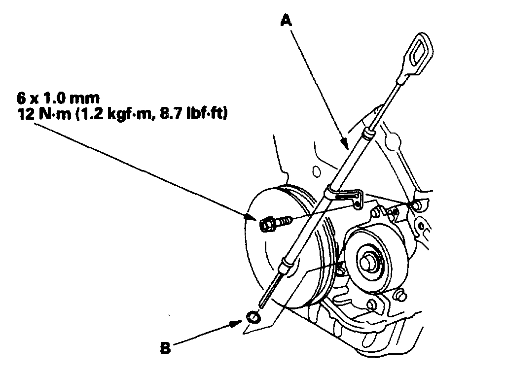

9. Remove the dipstick and tube (A); discard the O-ring (B).

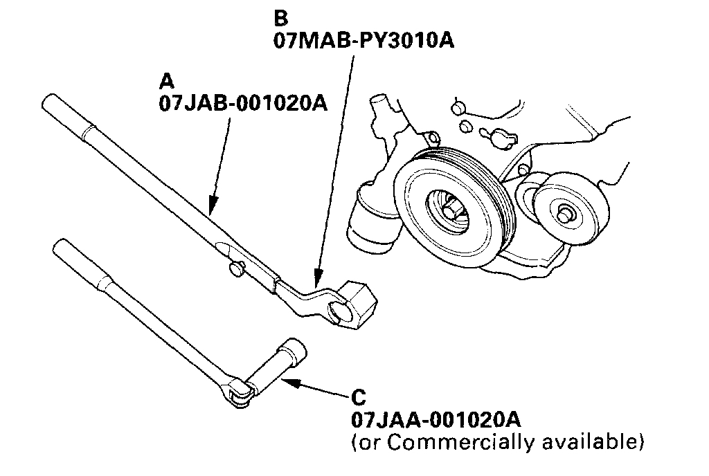

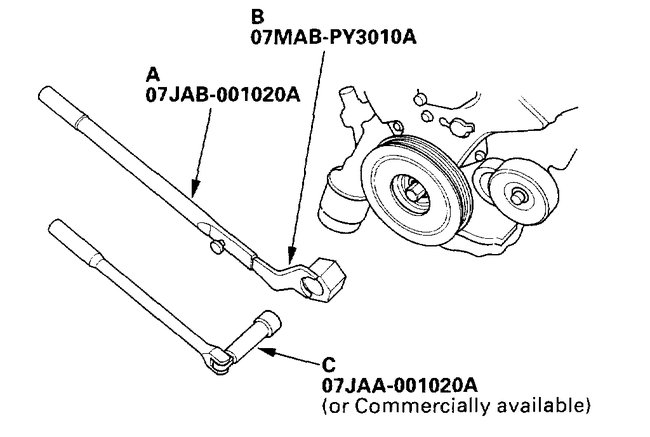

10. Hold the pulley with the holder handle (A) and holder attachment (B).
11. Remove the bolt with a heavy duty 19 mm socket (C) and breaker bar.

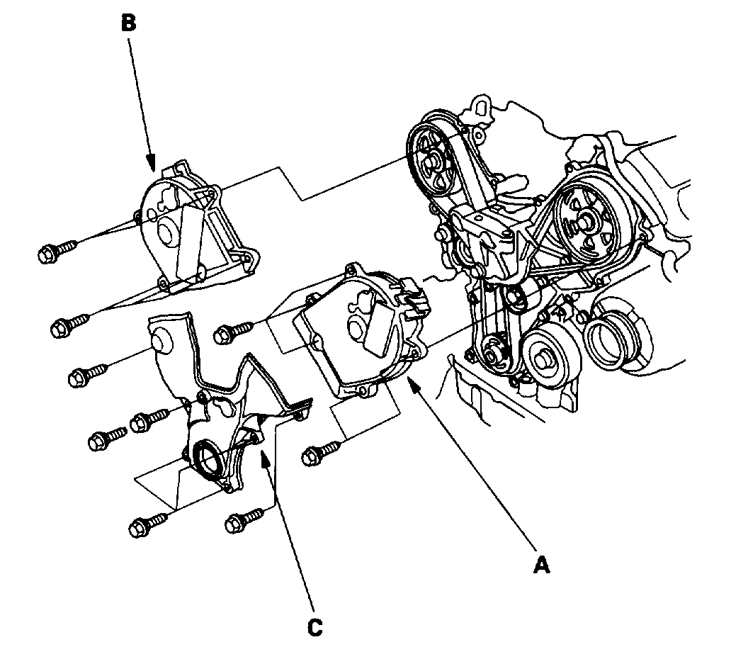

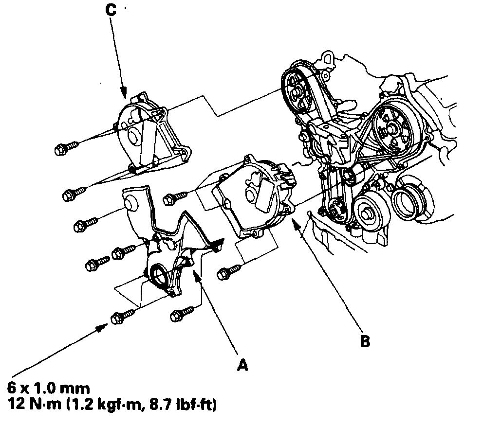

12. Remove the front upper cover (A), rear upper cover (B), and lower cover (C).

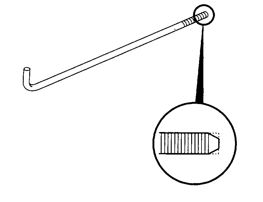

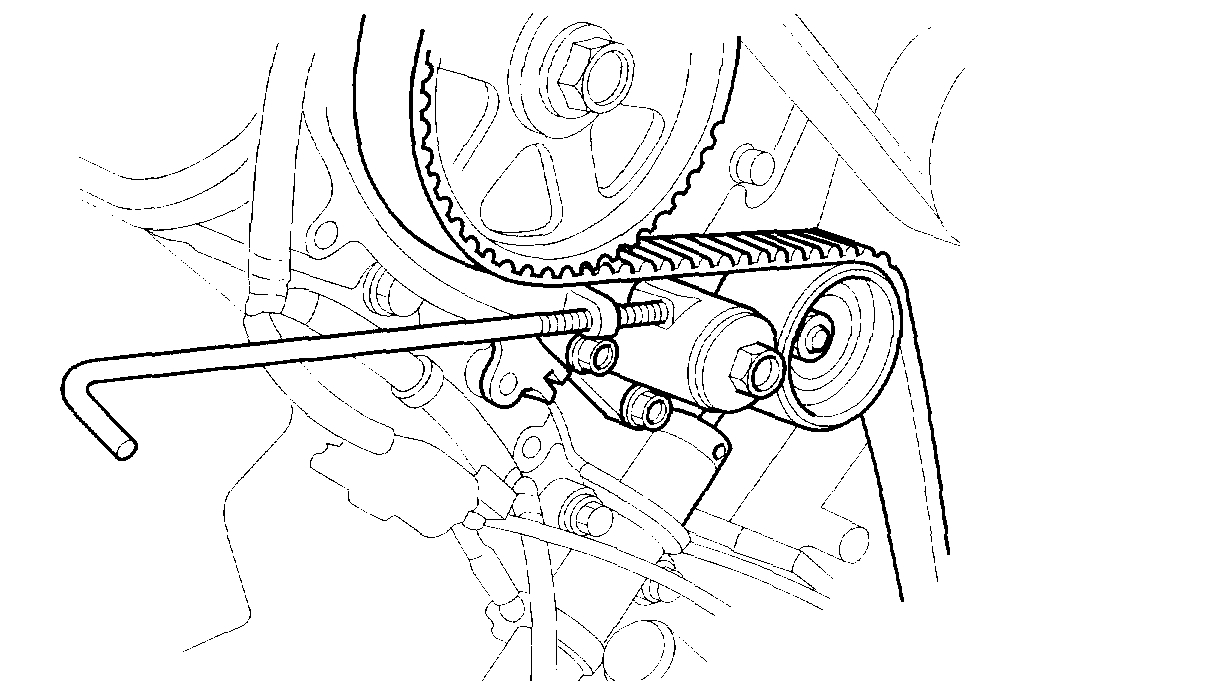

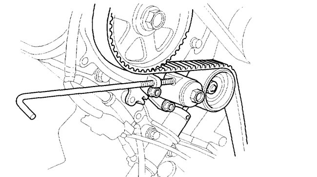

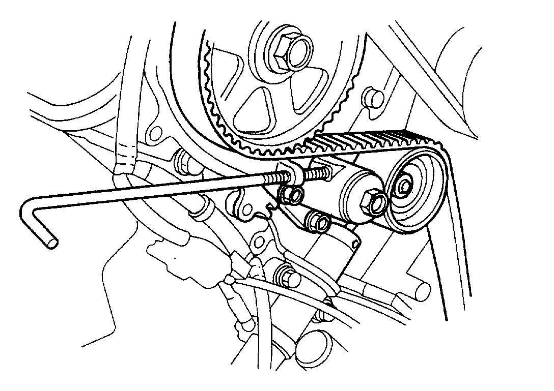

13. Remove one of the battery clamp bolts from the battery tray, and grind the end of it.
14. Screw the battery clamp bolt in to hold the timing belt adjuster in its current position. Tighten it by hand, do not use a wrench.

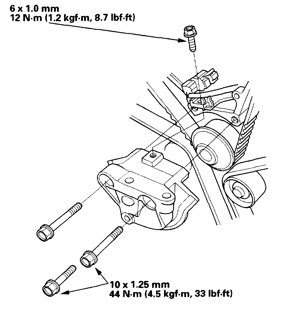

15. Remove the engine mount bracket.

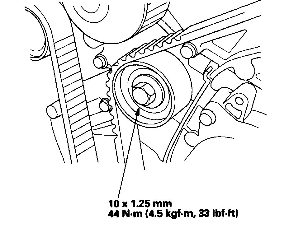

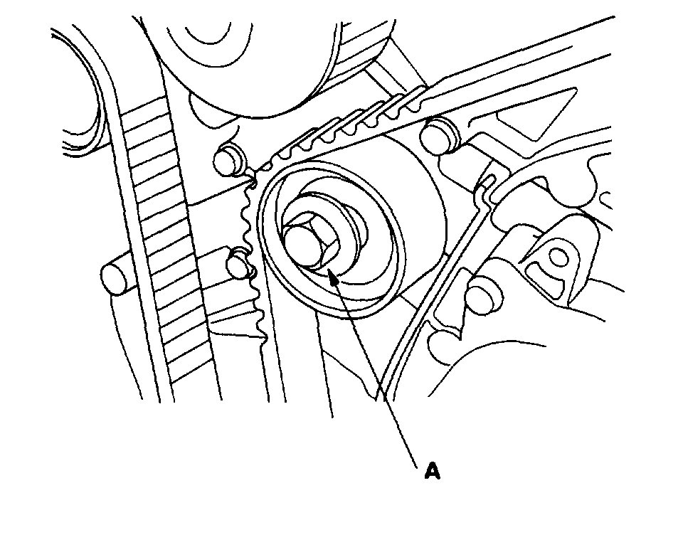

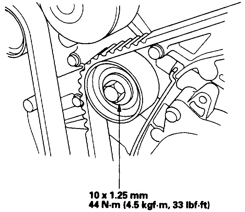

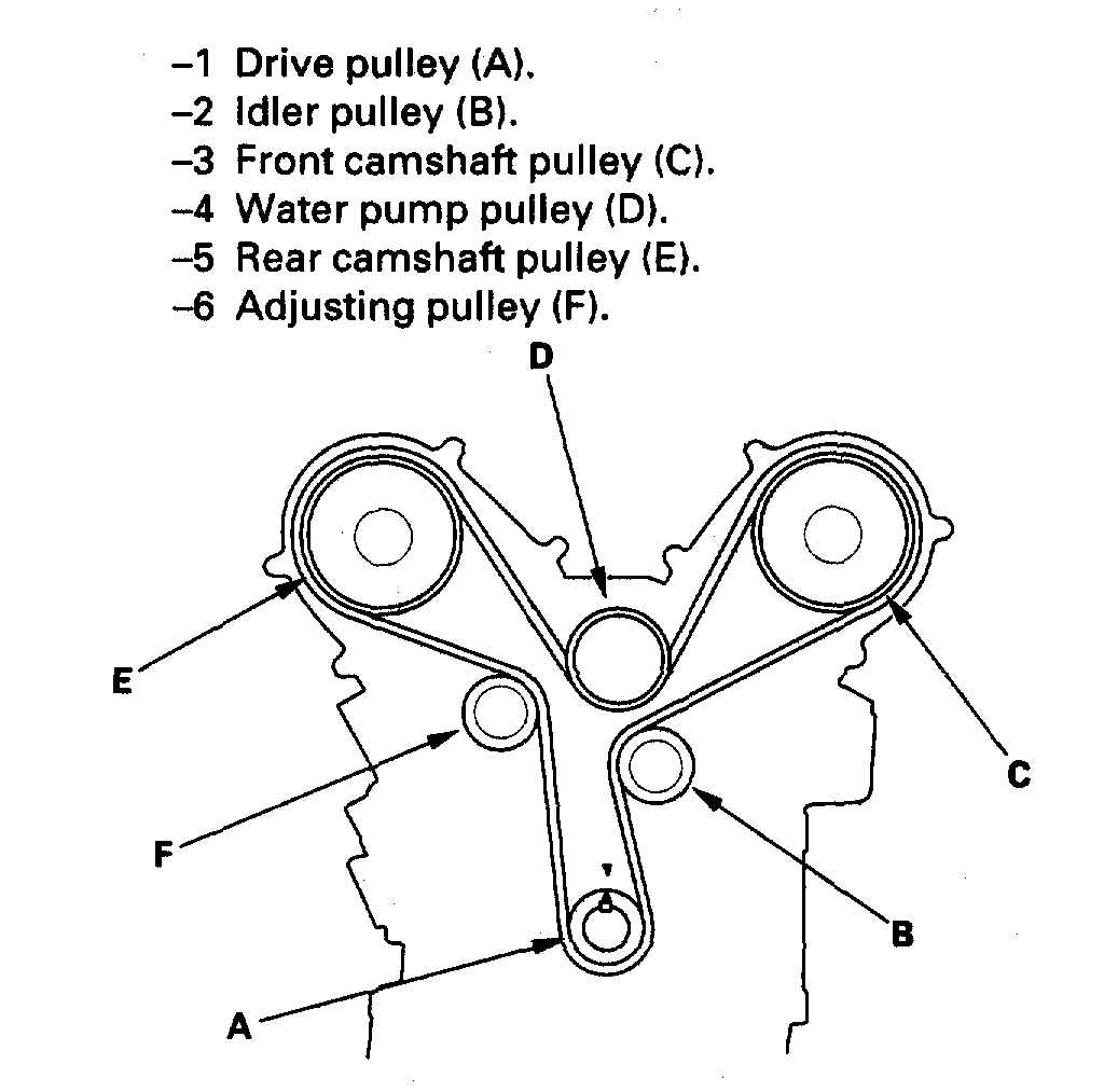

16. Loosen the idler pulley bolt (A) about five or six turns, then remove the timing belt.

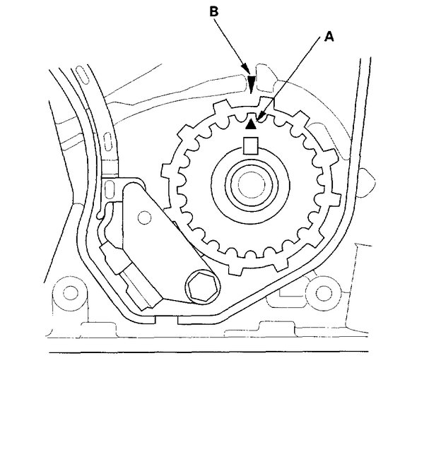

2. Set the timing belt drive pulley to TDC by aligning the TDC mark (A) on the tooth of the timing belt drive pulley with the pointer (B) on the oil pump.

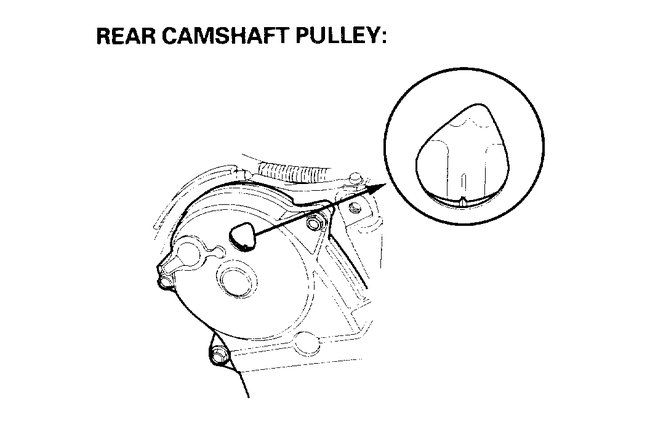

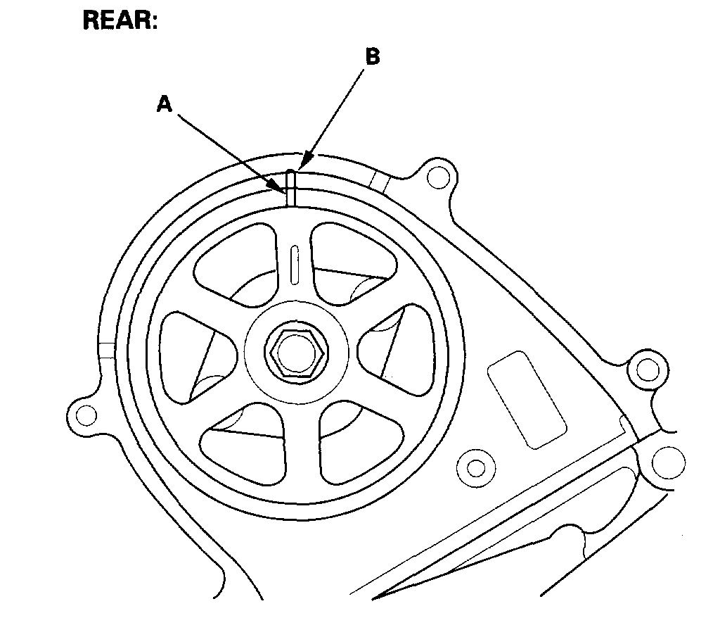

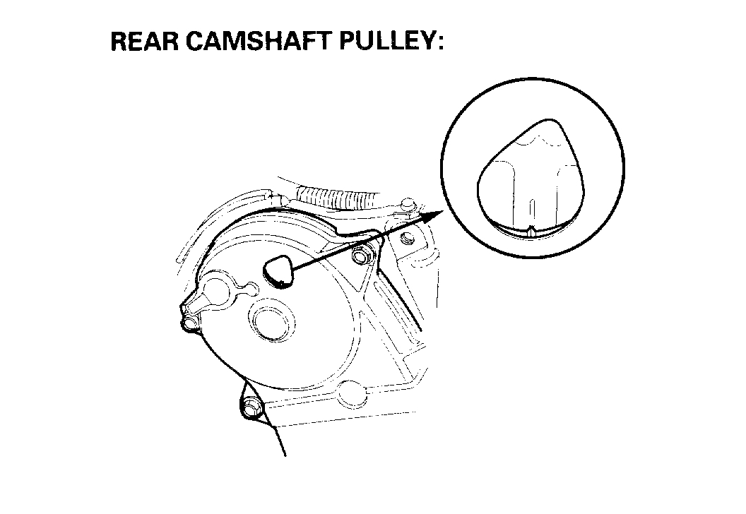

3. Set the camshaft pulleys to TDC by aligning the TDC marks (A) on the camshaft pulleys with the pointers (B) on the back covers.
4. Remove the battery clamp bolt from the back cover.

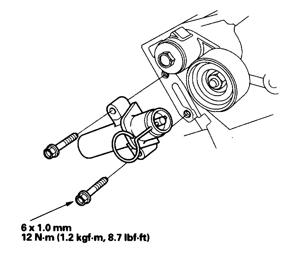

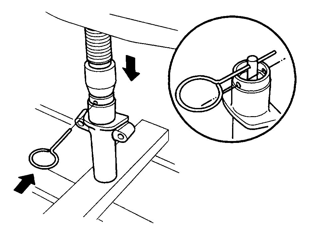

5. Remove the auto-tensioner.

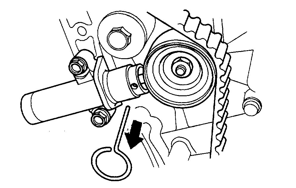

6. Align the holes on the rod and housing of the auto-tensioner.
7. Use a hydraulic press to slowly compress the auto tensioner. Insert a 2.0 mm (0.08 inch) pin through the housing and the rod.
NOTE: The compression pressure should not exceed 9,800 N (1,000 kgf, 2,200 lbs).
8. Install the auto-tensioner.
NOTE: Make sure the pin stays in place.
9. Install the timing belt in a counterclockwise sequence starting with the drive pulley.
10. Tighten the idler pulley bolt.
11. Remove the pin from the auto-tensioner.
12. Install the engine mount bracket.

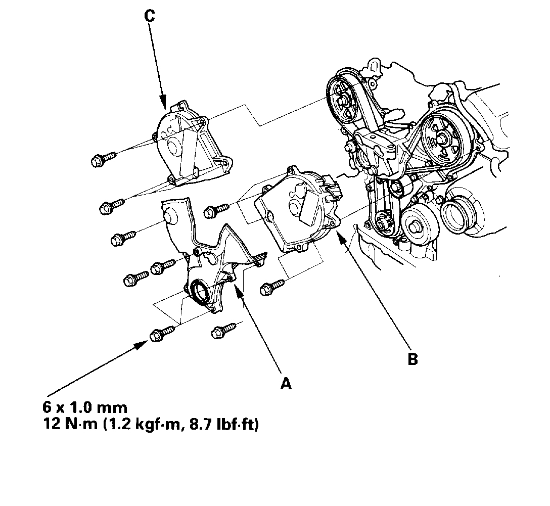

13. Install the lower cover (A), front upper cover (B), and rear upper cover (C).

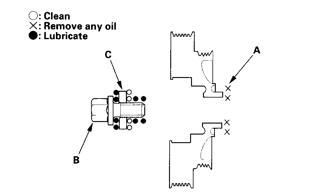

14. Clean all oil off the inside face (A) of the crankshaft pulley, and apply lubricant to the pulley bolt (B) and washer (C).
15. Install the crankshaft pulley, and tighten the bolt to 245 Nm (25.0 kgf/cm, 181 ft. lbs.). Do not use an impact wrench.
-1 Hold the pulley with the holder handle (A) and holder attachment (B).
-2 Tighten the bolt with a torque wrench and 19 mm socket (C).

17. Turn the crankshaft pulley so its white mark (A) lines up with the pointer (B).
18. Check the camshaft pulley marks.
- If the camshaft pulley marks are at TDC, go to step 19.
- If the camshaft pulley marks are not at TDC, remove the timing belt and repeat steps 2 through 15.
19. Install the dipstick and tube (A) with a new O-ring (B).

22. Install the side engine mount bracket, then tighten the mounting bolts in the numbered sequence.

6. Tighten the idler pulley bolt.

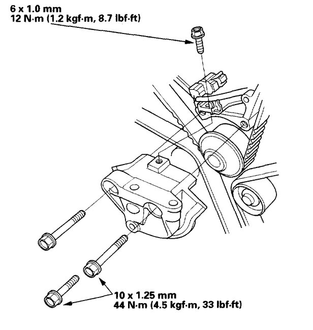

8. Install the engine mount bracket.
9. Install the lower cover (A), front upper cover (B), and rear upper cover (C).
10. Clean any oil off the inside face (A) of the crankshaft pulley, and apply lubricant to the pulley bolt (B) and washer (C).
11. Install the crankshaft pulley, and tighten the bolt to 245 Nm (25.0 kgf/cm, 181 ft. lbs.). Do not use an impact wrench.

13. Turn the crankshaft pulley so its white mark (A) lines up with the pointer (B).
14. Check the camshaft pulley marks.
- If the camshaft pulley marks are at TDC, go to step 15.
- If the camshaft pulley marks are not at TDC, remove the timing belt and repeat steps 2 through 11.

18. Install the side engine mount bracket, then tighten the mounting bolts in the numbered sequence.
