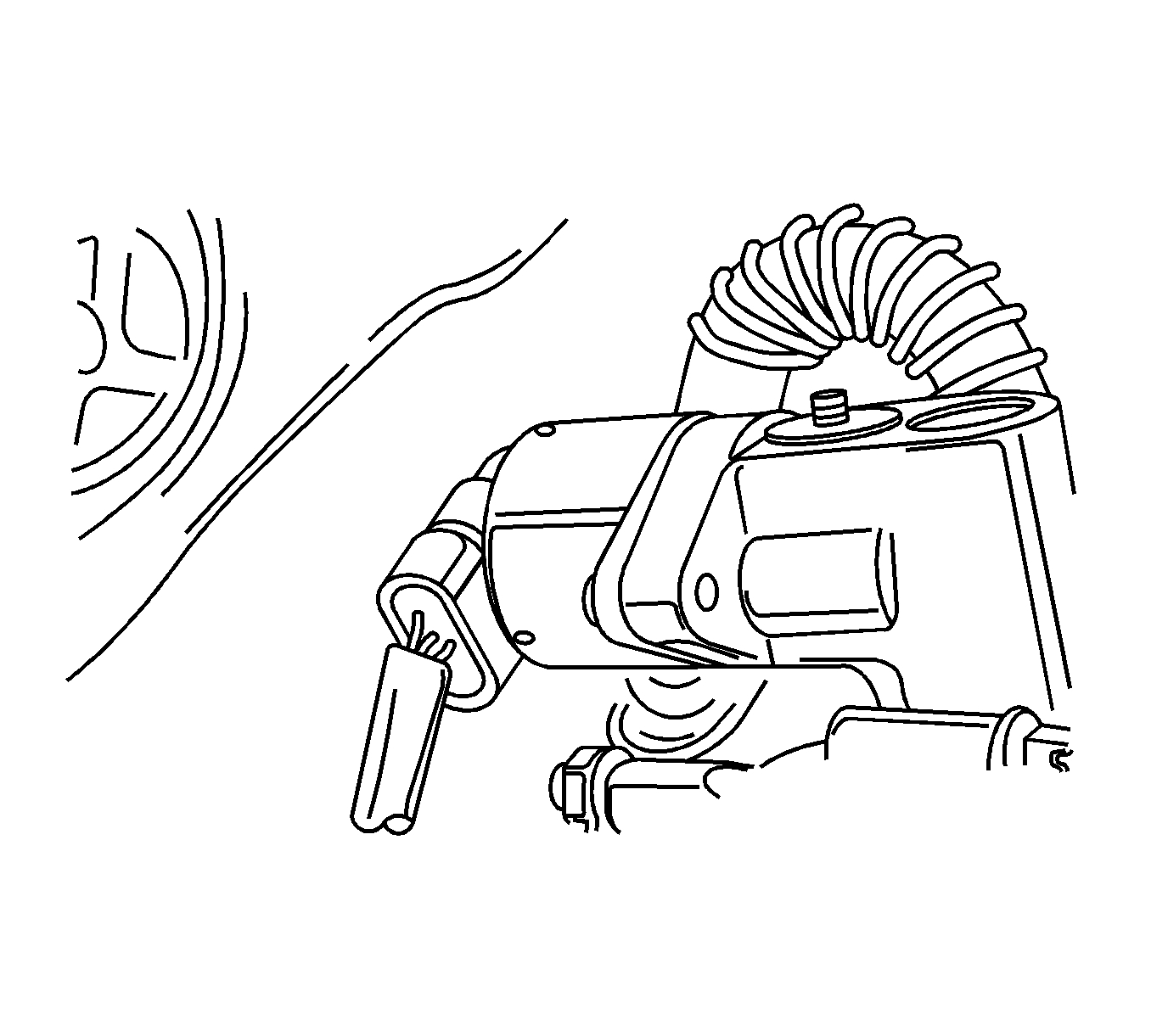

Removal Procedure
See picture 1
Warning: Refer to Battery Disconnect Warning (See: Battery > Technician Safety Information > Battery Disconnect Warning).
1. Disconnect the negative battery cable.
2. Disconnect the idle air control (IAC) valve connector.
3. Remove the IAC valve retaining bolts.

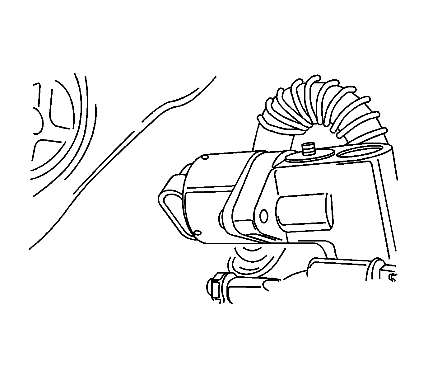

4. Remove the IAC valve.
5. Clean the IAC valve O-ring seal area, the pintle valve seat, and the air passage with a suitable fuel system cleaner. Do not use methyl ethyl ketone.
See picture 2
Note: If installing a new IAC valve, be sure to replace it with an identical part. The IAC valve pintle shape and diameter are designed for the specific application. Measure the distance between the tip of the IAC valve pintle and the mounting flange. If the distance is greater than 28 mm (1.1 in), use finger pressure to slowly retract the pintle.
The force required to retract the pintle will not damage the IAC valve. The purpose of the 28 mm (1.1 in) setting is to prevent the IAC pintle from bottoming out on the pintle seat. This 28 mm (1.1 in) setting is also an adequate setting for controlled idle on a restart.

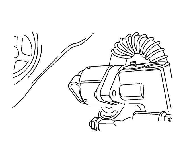

Caution: Refer to Fastener Caution (See: Vehicle > Vehicle Damage Warnings > Fastener Caution).
3. Install the IAC valve retaining bolts.
Tighten the idle air control valve retaining bolts to 3 Nm (27 lb in).
4. Connect the IAC valve connector.
5. Connect the negative battery cable.
6. Perform the idle learn procedure. Refer to Throttle/Idle Learn (See: Throttle Body > Procedures > Throttle Learn).
