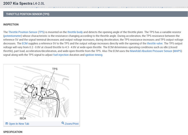

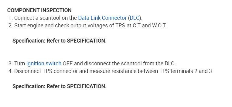

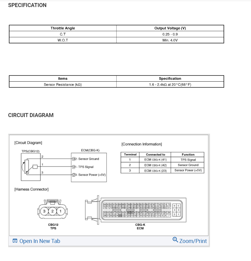

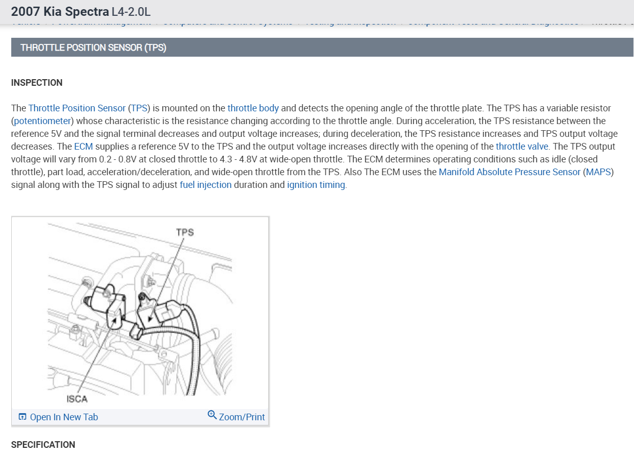

It could just need to relearn which can be done by just driving it. Here is some information on the TPS sensor in the images below. Please let us know what happens.
