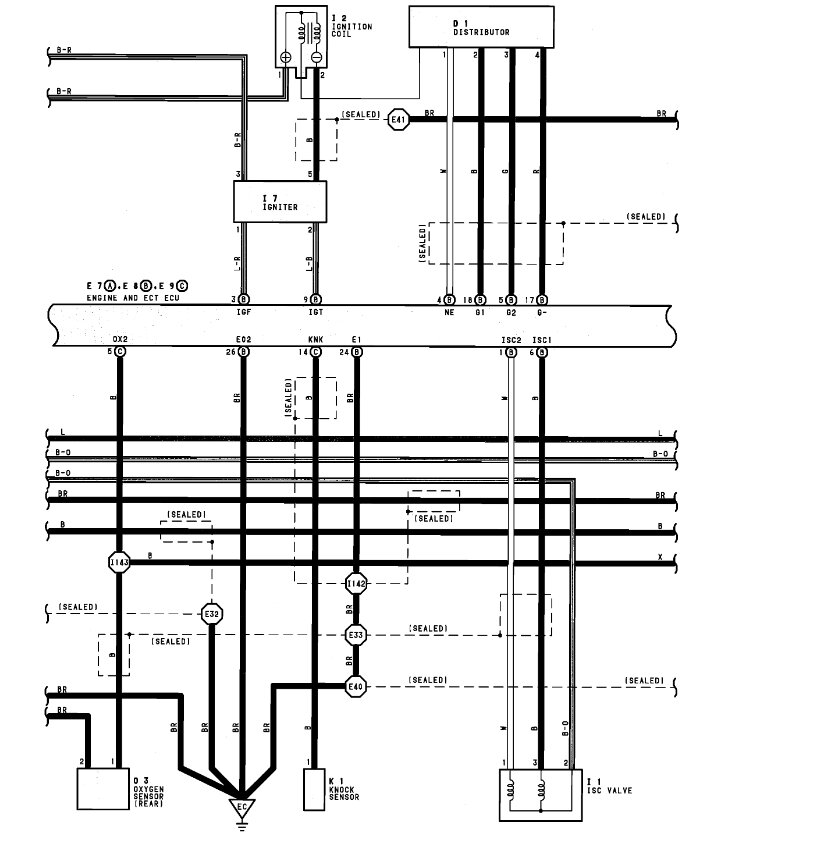

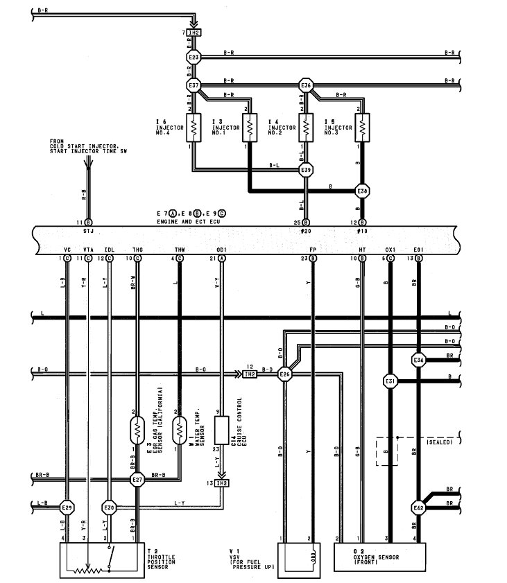

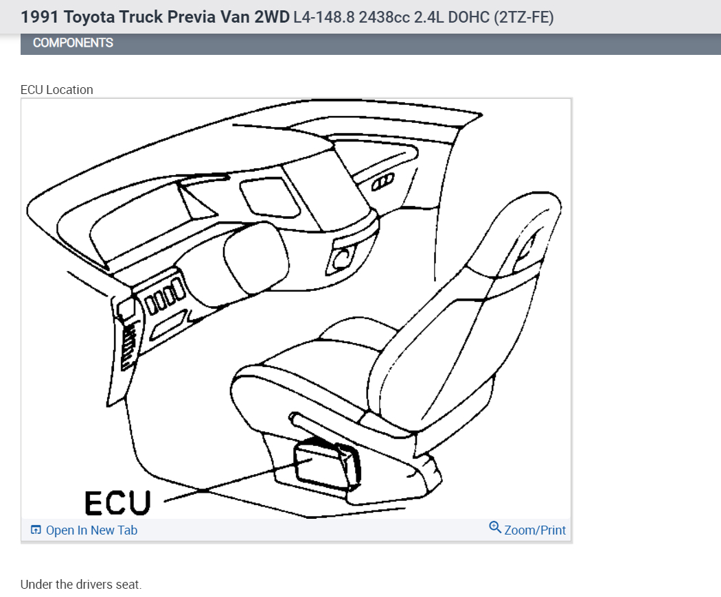

Sorry, they do not show us the engine wiring diagrams for 1991. It sounds like the voltage driver inside the ECU has gone bad or you have corrosion on the connector of the ECU. You may want to try to disconnect the coils and injectors in case one is shorted which can cause the ECU operational voltage to drop as well. Located under the driver's seat these can get wet and cause issues like this one. Check out the images (below). Please let us know what you find. We are interested to see what it is.

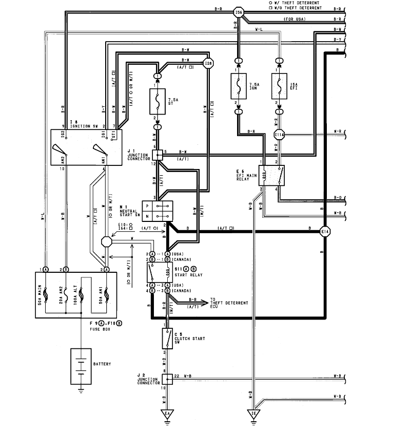

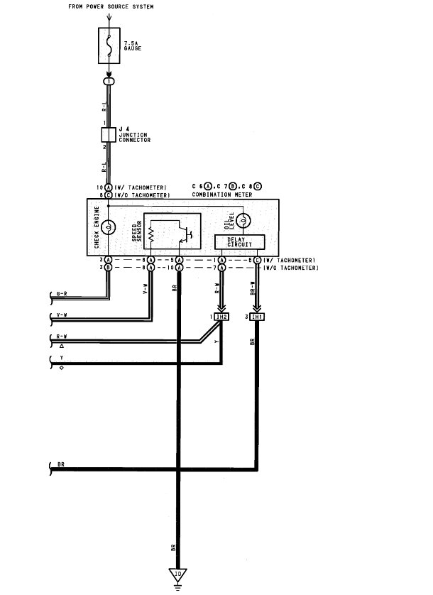

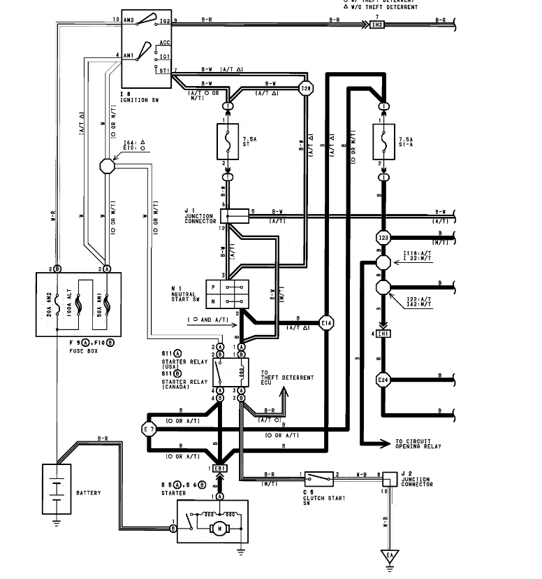

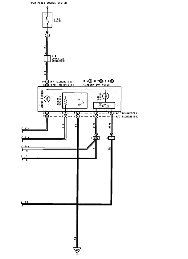

Nov 20, 2022 at 11:13 PM

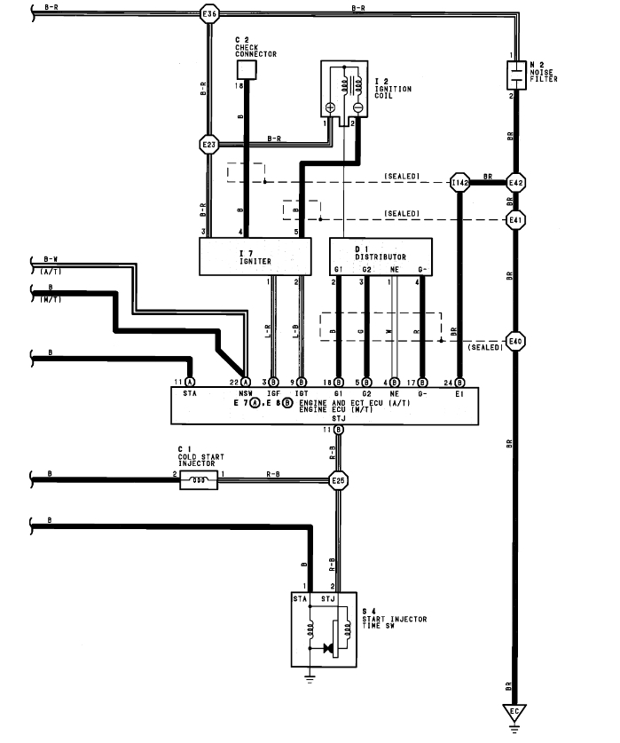

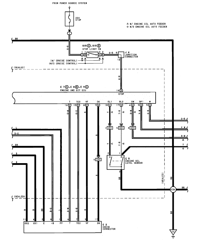

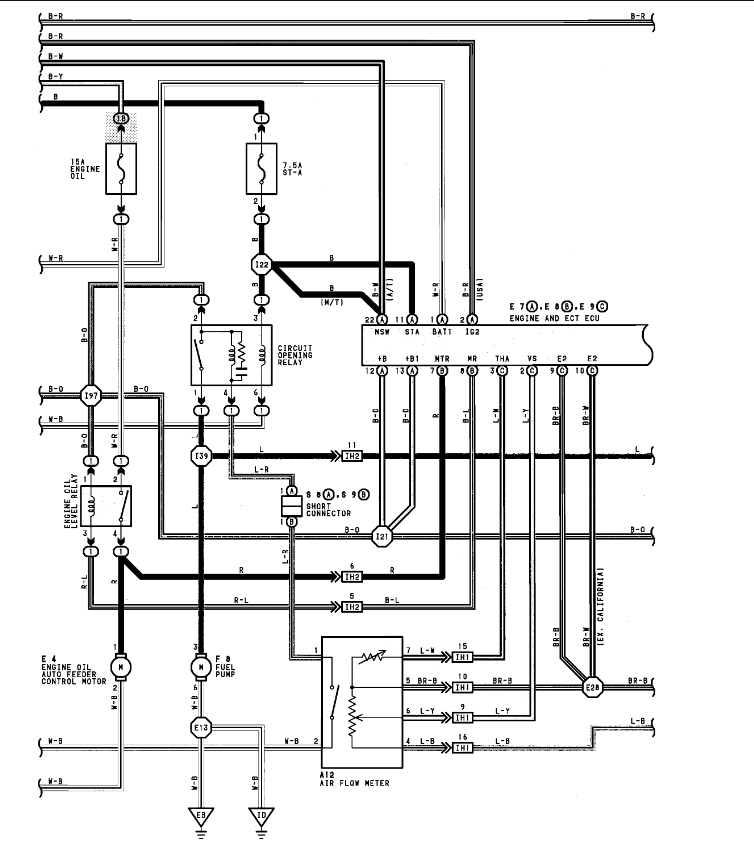

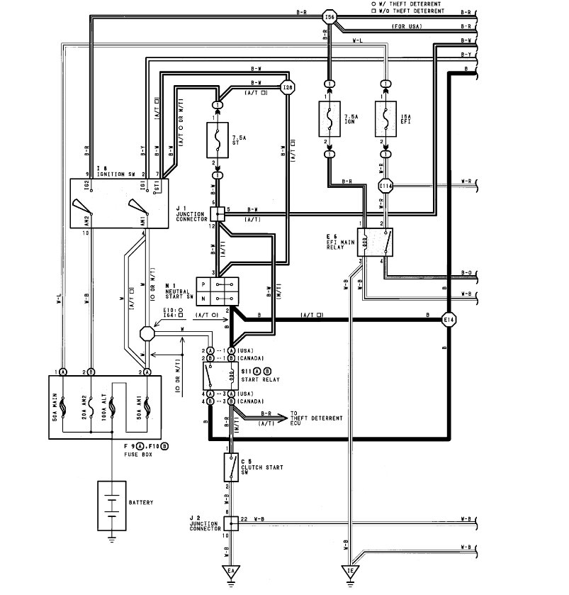

Yep, that could be, I found the engine and ECU wiring diagrams which show the grounds.
here is a guide to help you check it out and the diagrams in the images below:
