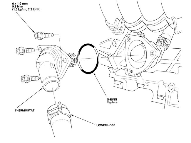

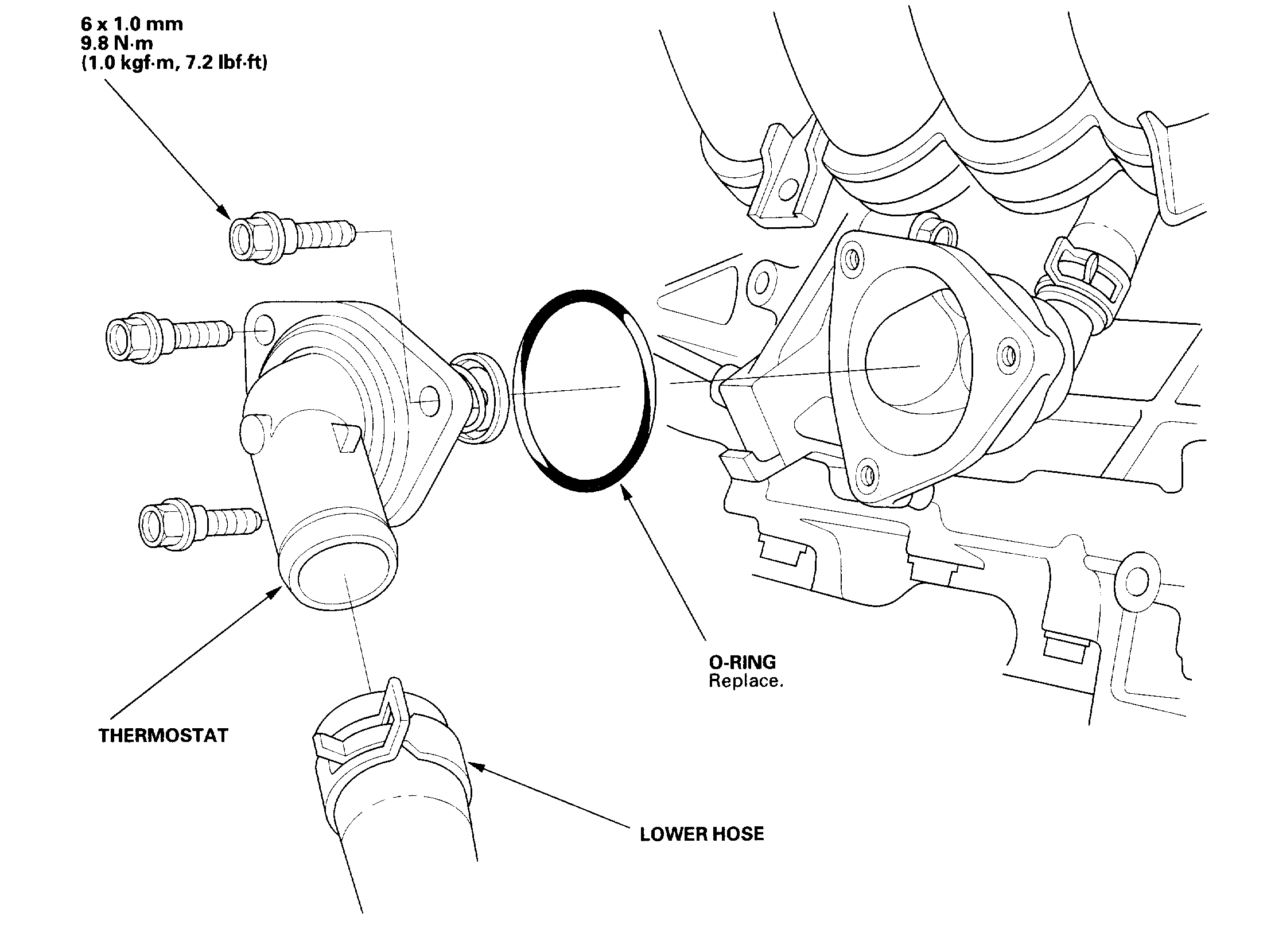

Here are the directions specific to your vehicle. The attached pic correlates with the directions.
2003 Honda Truck CR-V 4WD L4-2.4L
Procedures
Vehicle Engine, Cooling and Exhaust Cooling System Thermostat Service and Repair Procedures
PROCEDURES
Pic 1
Thermostat Replacement
1. Drain the engine coolant.
2. Remove the splash shield (see step 22).
3. Remove the lower hose, then remove the thermostat.
4. Install the thermostat with a new O-ring, then install the lower hose.
5. Install the splash shield (see step 23).
6. Refill the radiator with engine coolant, and bleed air from cooling system with the heater valve open.
