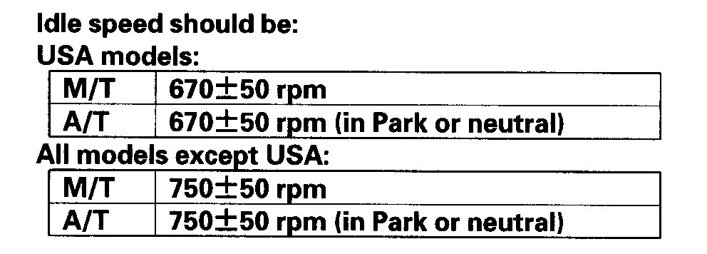

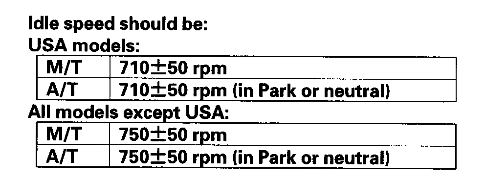

First, here are directions from alldata discussing checking the idle speed. Follow these directions to see if the vehicle fails.
Idle Speed Inspection
NOTE:
- Before checking the idle speed, check these items:
- The malfunction indicator lamp (MIL) has not been reported on, and there are no DTCs.
- Ignition timing
- Spark plugs
- Air cleaner
- PCV system
- Apply the parking brake, and make sure the headlights are off.
1. Disconnect the evaporative emission (EVAP) canister purge valve connector.

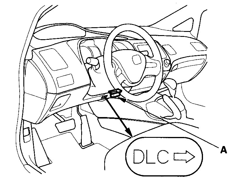

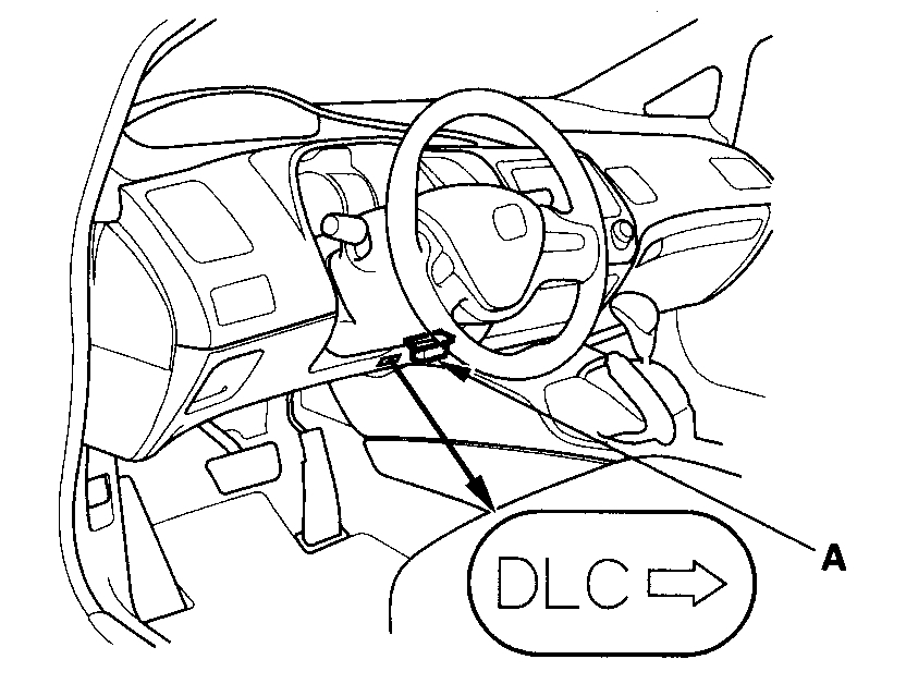

2. Connect the HDS to the data link connector (DLC) (A) located under the driver's side of the dashboard.
3. Make sure the HDS communicates with the ECM/PCM and other vehicle systems. If it doesn't, go to the DLC circuit troubleshooting. See: Data Link Connector > Component Tests and General Diagnostics > DLC Circuit Troubleshooting
4. Start the engine. Hold the engine speed at 3,000 rpm without load (in Park or neutral) until the radiator fan comes on, then let it idle.
5. Check the idle speed without load conditions: headlights, blower fan, radiator fan, and air conditioner off.
6. let the engine idle for 1 minute with high electric load (A/C switch on, temperature set to max cool, blower fan on high, and headlights on high beam).
NOTE: If the idle speed is not within specification, do the ECM/PCM idle learn procedure. If the idle speed is still not within specification, go to symptom troubleshooting. See: Computers and Control Systems > Symptom Related Diagnostic Procedures
7. Reconnect the EVAP canister purge valve connector.
The first three pictures correlate with these directions.
