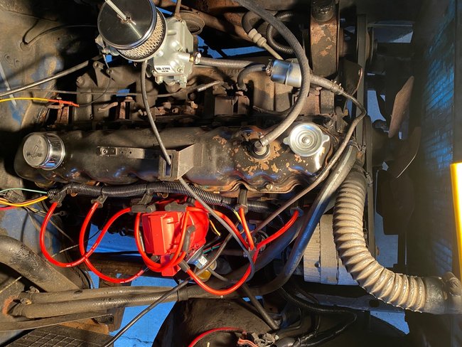

I have an 258 inline 6. It had shut off on me while driving but would start back up. I replaced the plugs and fuel pump. Also replaced the carburetor and had timing belt checked. It had jumped one tooth.
Now, it runs fine when it is first cranked. Once the engine reaches 170 degrees, the exhaust tone changes and the engine slows. If the engine is revved, it seems to behave normally. Once it cools down, it is fine again. I have replaced the coil and ignition control module thinking that the coil was failing once it got hot. Any ideas why it changes at this temperature?
Thanks,
Tony

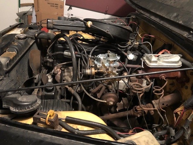

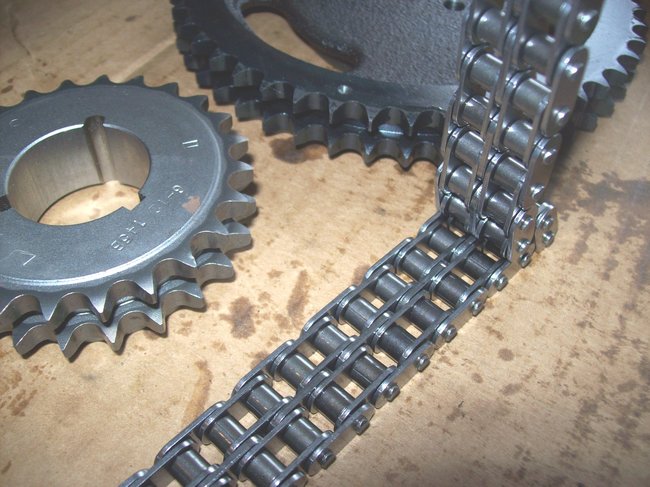

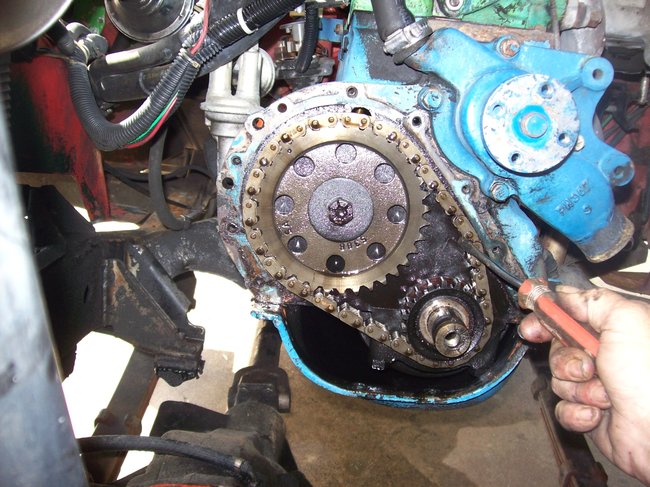

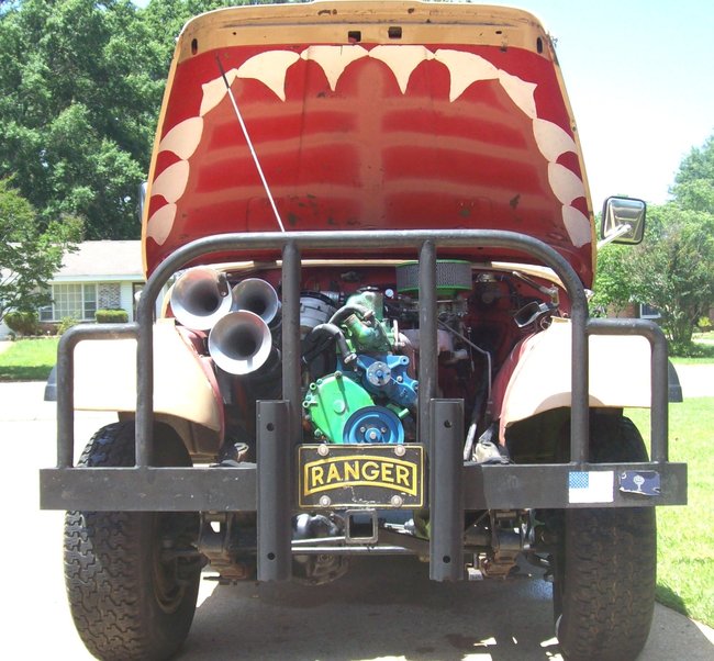

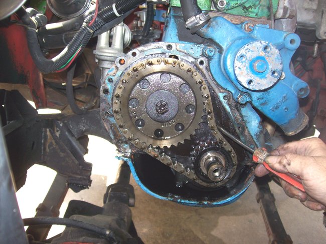

Two pictures below, my 1977 CJ-5 with a 258 6 cylinder. My Jeep is a daily driver. I rebuilt the engine just before Summer of 1996. (So it was about 21 years that passed when I noticed the chain starting to slap the cover)
Notice how much 'slop' was in the chain and it never jumped timing.
I replaced it (and the gears) with a "Cloyes" double roller timing set, a bit more expensive but with a super reputation. That's been a few years ago, my engine still seems brand new!

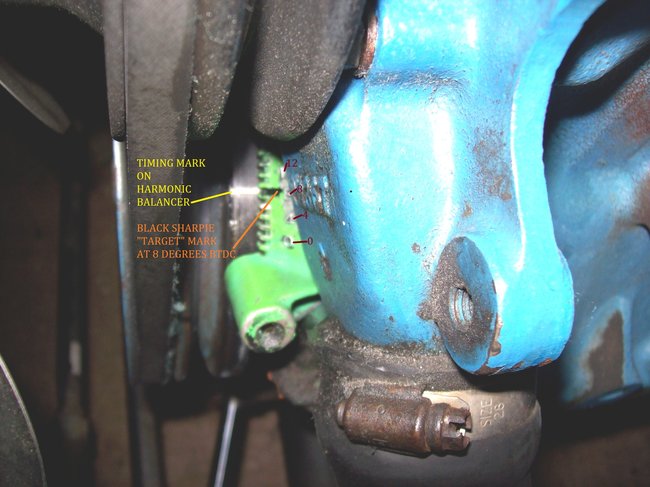

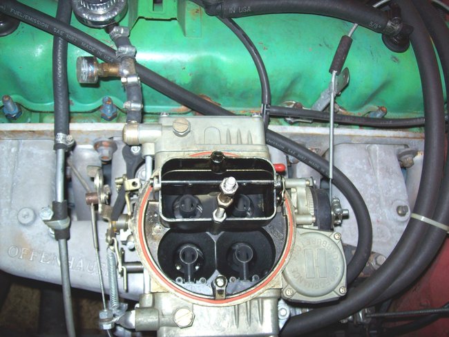

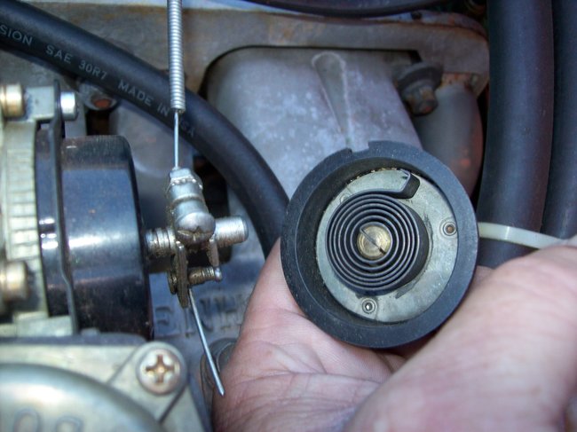

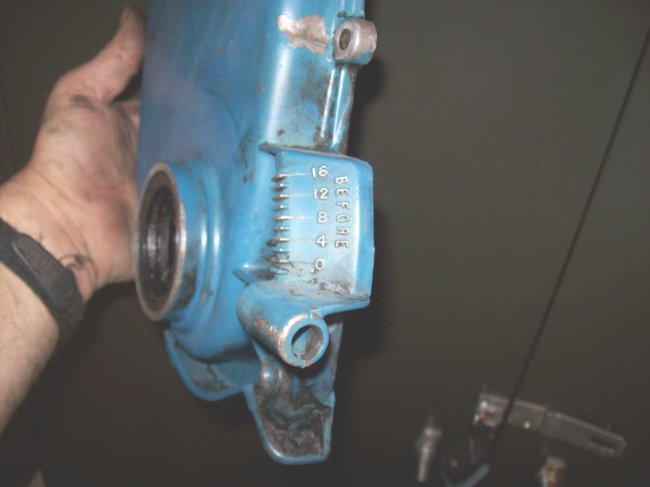

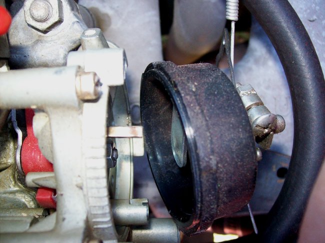

My CJs timing is 8 Degrees BTDC, Below is a pic of how "mine" looks every time the timing light flashes.
Picture 2 is a timing cover removed showing the timing data in full view not covered by the water pump.

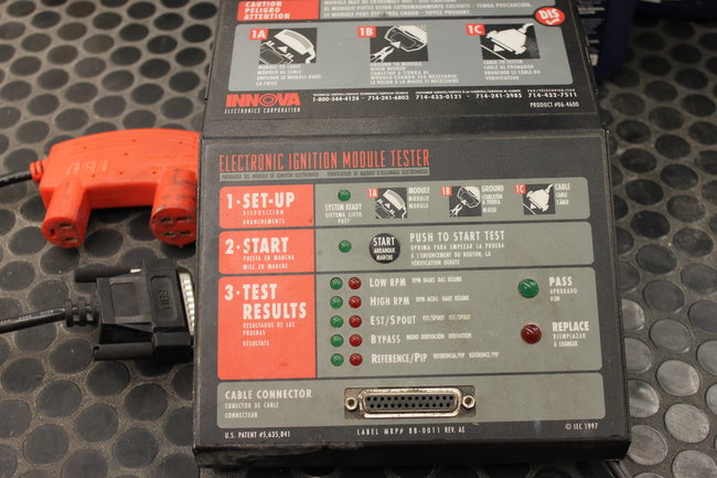

Any parts store might test your ignition module if they do not consider it "obsolete" now days.
I'm partial to "Advance Auto Parts", they are local to me and have never intentionally done me wrong.
Below is pics of their machine, have them test yours 4-8 times, should it fail once, replace that puppy.
Replaced it?
Test the new one the same way before you leave the store. Been there, done that! You may pizz them off with the request. But there is nothing like your Jeep not running and you are tearing your hair out (and tearing the Jeep apart too) all because you are trusting a "new","bad" ignition module you just installed!

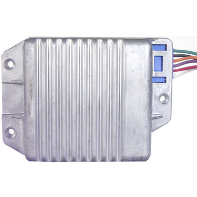

According to the AMC service manual and my experiences, To disconnect the module, grab the wires on either side of the connectors and pull hard. Prying and digging at the connectors with a screwdriver will only result in breaking off the locking tabs, then it will not stay connected when re-installed.
Your module will have "blue" plastic around where the wires exit the unit. This might be viewed at the end, or from the other side. (other colors were used by Motorcraft for totally different vehicle applications).
The module can cause backfires, as the ignition is being turned off and back on sometimes when they glitch.
Remember, Mr. Module must be anchored down well, it gets its ground that way. Dangling about is not going to cut it!
Notice the test machine tests the module at different RPMs (read the machine's label).

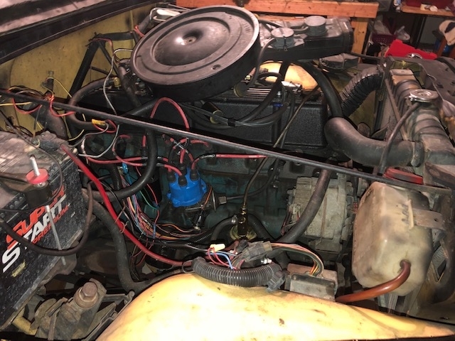

One more idea for now, easy to perform. I went back to another post I answered to a '83 CJ7
Any noticing of hitting bumps, left or right turns, accelerating, decelerating, etc, when he quits running?
This works at times, while you have him sitting static and idling.
Shake/move wires or harnesses around "normally" and while recreating "G forces" in a turn or up and down bumps in the road. See if he cut's off or even skips a little. Wiggle the wires to everything.
Try not to relocate anything until you locate the issue causing it to die (this may not find it at all, but it can and does work if you have a wire issue).
Violent, jerking and over the top flopping the wires about (overdoing it!) may move the problem out of the way for now, but then it might reappear in the future, just when you don't need it to! It's best to find it now if you can, so be gentle with the shaking and wiggling process.

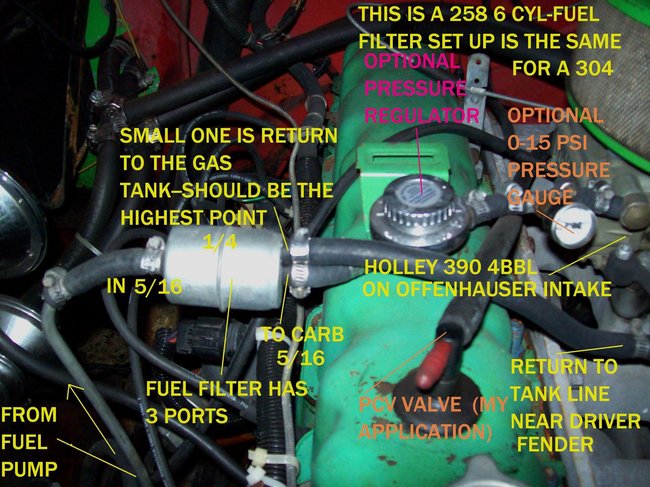

On a previous Jeep I owned, a wire harness ran on top of several flexible hangers (if you will) under the valve cover bolts. The harness ran lengthwise over the top of the exhaust manifold. It took me a while as I never imagined that it could bounce down and kill my ignition. Cranking would bounce it up and slightly away from the manifold and it would be alive again, till I hit another bump just right.

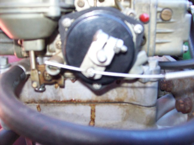

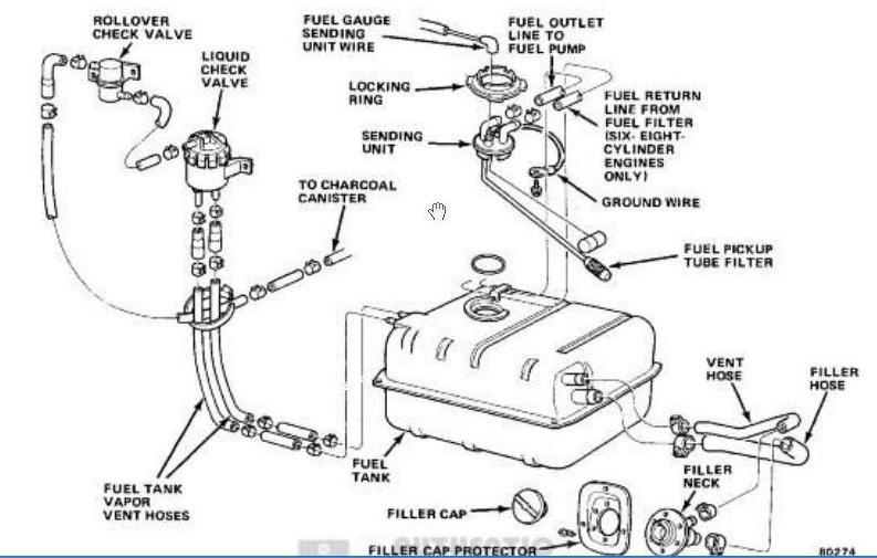

Pic 3 was not intended, forget the text on it! I could not edit it back off of here!

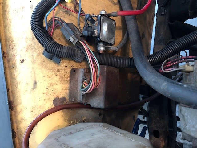

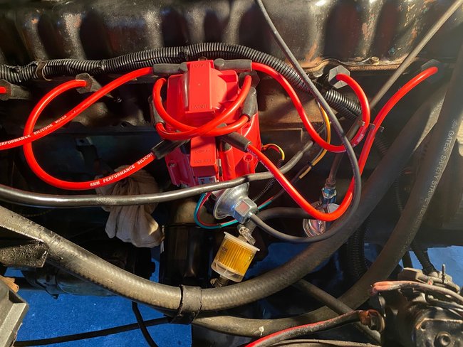

So new development/finding. Took test drive before pulling new ICM out. mile or so from home, go to accelerate in third gear, no acceleration. Give it more throttle, no revs. Putt up to stop sign, first and second gear good, third, little sputter, shuts off, little backfire. Pull over cranks back up. Did this about four times going back home. Luckily coming down my street it shuts off but I had enough momentum to roll into the garage. Popped top of carburetor. Bowl is dry. Messed around with it. Seems to have a strong flow when the float is pushed down. So now seems to look like a fuel issue.
Was not bump related.
What is this metal box by the solenoid? Can't find it in my manual.

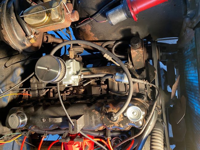

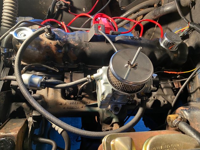

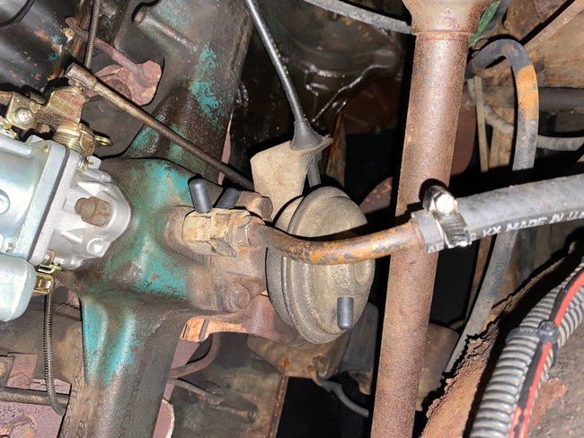

I am having very similar issues. 1978 CJ7 232. Idles fine and runs fairly well until about 10-15 minutes of running time. Once it gets to temperature, about 190 according to gauge, it will still idle fine, accelerates through 1st gear fine, go into top end of 2nd then begins wanting to die. It happens very much so in 3rd gear. Motor begins to die, accelerating further does not help, let off accelerator and it may come back to life or may not. Usually, it begins by bucking pretty bad and have to let off accelerator. Typically have to let the motor go back to an idle speed, "catch up" and downshift to 2nd or 1st gear to continue running with little acceleration pressed. Typically, it will idle forever sitting at the house. If I fast idle say around 2000-2500 rpms it will run for several seconds, then begins to shut off.
Purchased the vehicle in 11/2021. Had water in the fuel when purchased and was not running. Pumped the water and old fuel out of the tank. Have since replaced carburetor (National Carburetor ND1291-NEW AMC and Jeep, 1975-1977, 232"-258", Carter-YF which is what was on it before I purchased and it has the electric choke which is hooked up), fuel filters 1 inline before pump and 1 factory style before carb both replaced 2 times, mechanical fuel pump and upgraded the ignition to HEI ignition. Thinking either the tank still has trash, and the pickup is causing the issue or it's a carb issue. Prefer not to drop tank until last resort. I thought of trying to run the motor off a separate fuel line to a separate tank to try to isolate first. Ran across these posts and thought would ask for advice first. I would like to confirm the vacuum lines are running properly too.
Timing is set at about 12-13.
Distributor vacuum runs to the vacuum port at top of carb underneath air cleaner.
Tried adjusting the mechanical vacuum advance in both directions which made the symptoms worse. Have the mechanical vacuum setting back to the factory setting.
PVC valve is in the front port of valve cover and runs to the carburetor port near automatic choke.
The rear port of valve cover has an oil breather cap.
Second vacuum port on carb at the base is capped.
Factory air cleaner removed and replaced with a small aftermarket air cleaner.
Smog / emissions removed. EGR / CTO vacuum ports are capped.
Hesitate to open the carb and begin making adjustments as I am not very familiar with carbs. I have the rpms set around 650-700rpms, have adjusted the idle and the fuel mixture as best as possible. See pictures for additional insight.

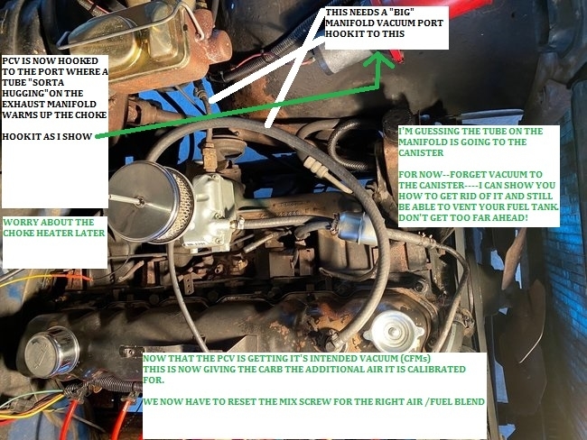

78CJ232,
Normally we would start a new thread for a whole new issue.
Since this is teetering on what the other guy's issue is, continuing here
might help out another soul searching for the same answers
Also looks like you got really involved with your post here.
So, I'm going to continue on this one.

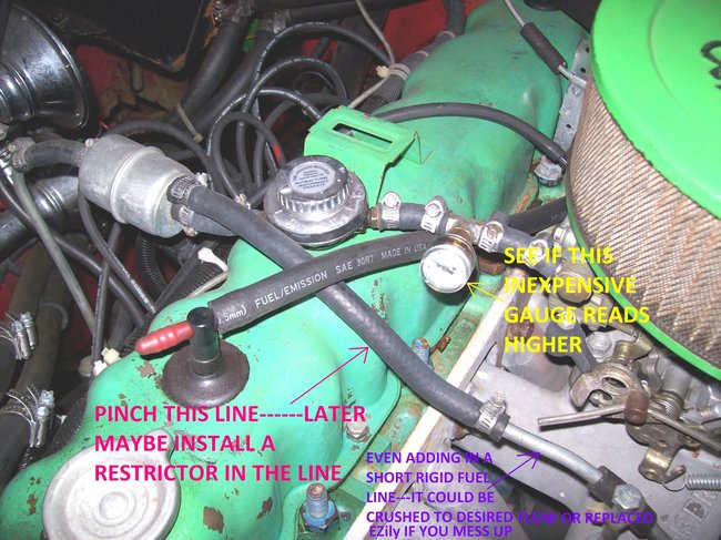

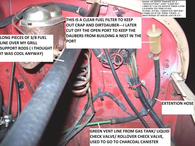

I have a pretty old post that I link folks to. (It still is good!)
I sort of took my 258 tuning and translated it to tuning an 8 cylinder 304.
You will need the 258 parts, the carburetor you have has one mix screw,
but it all tunes the same way.
You will need meters/ timing light/ whatever----tuning by "ear" is
nearly impossible to get things correct, even for an experienced feller.
Look at the pic I post below----- so far, you need to make those changes.
I may have more changes as we go.
That and possible not having done your timing just right, this "fix" may
get you going real soon!
Insure there are no open ports that are sucking air (from outside)
cap them.
I think you will be able to understand what to do in my link.
Pay special attention to the "How to time" instructions/ procedure,
there's only one correct way!
https://www.2carpros.com/questions/jeep-cj7-1985-jeep-cj7-stalls-when-hot
I hope the pic is legible
We'll fix the other stuff I left hanging when you return.

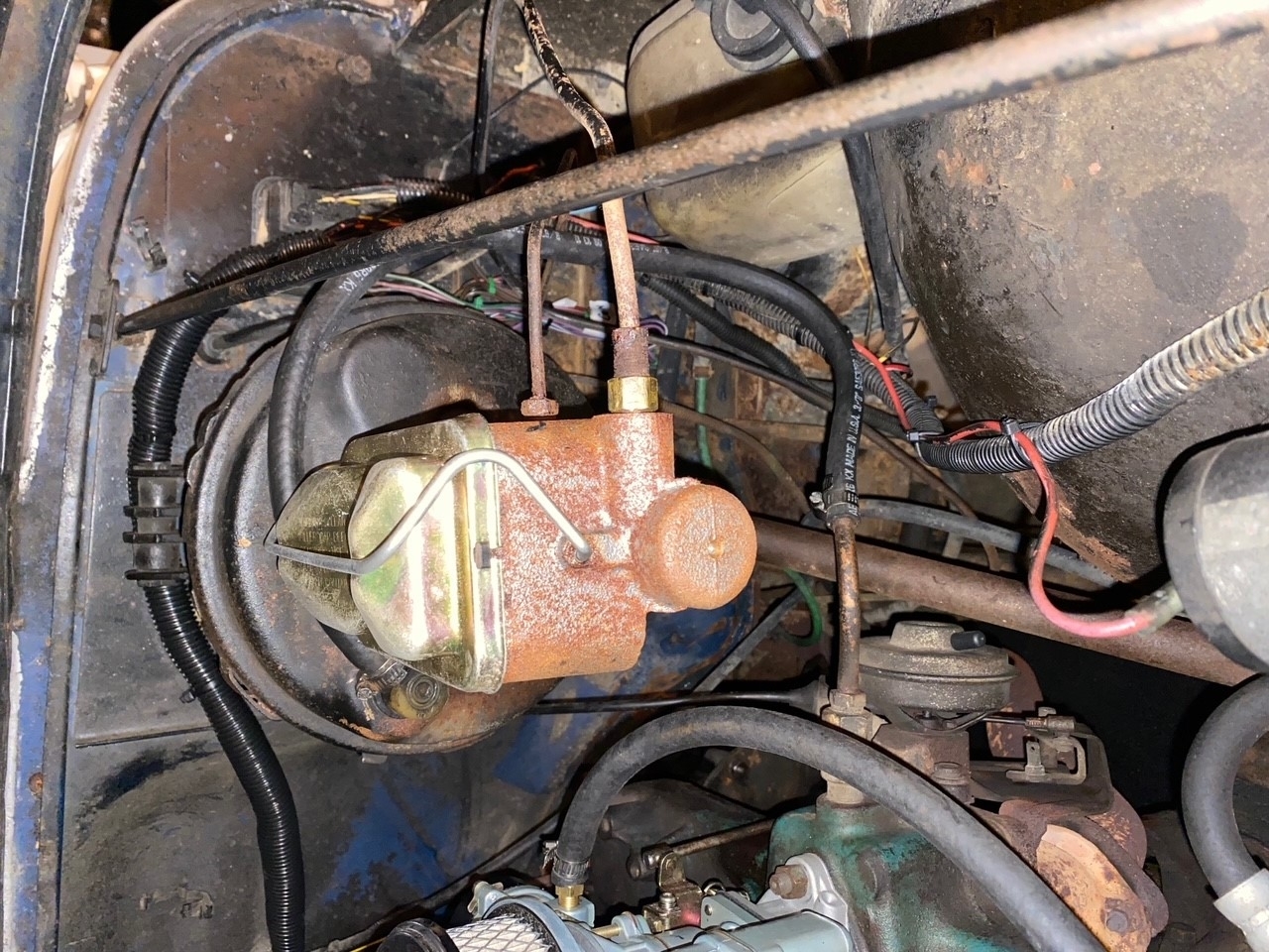

First, thank you so much for such a quick response. Before I start making changes I will add a few more details, add two more pictures and ask a few more questions.
The manifold vacuum source you want me to move the PVC valve vacuum line to is the CTO I think. See pics to confirm. (If it helps below, I will list how the EGR, CTO and Charcoal canister are currently set up by prior owners.) The brake booster is currently connected to this CTO line.
Question 1 - If I connect the PVC line to the CTO metal tube, what do I connect the brake booster vacuum line to?
Question 2 - do I cap off the choke heater port on the carb once I move the PVC line off of it? I think that is what you are referring to in your picture.
Question 3 - one of the prior owners removed all the smog control stuff. The metal tubes coming out of the manifold are simply crimped over. Is this a concern for what I am dealing with? Are these the potential open ports you mentioned above?
EGR Valve - Capped
Coolant Temp Override Switch
CTO Valve Small Port 1 - Capped
CTO Valve Small Port 2 - Capped
CTO Valve Larger Diameter Steel Line Port 3 - Currently connected to the Brake booster
Charcoal Canister - assuming it's only function now is for the fuel tank vent line port 3
Port 1 - Far Left front of motor port - Open
Port 2 - working towards firewall - connected to the windshield washer tank lid (no joke)
Port 3 - Line runs towards fuel tank
Port 4 - closest to firewall Open
Question 4 - Once you confirm the above, I will start making the changes and recheck timing. When I remove the vacuum line from the distributor to check timing, do I cap the port on the distributor and plug the vacuum line going to the carburetor?

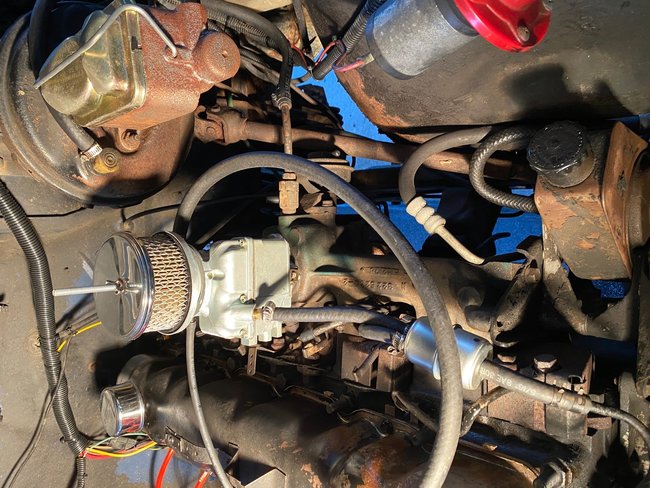

Do you have a big port on the carb
Below the throttle plate?
(sucking all of the time-manifold vacuum)
If so, hook the pcv or brake booster to it
Both should have a big port to connect onto.
NO???
How about a big tee to use on the existing line to
connect both onto?
Everything else capped is just fine----just no open ports
sucking outside air!
Of course, get the wiper washer hoses where they go---not on engine vacuum!

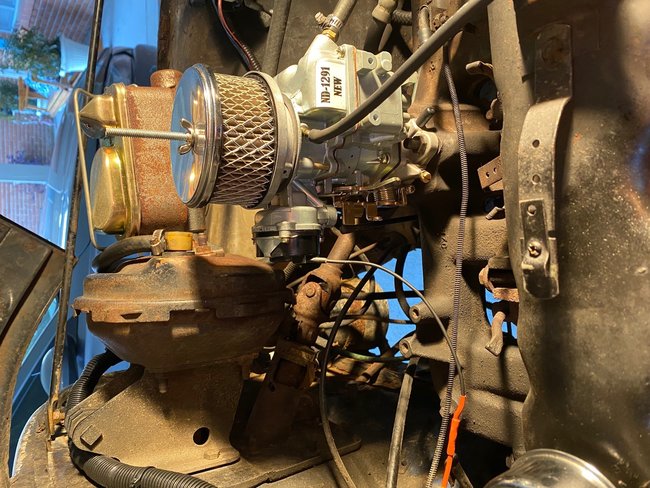

Making progress. I don't think I have a port on the carb that will work for the brake booster. I have the vacuum port at the base of the carb that the distributor vacuum is hooked to currently. I have a port at the top of the carb which I think is the fuel bowl vent but is currently capped off. It is nowhere near large enough for the brake booster vacuum line.
The last available port would be the choke heater port. What should I do with this port? Cap it?
Back to the brake booster. I will add a T to the PVC line going to the CTO port and connect the brake booster vacuum to the T.
Regarding the charcoal canister, I just want to confirm it can be removed and just add the fuel filter vent in your picture to replace.

Without the emissions stuff all working, the canister won't operate as intended.
Fuel filter is nothing but a anti-trash/ anti-insect breather
Lets put one on the bowl vent so it can breathe too.
(capping the bowl vent) most likely will pressurize the bowl and when you shut him down after a drive, it will be as if your fuel is boiling out of every crook and cranny of the carb till the bowl is empty from the engine heat.
(seen this happen on BBD carburetors several times)
Possible that this might happen! (about 3 minutes in)
https://www.youtube.com/watch?v=5IGkGBBnDr4
(not mine, but I almost cried anyway!) It can consume the whole Jeep.
So, few inches of fuel line attached to one side of a fuel filter, the other end to the bowl vent port.
in the pic) "to charcoal canister" is the green hose I show up above in the other pic.
If you install headers, the EGR would be eliminated....hence, it is not a necessary item to make the engine run.
I can only suggest things you can do that will work, others might suggest that you put it all back like it was new.
Tee off of the big manifold line (barbed tee from auto store) hook up the booster and PCV.
Tune it the best you can! Return with results.
The Medic

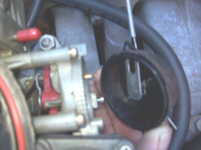

What do I do with the choke heater port on the carb? Do I need to run a line to it from somewhere or can I leave it with nothing attached?
Thanks again for the help and advice. It may be the weekend before I am able to work on it again but will follow up eventually.

Hey Medic. I made the suggested vacuum line changes, reset idle, timing and carb (using a vacuum gauge, don't have a rpm meter). Still need to add the vent lines and filters to the carb bowl vent port and fuel tank vent currently running to the charcoal canister.
We had a front coming through with rain so only went for a short run. I hate to jinx things saying this but have to say it really ran well. I need to run it more to confirm. Will let you know if find otherwise.
With this set up, when I use the brakes, the RPMs drop 100 or so. Any concern?
I added a piece of fuel line to the carb choke heater fitting and plugged it. Any concern here?
Thank you so much for your help and advice. I really appreciate it.

The only thing I can see that might help your RPM drop might be if you have another big manifold vacuum port (that sucks all of the time),
and you can put the PCV on one and the booster on the other.
I'm glad you have made a big improvement!
Keep me posted on your progress or if you have other issues that you need assistance with.
----The Medic

Hey Medic. It's been a few weeks. With all the vacuum line changes the jeep was still having issues accelerating at top of 2nd gear and 3rd. Made a decision to replace the fuel tank which was a good one. Alot of trash and old pick-up tube needed replacing. Jeep now runs great up to about 40-45 MPH then acts like it is starving for fuel again. Begins to almost shut off, let off accelerator, it will go a little then want to shut off again. Otherwise runs great as long as around 40 MPH or less. Any other thoughts? It has a 1bbl carter yf carburetor.

Heater thingee on choke!
Normally there is something like a steel brake/ steel fuel Line connected
to it. The other end bends over to the exhaust manifold and runs
down beside it. Hugging/ touching the manifold as much as possible----
this transfers heat into the tube. The inside the choke cover
(in the aluminum) it has a teeny -tiny hole (a little bitty vacuum leak)
constantly sucking air......in a perfect set up---the heated air inside
the steel line. This would warm up the bi-metal spring inside and
aid in the choke to stop choking!
'Round here, the dirt daubers might fill the end of the pipe with their mud,
something to be aware of!

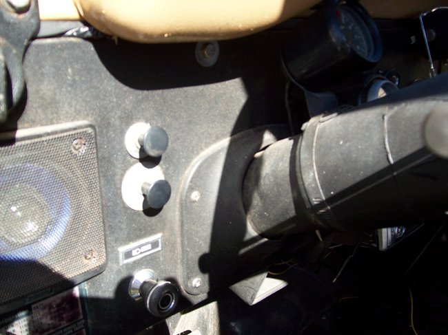

Or you can just leave it open----Or like me install a manual choke.
As a newcomer to manual choke----the worst thing about it is FORGETTING to push it
in FULLY once you are warmed up......usually you figure it out when the JEEP
starts sorta flooding and lacking power!
**********ARE YOU TUNED AS The "Stalls when hot" thread describes to do?
You are not winging it by ear?----using the meters and timing light?
The next thing I'd try----IF YOU ARE TUNING CORRECTLY!
Remove the 1st Add On fuel filter as a test, maybe? it's restricting
Your fuel volume???? Making the carb starve thru lack of refilling
the bowl during a higher demand?
Gotta have everybody working together.....ignoring correct timing....timing at a unknown RPM....ETC, will inevitably factor in evilness!
I'm gonna be your best JEEP buddy now.......Find YOU, in amongst
this stuff in my link........It will be your best buddy too!
Something funny is going on with the link---when you click it,
scoot the screen over to view the right side.
https://oljeep.com/
Once you find your manual, if possible copy it to a thumb drive,
This could disappear at any time!
Let's hear your end now!
-----The Medic
