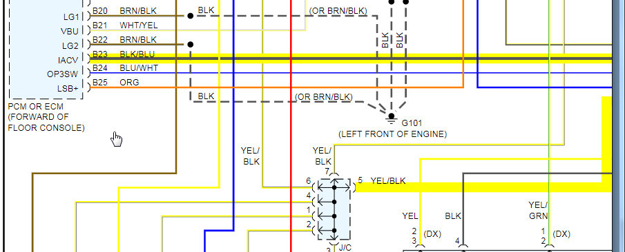

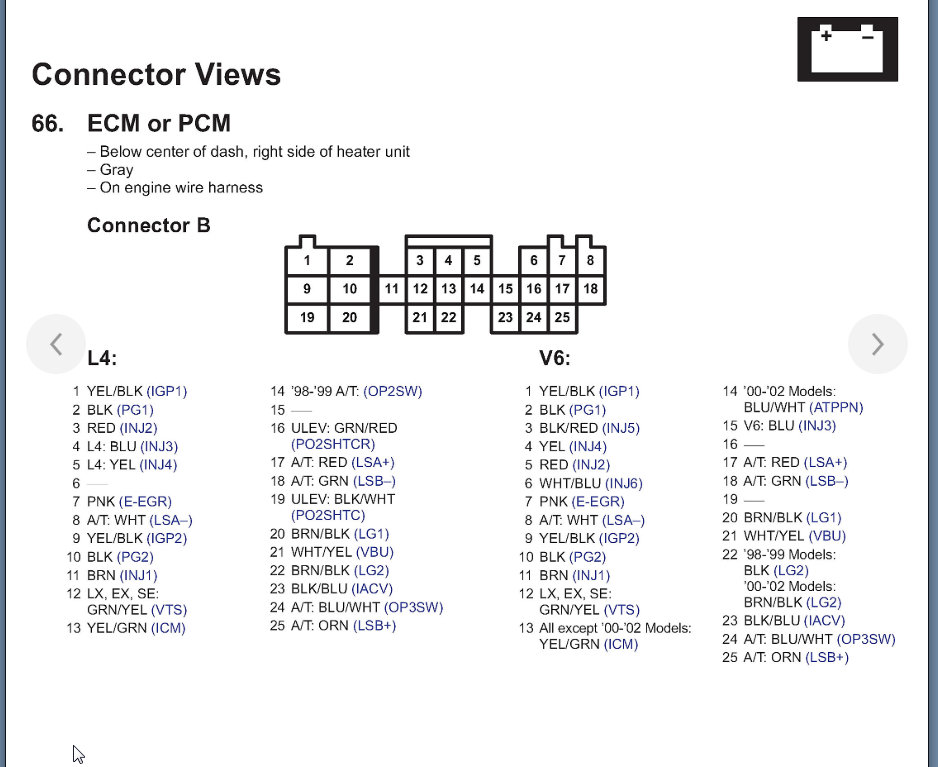

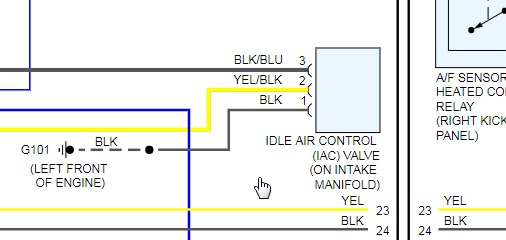

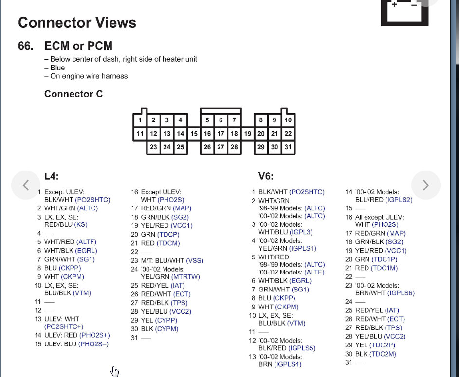

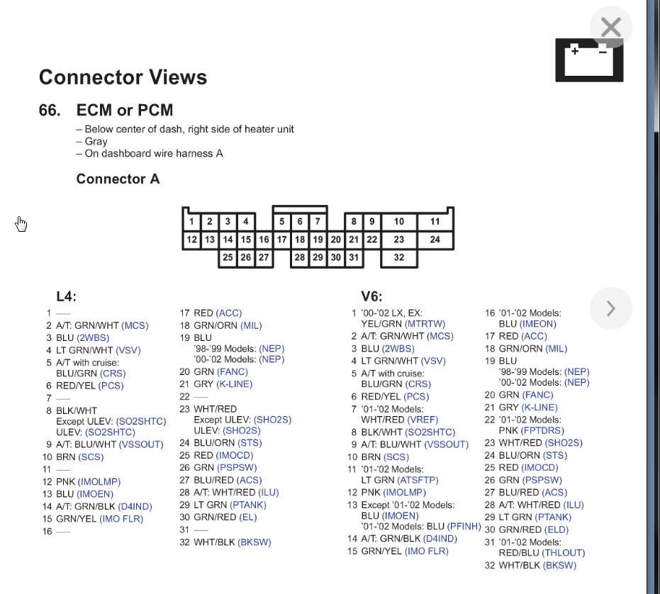

Yea, i was checking to see if the wires were shorted to ground. I wasn't too sure which connector to unplug and the pin identification of where b23 was on the main connector. Are you able to get me a connector diagram for the PCM harness?

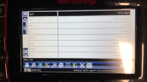

I was able to take a short video of the pids on a Snapon scanner. it appears when it happens the timing is being advanced by about 28 degrees .
Nov 13, 2019 at 3:55 PM

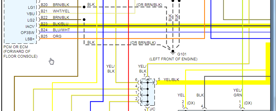

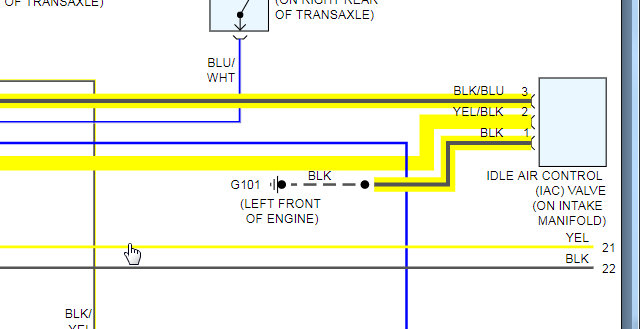

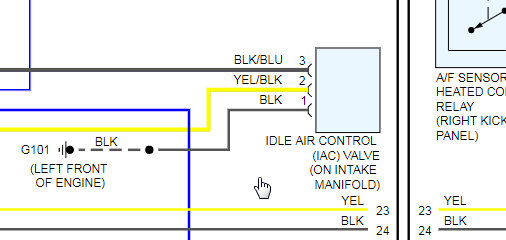

I gave you each of the connectors for you vehicle but for this circuit you need connect B and look at pin 23. Measure resistance from here to the IAC on pin 3.
As for the timing jumping, I am not sure that is causing the issue, it may be a symptom. Let's just make sure the resistance is good and no shorts and we can go from there.

I was able to verify on the ground i had 1.1ohms of resistance. The signal wire has .8ohms and the power has .3ohms. I also have 11.6v going to the power pin.
Nov 14, 2019 at 6:36 PM

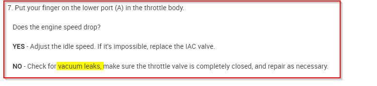

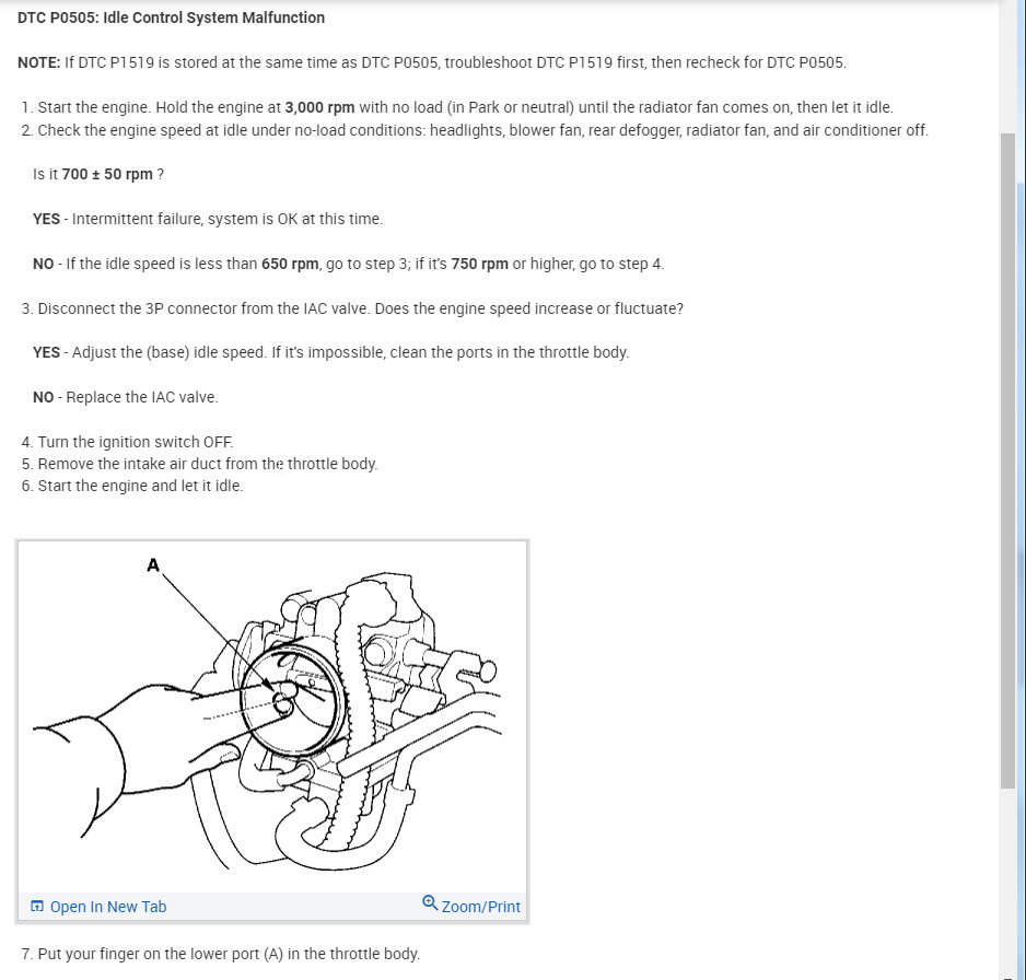

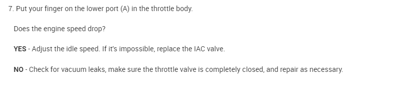

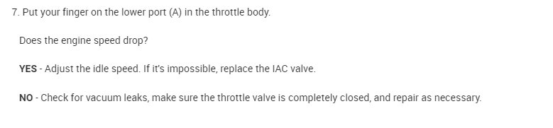

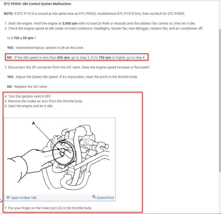

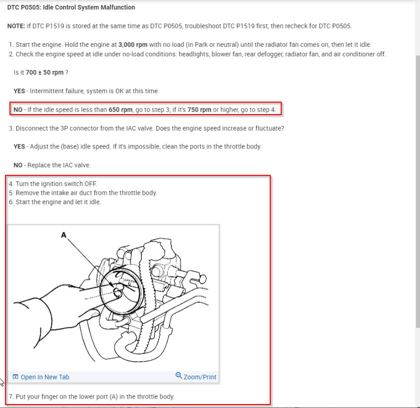

Okay. The ground is a touch high but I don't think that is going to cause this issue and the others are perfect. Since that is okay, let's go back to the P0505 and jump to where I circled in red. When the engine is warm you idle appears to be over 750 and it ranges. So we need to block the lower port of the throttle body as shown and see if the RPM's drop. If they don't then you have a vacuum leak somewhere in the intake system that is pulling in unmetered air.
Here is a guide that shows how to find a vacuum leak with a carburetor cleaner. Basically you are looking for where you spray it and the RPM goes up. This is where it is pulling air in and it brings in that fuel source and the RPM will go up.

I have a smoke machine. The only vacuum leak is from the center of the EGR valve and is very small. My throttle body doesn't have a lower port either i only have the upper port that feeds into the EGR.

I will have to retest the scantool on Monday after work. My throttle body only has the one port on the top.

You mean the continuity on the IAC itself or the wiring connector? The wiring should have no continuity with each other because Pin 1 is ground, 2 is your reference voltage and 3 is your command from the ECM.

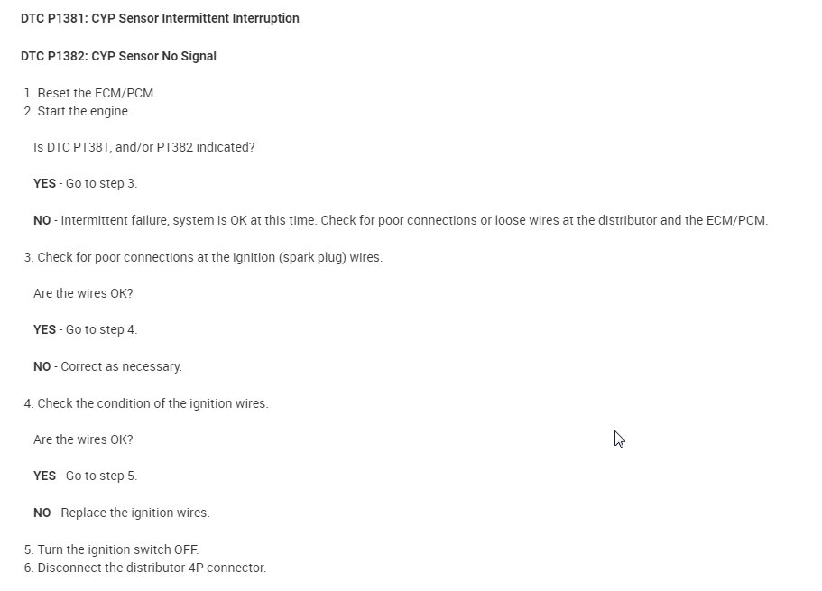

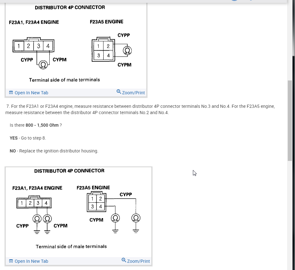

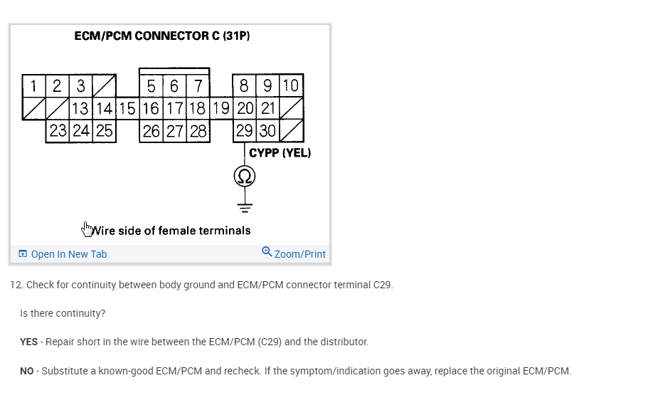

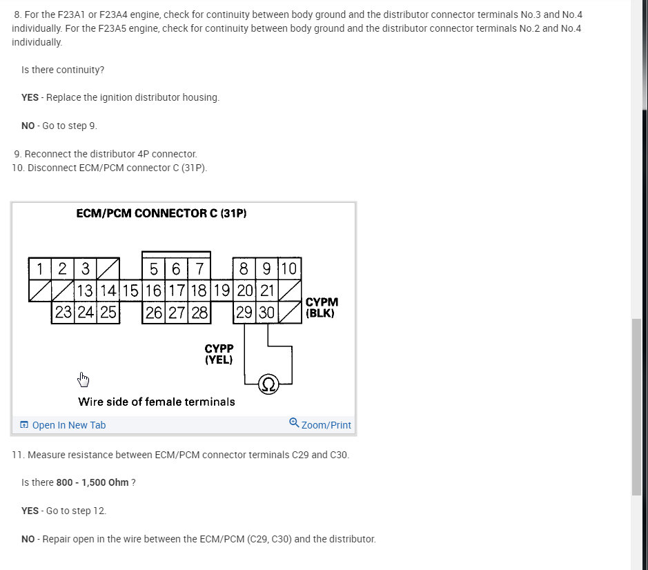

Yea the problem only happens when the system reaches closed loop. today driving it i just got another code p1381 for the cylinder position sensor signal intermittent and the car went into limp home mode. How would I test the ECU? I am starting to believe that is the cause of these problems. Figure the ECU is 17 years old.
Nov 22, 2019 at 8:28 AM
You could be right. However, it appears the easiest way to tell if it is a wiring issue or the ECM is to clear it (reset ECM) and then start the engine. If it sets then it is most likely the ECM. If not, then you probably have a wiring issue. Here is the test that details this.
