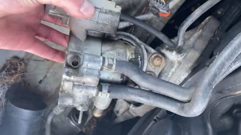

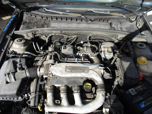

I can’t find the location of the idle air control valve. I’m new to this app so I don't know how to work this. But I tried Googling it. Came up with nothing I will add videos and pics of the type of engine. please help.
Jan 27, 2021 at 3:52 PM
J_MONEY
There isn’t a IAC on the throttle box.

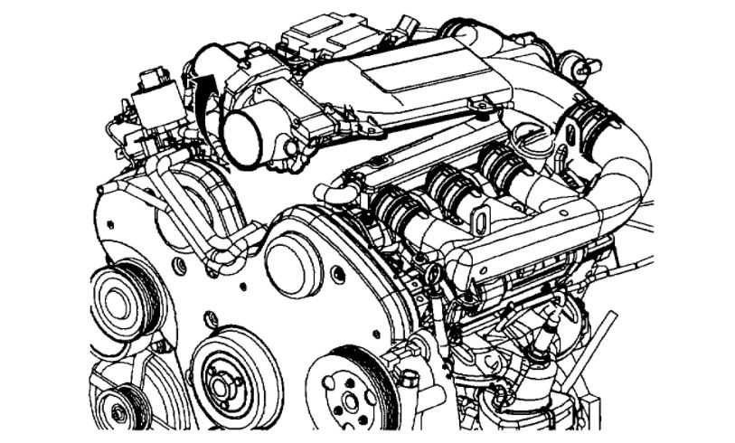

Good evening,
The idle air control is part of the throttle body and is not replaceable without replacing the throttle body itself.

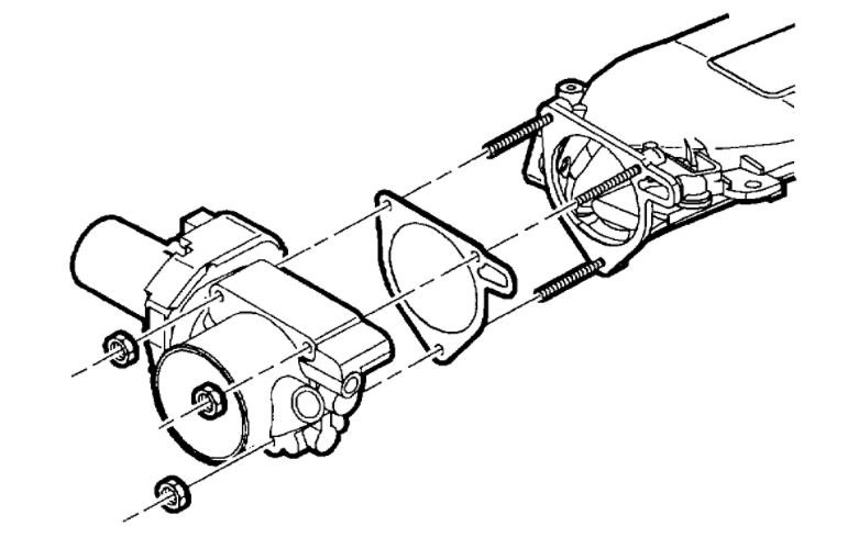

Throttle body
TOOLS REQUIRED
^ J-43914 Hose Clamp Pliers
REMOVAL
1. Disconnect negative battery cable.

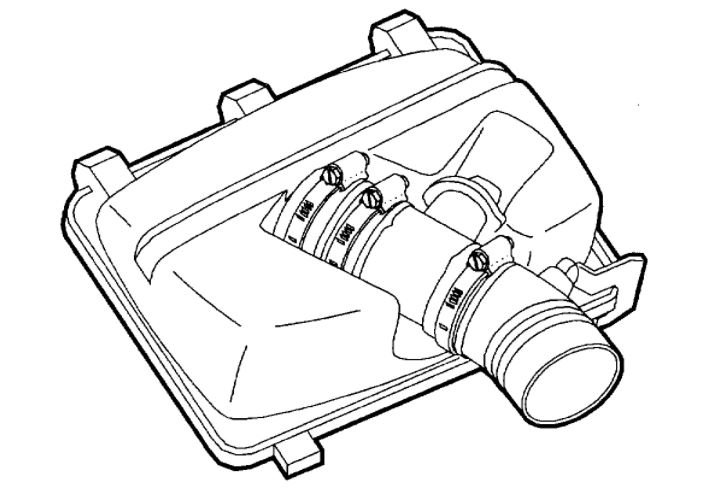

2. Remove inlet hose assembly from throttle body.
3. Disconnect throttle body electrical connection.
4. Disconnect hose clamps from plenum-to-runner connector using J-43914 hose clamp pliers.
5. Remove intake plenum bolts.
6. Rotate plenum up and remove throttle body coolant hoses, EVAP hose, and vacuum line from throttle body.
7. Remove throttle body nuts.
8. Remove throttle body.
Installation
1. Install throttle body and new gasket.
2. Install throttle body nut.
Torque: 8 N.m (71 in-lbs)
3. Attach vacuum lines, EVAP hose and coolant lines to throttle body.
4. Install intake plenum bolts.
5. Connect intake plenum-to-runner hose clamps using J-43914. If clamps are damaged, replace with service screw type clamps.
6. Connect throttle body electrical connector.
7. Install air cleaner inlet hose.
8. Connect negative battery cable.
