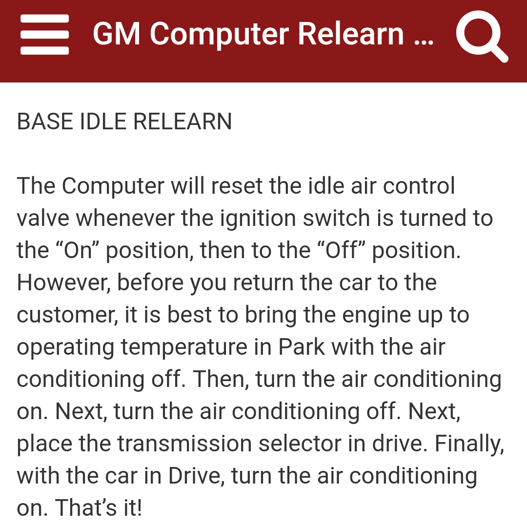

To erase diagnostic fault codes yourself, only remove the negative battery cable, not both. You need both cables for the electrical system to work, so removing just one cable is all that is needed. It is customary to remove the negative cable because if the wrench hits a metal part of the body at the same time, there will not be any sparks.
The engine computer takes care of relearning any new sensors. All those steps you listed for trying to teach something to the computer had my head spinning. I have never heard of most of them. The only one I know for sure about is relearning "minimum throttle" on Chrysler products. The procedure is real involved. You are to drive at highway speed with the engine warmed up, then coast for at least seven seconds without touching the pedals. That is it for relearns that you initiate. Everything else is easier because you are not involved. The instructions you posted are for the one in a hundred cars that might concern a customer, but almost all relearns are handled by the computer, and only a few take more than few seconds. In the majority of cases, there is nothing for you to do, and there is nothing you can do.
