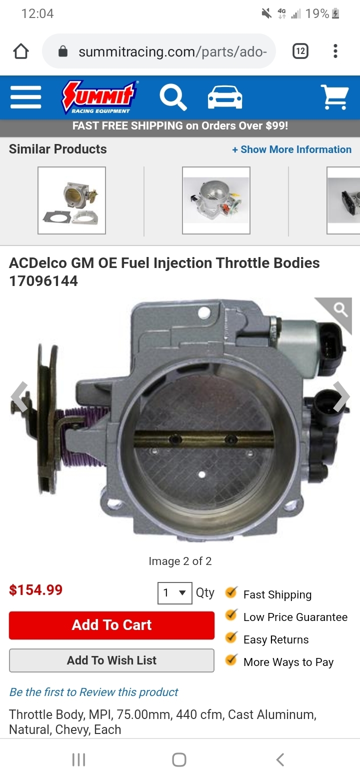

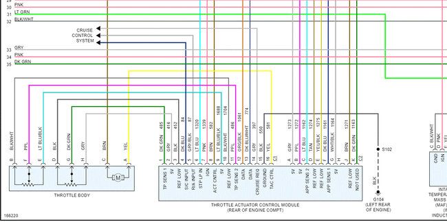

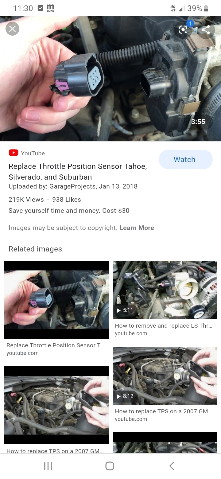

There was an engine swap from the previous owner but I bought it like this, so I'm stuck with this. first picture is the throttle body it has and second picture is the throttle body connector that my harness came with. the TP sensor is was already connected but where do I wire the IAC valve? can I connect using this wiring diagram? I hope you understand what I'm trying to figure for the past week.

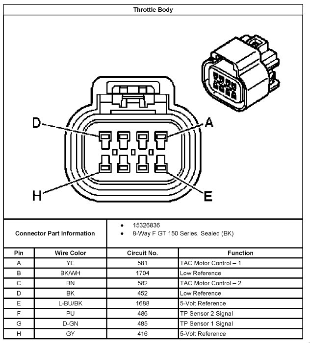

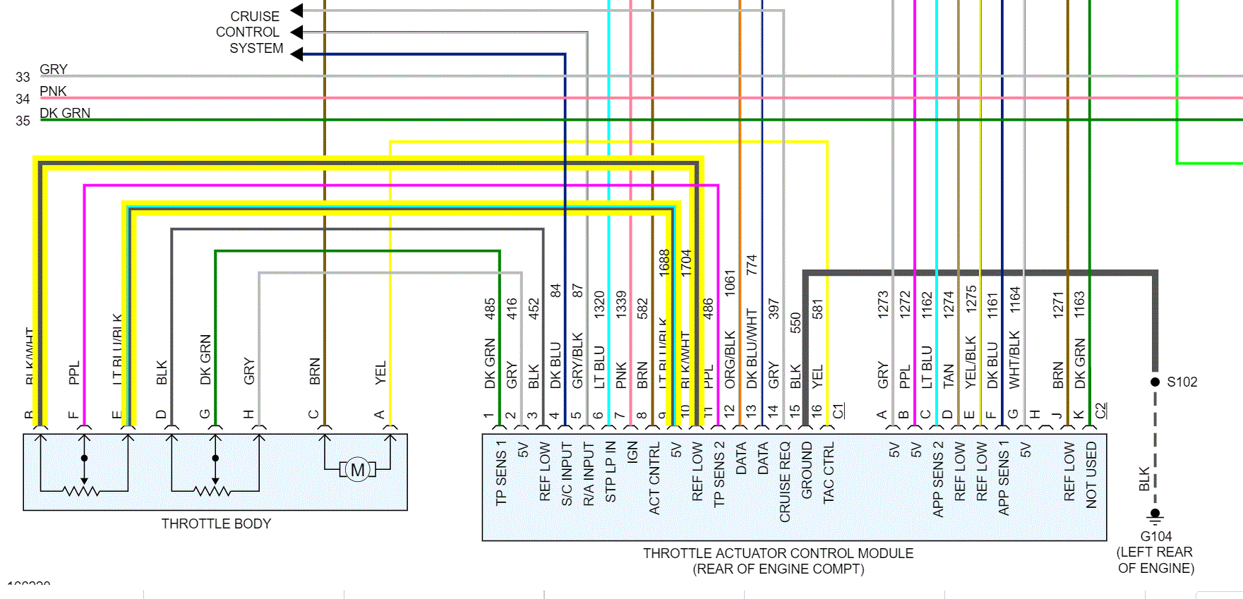

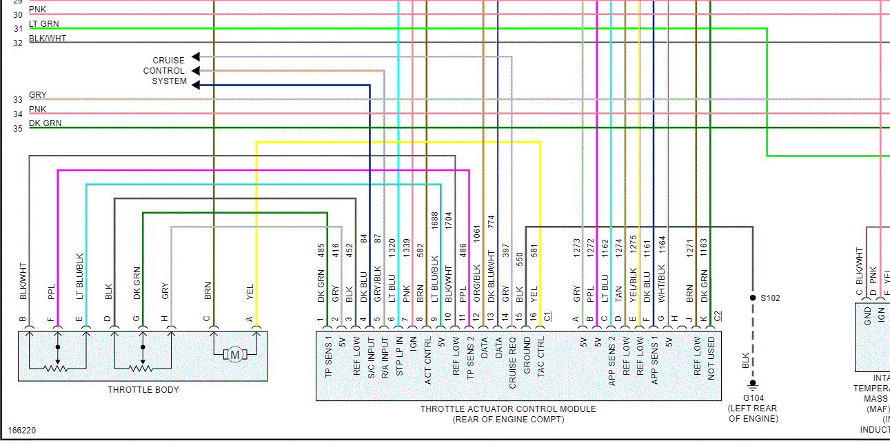

I attached a pic below that shows an 8 pin connector. See if that is what you are looking at. Also, if you want, I can attach all wiring schematics for power-train management. I'm not gong to lie. I need to see what is going on with this one. If you want the schematics, they indicate wire colors and where they travel. Since we are dealing with two different designs, I don't want to give you bad info.
Let me know if the schematics will help.
May 1, 2020 at 10:05 PM
MARTIN GARCIA
  • 5 POSTS
Yes, the schematics you sent me is what I have in the harness and on the second picture is what I have for the IAC on the throttle body.

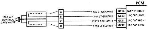

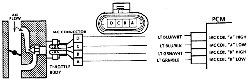

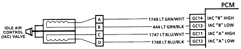

How do identify the highs and lows for the IAC?
Would these be my wires I need?
Black/white, light blue/black. , black , gray
Ref low. , 5v. , ref low, 5v
May 1, 2020 at 10:48 PM
I have to be honest, I'm questioning it. However, I believe what you are saying is correct, but the purple wire is tp sensor 2. I would thing that is the third wire for idle speed. The Black / Gray you mentioned if going to the cruise control, which I don't believe is needed for idle speed.
