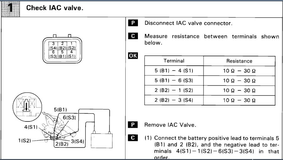

Intermediate stall at stops. Need diagram and specs to check resistance of valve.

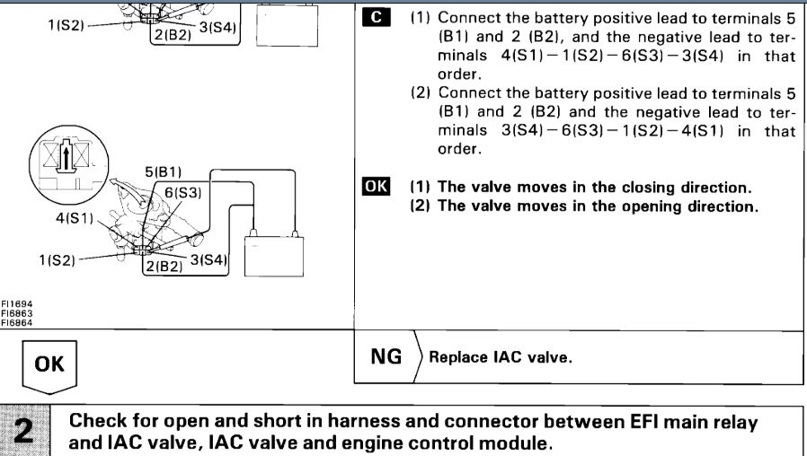

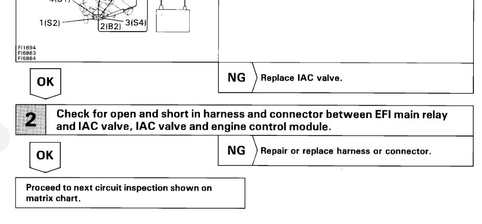

I attached what I believe you are looking for. I had to break it into 3 pictures to make it readable, but I did overlap them so you can follow easier.
Let me know if this helps.
