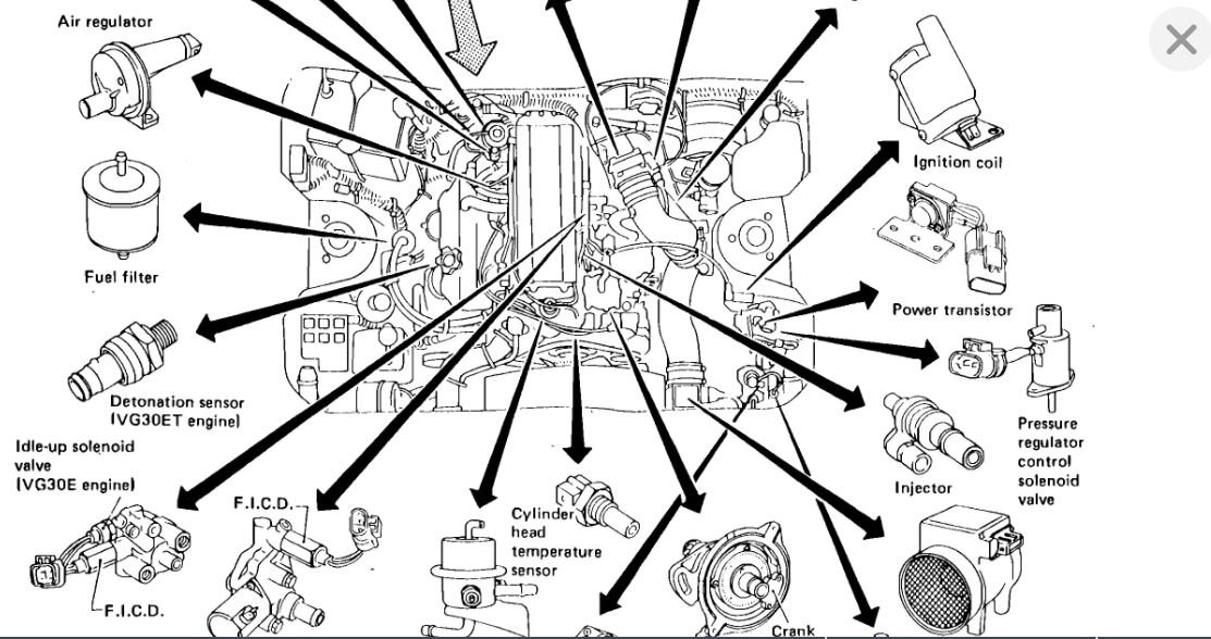

Cold start sensor does not work. Cranks up but idles low like no choke.

There is a coolant sensor that sends the ECM a signal of the engine temperature. That will activate an air bypass valve to slightly elevate the idle when the engine is cold. When the engine warms up, the valve will close completely.
Has anyone checked these?

I have not. Do you know where that is located at?
Dec 23, 2017 at 4:58 AM
I attached a picture for you with the air regulator as well.

Looks like fun. lol. Thanks for your help and have a Merry Christmas.
