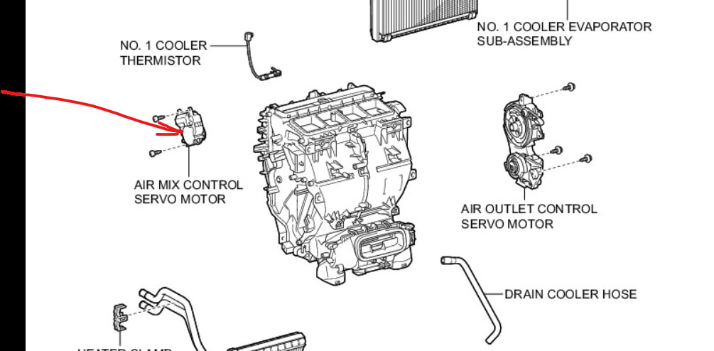

It sounds like you have an air mix servo motor that is out which is located under the dash on the driver's side on the HVAC plenum. Check the images below to see the location and let me know what happens please.
