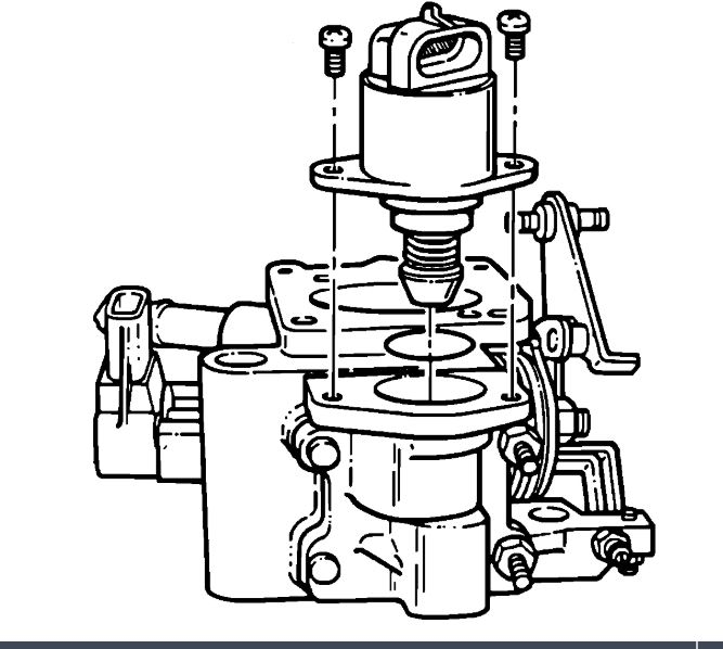

Where is the idle air control valve located on the car listed above?
Jun 3, 2020 at 10:45 AM
Good afternoon,
The IAC is on the throttle body. I attached pictures and the procedure for you for the replacement.
https://www.2carpros.com/articles/how-to-replace-an-idle-speed-control-motor-iac
Let me know if you have any other questions.
REMOVAL:
1. Disconnect the idle air control (IAC) valve electrical connector.
2. Remove the IAC valve attaching screws.
3. Remove the IAC valve assembly.

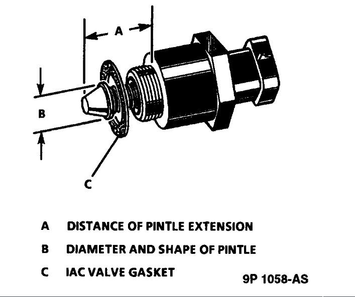

NOTE: If installing a new IAC valve, be sure to replace with an identical part. IAC valve pintle shape and diameter are designed for specific application.
Idle Air Control Valve
INSTALLATION:
1. If installing a new IAC valve, measure the distance between the tip of the pintle and the mounting flange.
If greater than 28 mm, use finger pressure to slowly retract the pintle. The force required to retract the pintle of a new valve will not cause damage to the valve.
2. Lubricate the IAC valve O-ring with clean engine oil.
3. Install the IAC valve assembly.
4. Install the IAC valve attaching screws, and tighten to 3.0 Nm (27 in lb).
5. Connect the IAC valve electrical connector.
