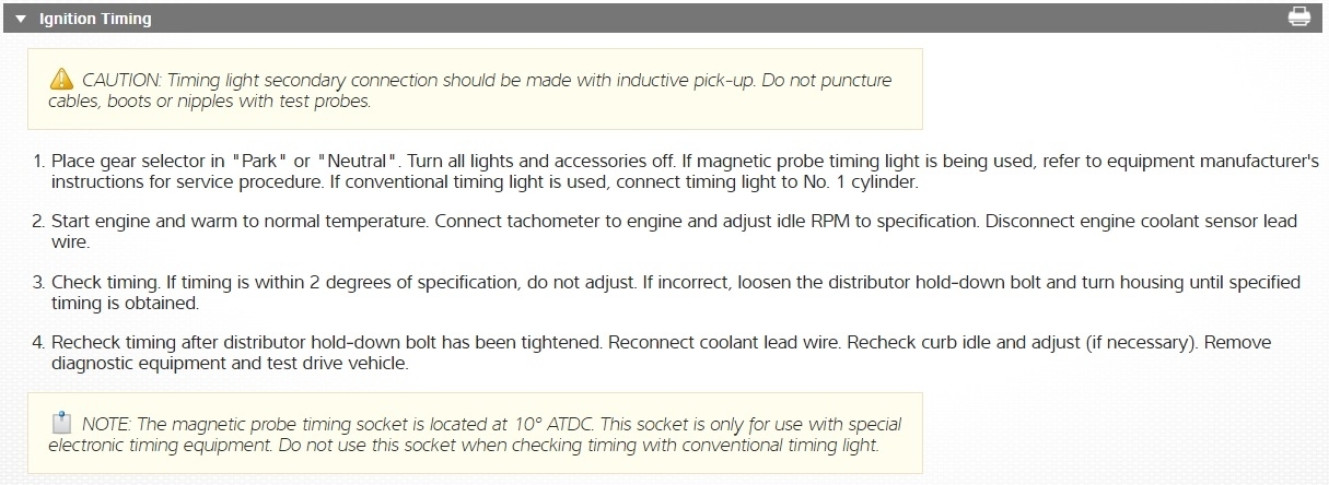

Sending you the procedure from "Prodemand"
See if you checked timing like they show it.
See picture/ screenshot below

I am using a conventional timing light. The idle speed is not adjustable. I warmed the engine to normal operating temperature, and remoxed the coolant sensor lead and check the timing. The rest is as described in my question when I changed the distributor. I also removed the front cover and inspected the time marks and the belt. all was as it was stated in my Hanes manual. I replaced the timing belt about three or four years ago.
