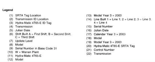

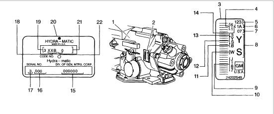

Where can you find the identification tag or plate (which ever is the actual name for it) on the transmission?
Dec 21, 2018 at 7:27 AM
I have attached two pictures for you to look at. It indicates where to find the information you are looking for. The first picture indicates locations and picture 2 is a legend describing what everything means.
Let me know if this helps. Note: This information is based on a 2003 Monte Carlo.
