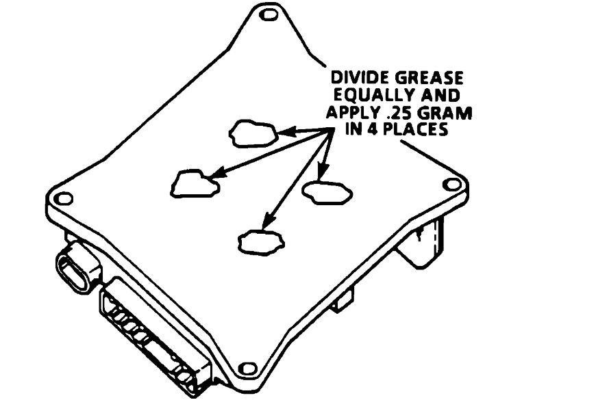

I have checked wires off ICM and crank sensor all looks good. Majority of my problems seem to have occurred after I had removed the aluminum plate under the ICM. There is corrosion here. My new coils read the same resistance as old ones but I do see cracks at bolt down area and black marks on primary tower plastic about midway up.
