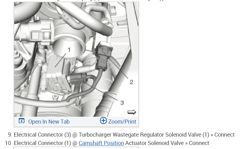

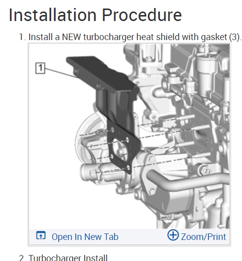

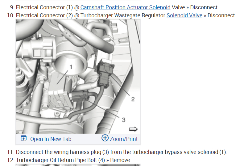

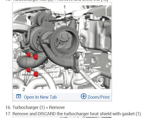

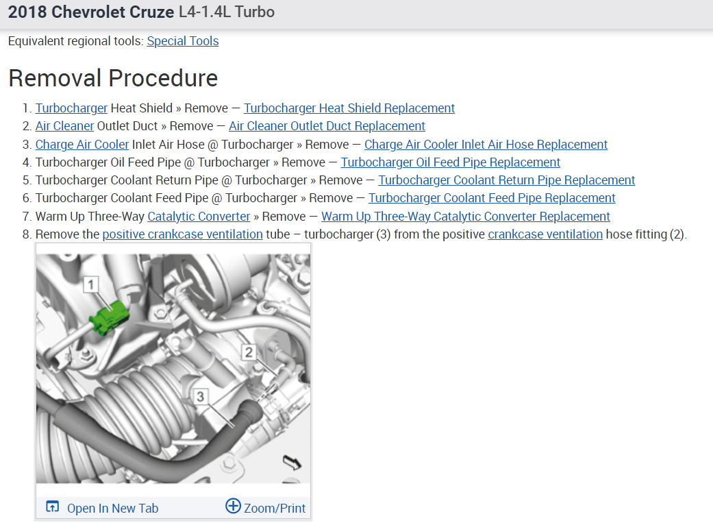

So, are you having any other problems besides the ice on the intercooler? It may be normal, and the slight change can be the turbo wearing out. You might want to remove the either the inlet to outlet tube and check the turbo endplay.
https://www.2carpros.com/articles/how-turbo-chargers-work
Check out the images (below). Please upload pictures or videos in your response to the problem so we can see what's going on.
