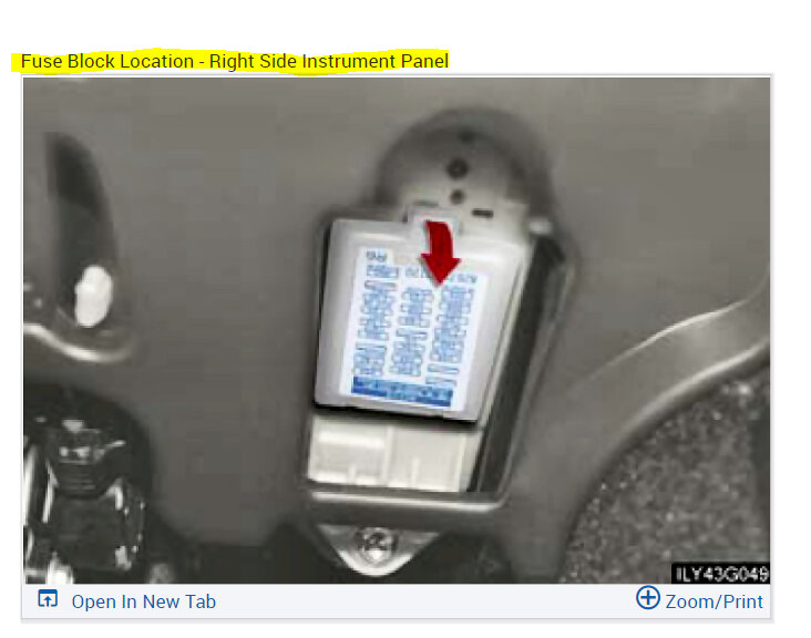

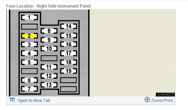

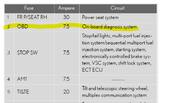

As far as the fuse is concerned, it is on the right side of the dash. It is fuse 2 (7.5A) and should have power at all times.

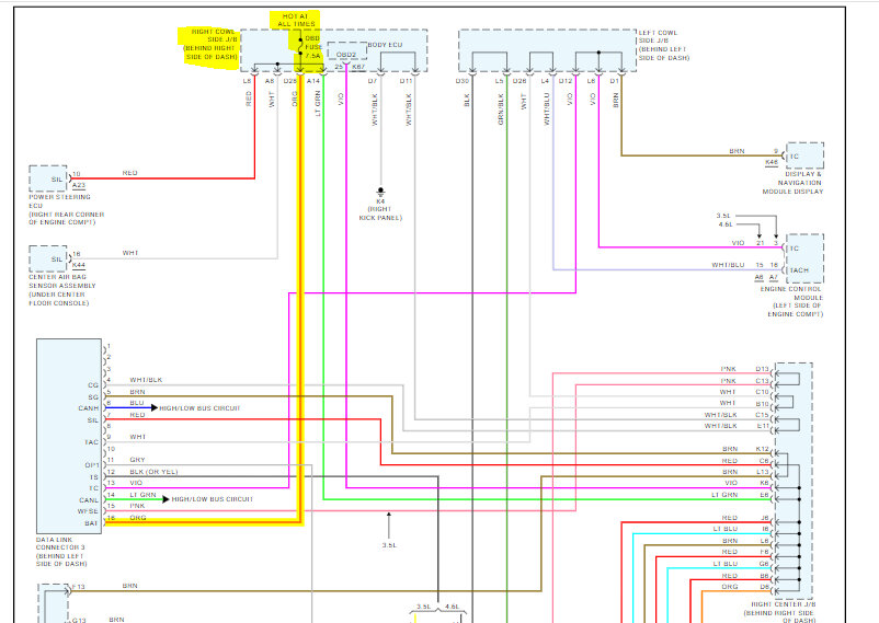

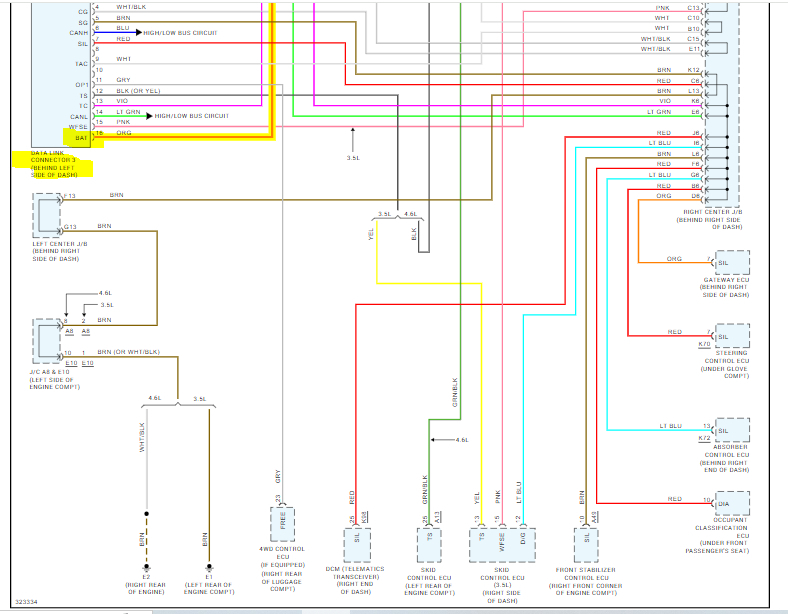

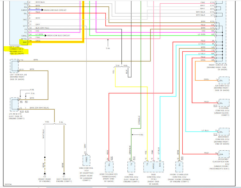

If you check pin 16 at the data link connector, it should have battery voltage.
If you look below, I attached the wiring schematic, the legend of fuses for the fuse box I'm referring to, and the fuse to check.

See pics below.
