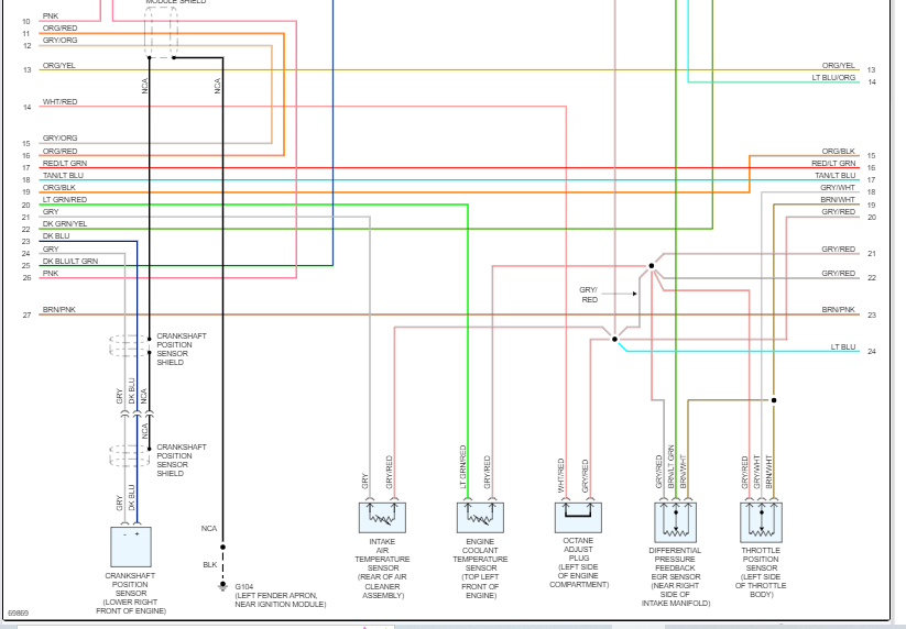

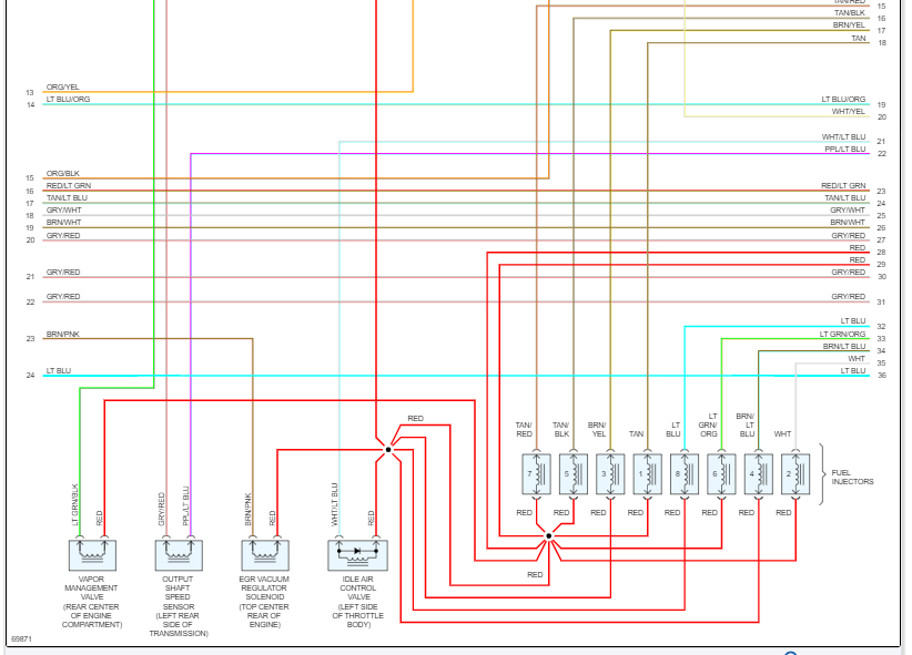

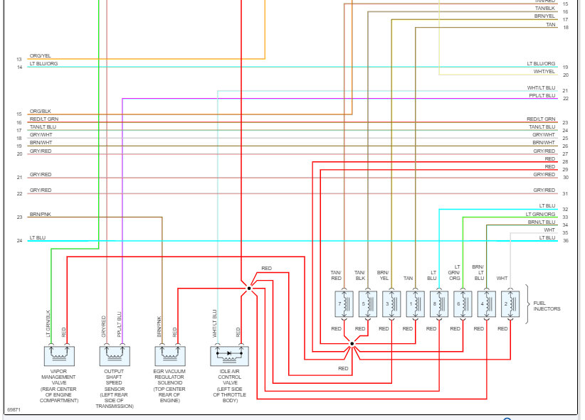

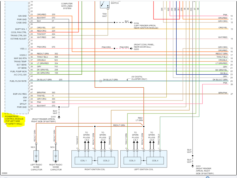

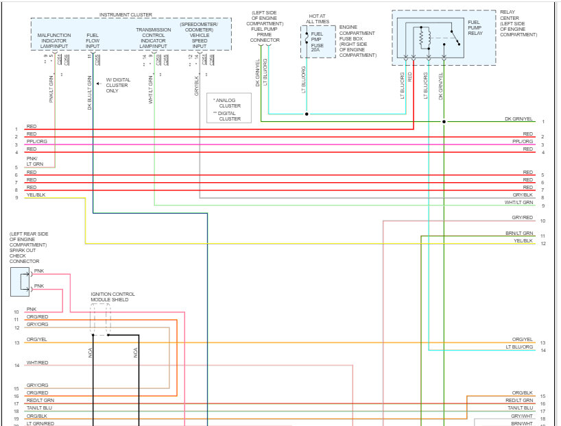

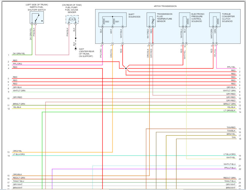

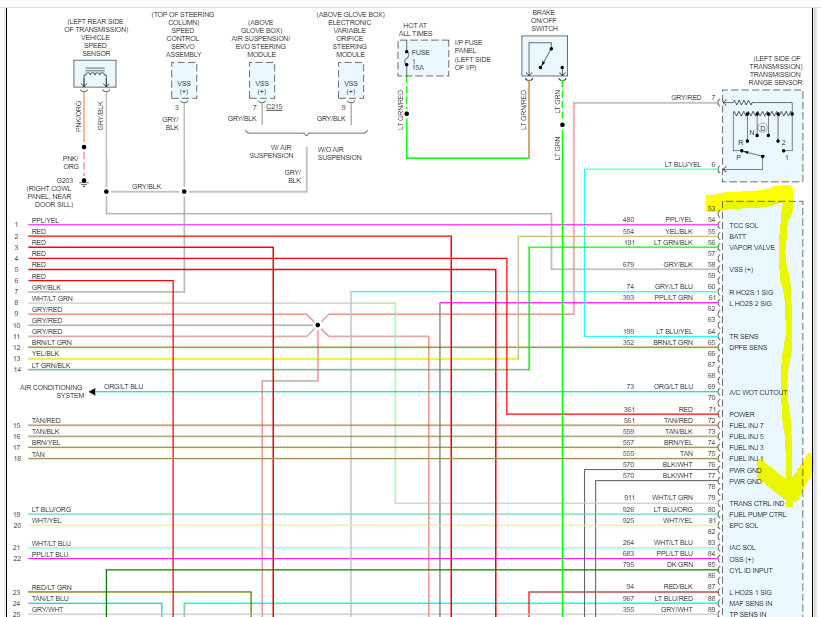

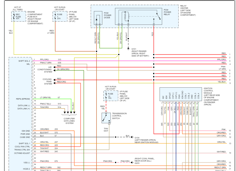

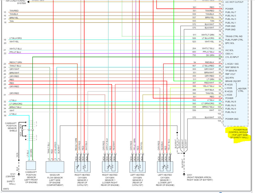

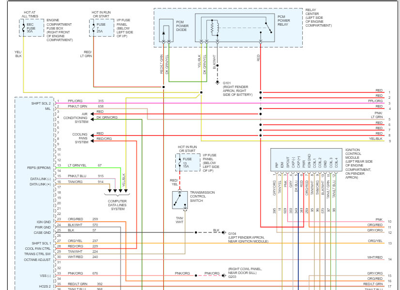

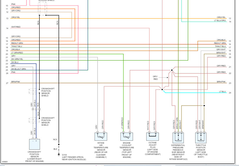

I attached the entire powertrain management system schematics below for you. I had to cut each pic in half to make them readable for you, but I did overlap them so you can follow from one the next.

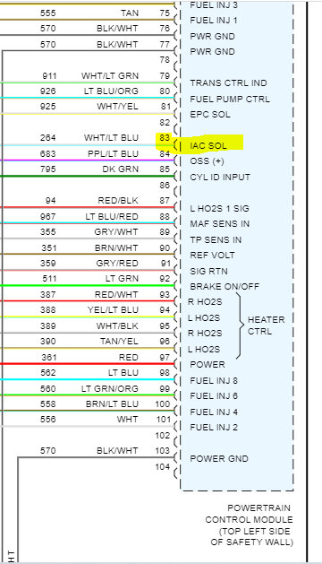

As far as the IAC, what I'm seeing is this. Power is supplied via the red wire at the IAC via the PCM relay under the hood. A ground path is provided via pin 83 of the PCM.
See the attached pics. The very last pic I copied a close-up pic and highlighted the pin.
Let me know if this helps.
See pics below.

Thanks so much. This is exactly what I needed. Will be tackling this problem this coming weekend and will report back. WC

Again, thank you for the diagrams. They saved a lot of time testing/guessing. It looks like I'll be needing a new (reman.) PCM. But here's what I did in case it will help someone else. First, I tested the red wire for power with key on/engine off using a test light. Power=ok. Used a noid light (a test light will work if careful not to damage the connector contacts) in the connector and turned key on/engine off. No light. Next, disconnected the PCM harness at the PCM and found the 83 pin. Tested continuity between harness connector 83 and IAC connector Wht/LtBlu. Continuity=ok. So, no breaks in wiring/harness between PCM and IAC valve. Valve was replaced with new last week. Yeah, guilty of throwing parts at it.
I hate to put a new PCM in just for the one failed IAC circuit. I may just drive it like it is with the idle stop screw adjusted up and wait until some other circuit fails in the PCM and then replace it.
Thanks again, WC
