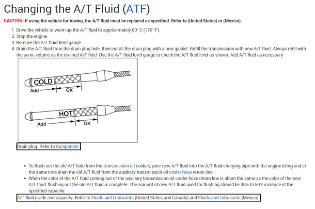

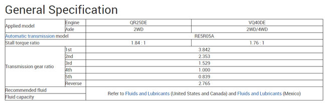

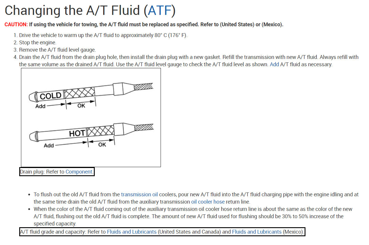

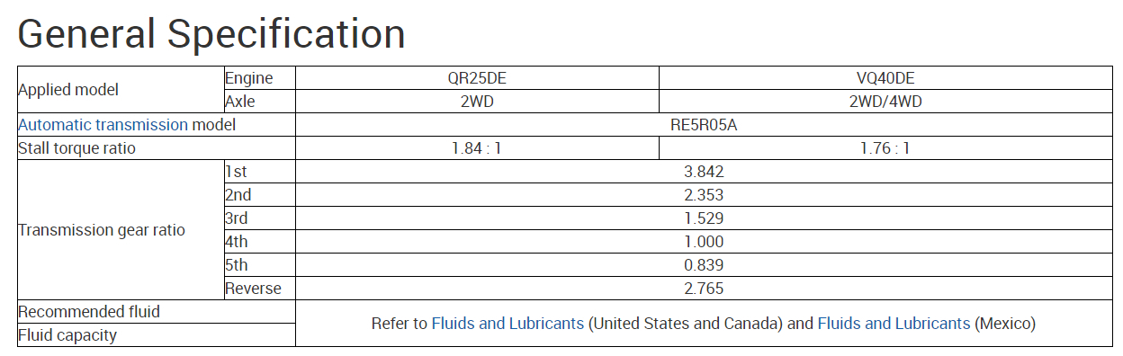

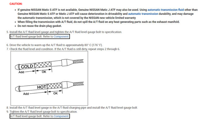

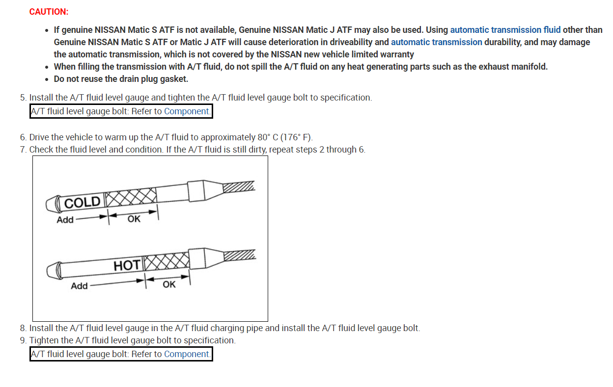

Hello, I need step by step instructions on how to change the transmission oil.
Thank you
May 24, 2021 at 5:00 AM
CERTIFIED EXPERT
53,855 POSTS
Here is a guide to help you step by step with instructions in the diagrams below to show you how on your car with fluid type and capacity:
