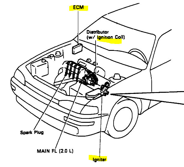

Next, if you were spraying under the hood, the ignitor, and the distributor/ignition coil are there. Did they get wet when you worked on the engine bay? See pic below
Note, I highlighted the PCM, but that should be on the inside of the vehicle. Check those components for water, dampness, and so on. Also, I realize you replaced the spark plug wires, but did you remove the distributor cap to make sure nothing is wet?

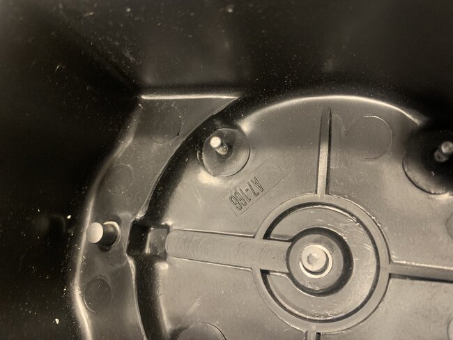

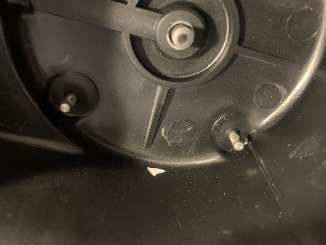

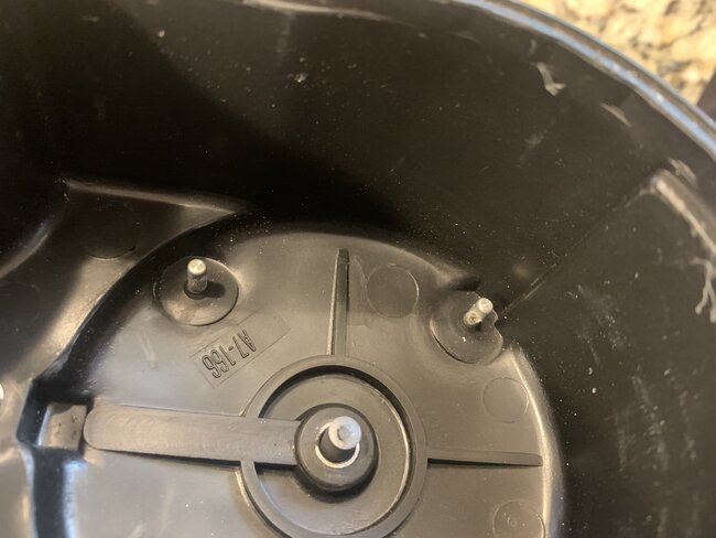

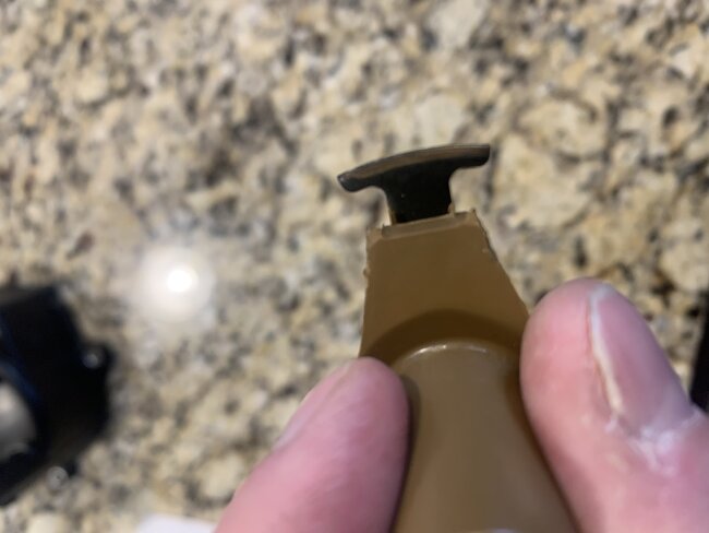

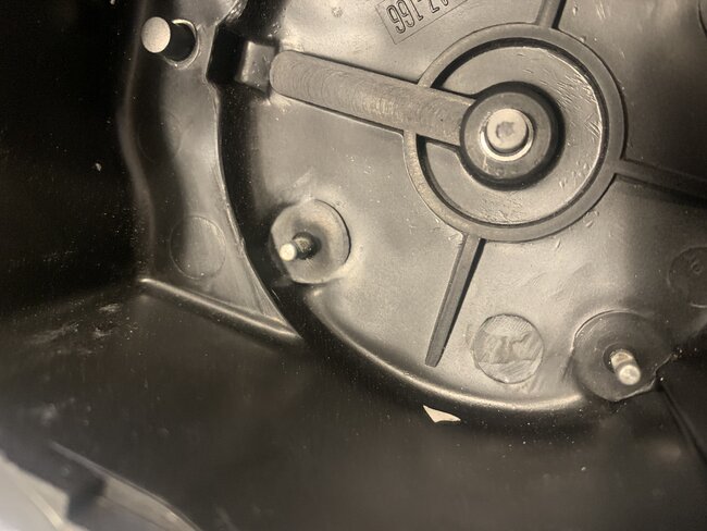

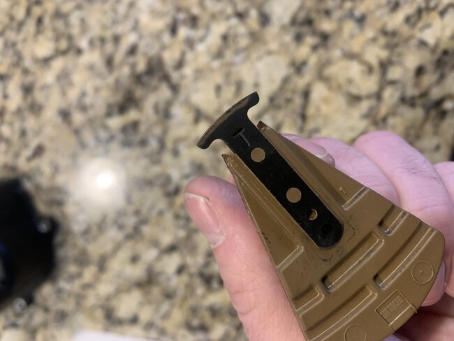

I pulled the distributor cap and rotor off. They weren’t wet but I attached pictures of both. Are the terminals on the cap bad and is the tip of the rotor bad?
Nov 30, 2022 at 1:30 PM
I've seen a lot worse. They should be replaced, but it isn't an emergency. Is the vehicle still running rough? By chance, did you try the carb cleaner test?
