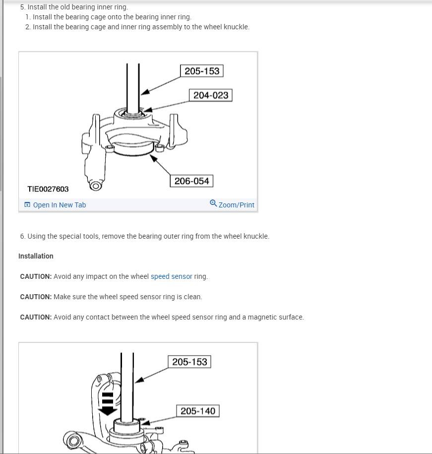

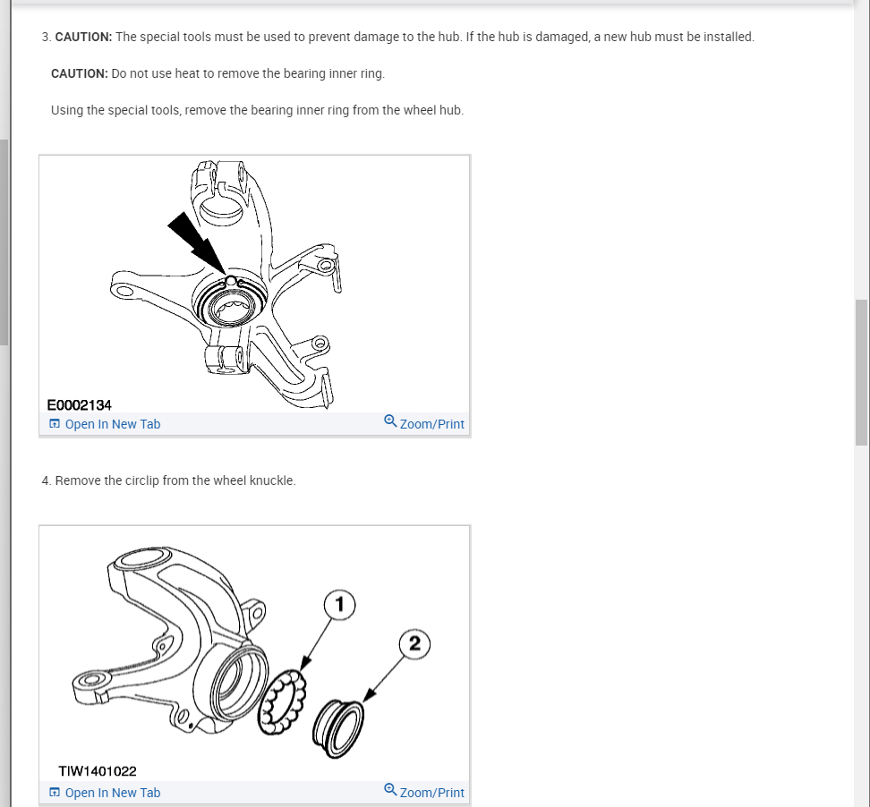

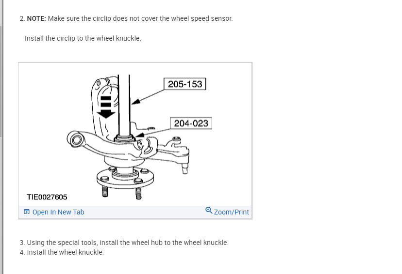

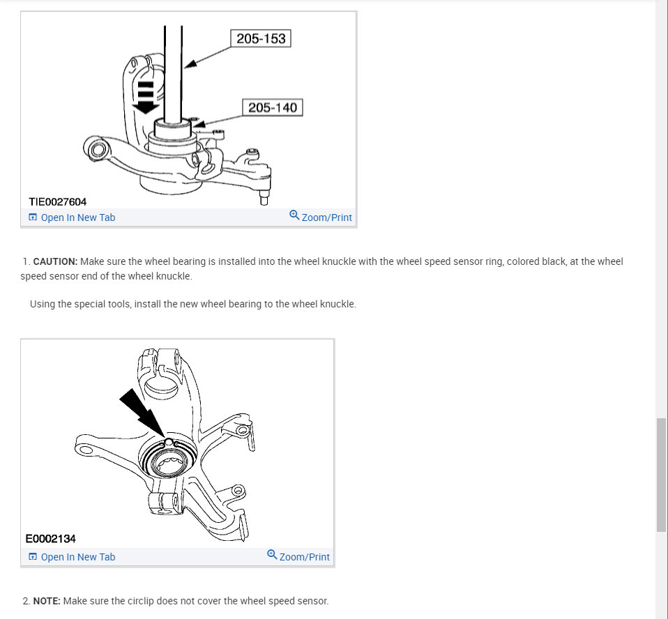

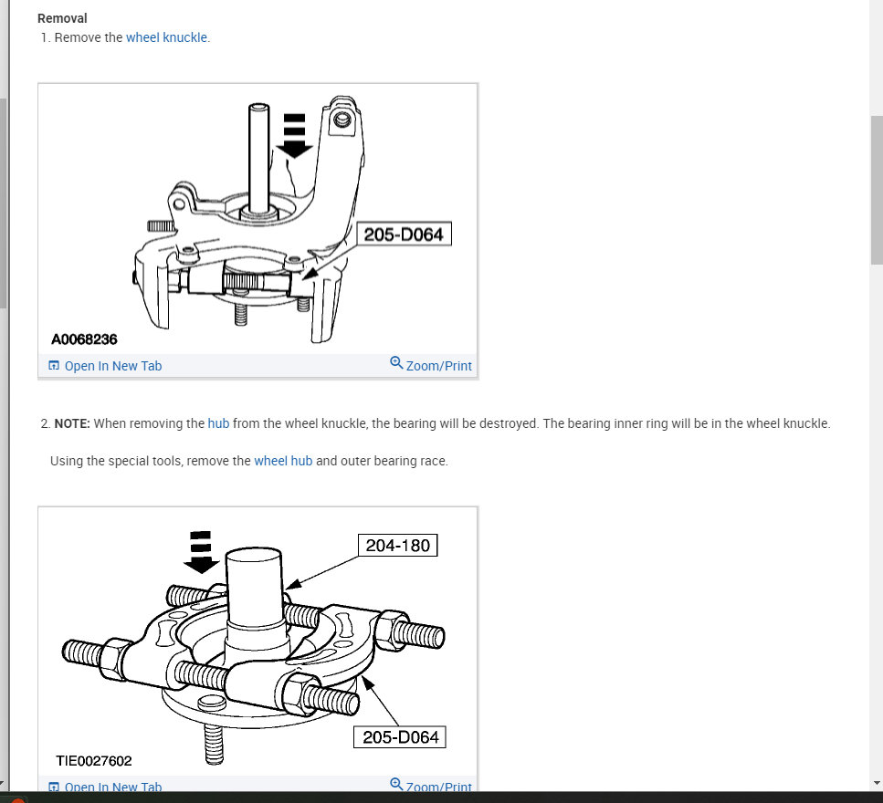

This guide that more detail on this:
https://www.2carpros.com/articles/how-to-replace-front-wheel-bearings-and-seals
https://www.2carpros.com/articles/bearing-hub-replacement
Please run through this info and let us know what other info you need. I attached the info below on how to replace the hub bearing as this is what you asked for and it sounds like a bearing issue.
