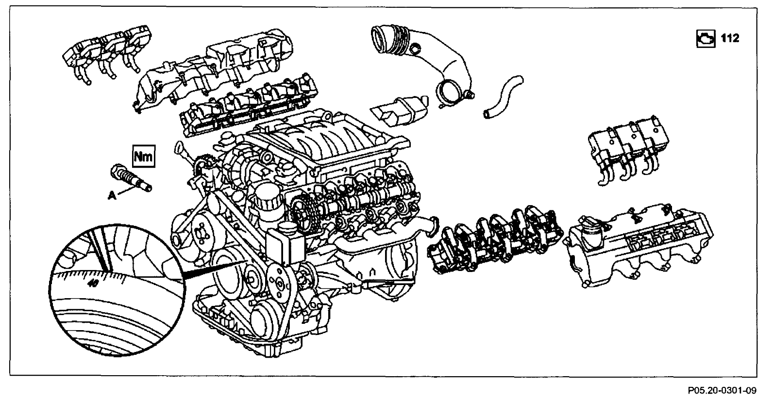

5 Position engine to 40 degrees after TDC of first cylinder.
NOTE:
- Engine must not be cranked backwards.
- The notches of the camshafts must point toward the inner V.
- It must be possible to easily insert the two locking plates. If this is not possible, Set the basic position of camshafts.
- The copper plates of the timing chain must be aligned with the scribe marks on the camshaft sprockets.
- Owing to the unevenly long paths of the timing chain it may be necessary to crank the engine as many as 14 times till the copper plates get aligned with the scribe marks on the camshaft sprockets.
- On vehicles equipped with an air pump, the combination valve must be unbolted before the right locking plate is inserted.
- Installation: Replace Gasket of combination valve.

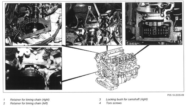

10 Install holding bush (3) onto camshaft on right
NOTE: Screw in bolts (4) only until they touch.
11 Attach retaining devices (1, 2) for timing chain to right and left cylinder head
12 Separate timing chain
CAUTION: Cover over timing case recess with a clean cloth. Parts which have dropped into the timing case recess, must be removed.
