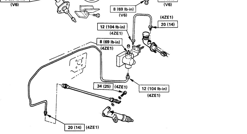

There is a bleeder screw on the slave cylinder down by the bell-housing.
The procedure is below.
