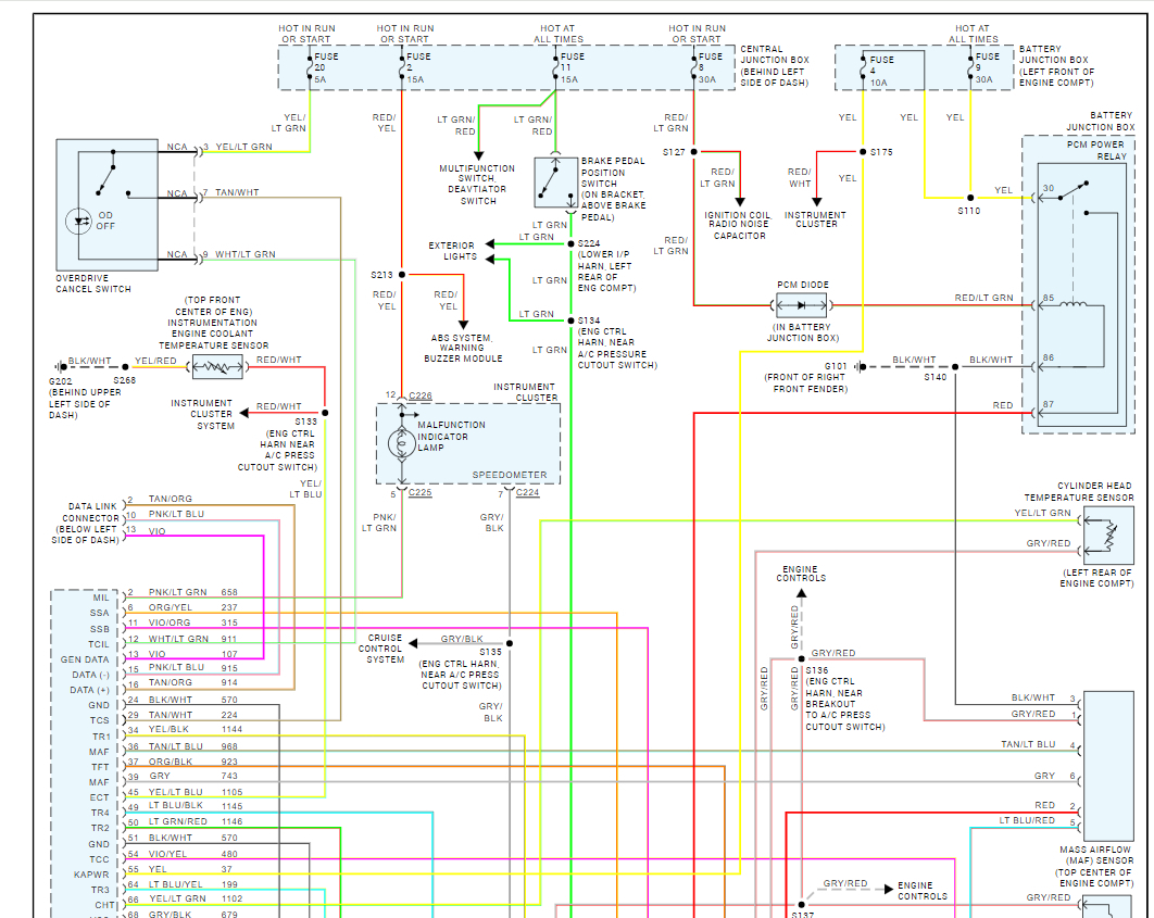

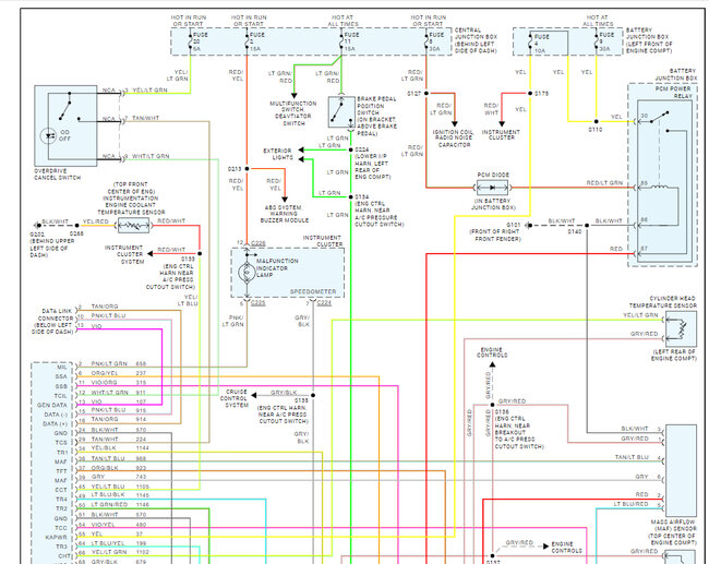

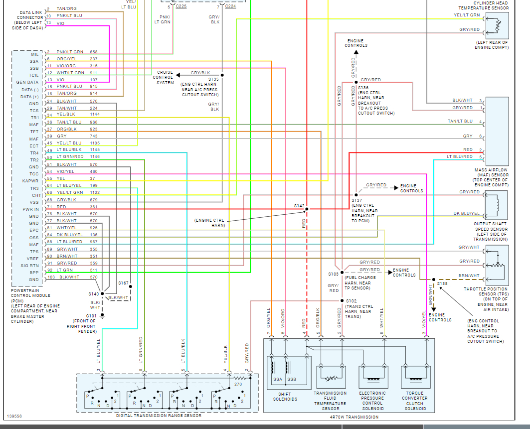

There are also 6 fuses that run the system I would check those as well, here is the transmission wiring diagrams which show which fuses to check, check out the images (below). Let us know what you find.
