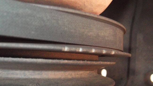

I need to know what the timing should be set to and what the different (5) marks on the pulley means/values. Also should i disconnect anything before setting the timing. I have experience in setting timing and have all the timing equipment.

we do not have that model here we have a frontier and it is at 18-22BTDC. we do not have a listing for your vehicle and no pictures on timing marks, so this may be totally wrong.

Can you send a picture of what you need, maybe I can find it that way.

Hello, thank you here are some pic's.

A old trick i use on older cars is to set the timing with a vacuum gauge, find the best (highest) manifold vacuum reading by advancing and retarding the ignition, i would be looking at around 5-8deg BTDC make sure all tune items are ok, valve clearances are correct if they are adjustable and do fine adjustment on road test, i will also look into finding the correct setting as well.
