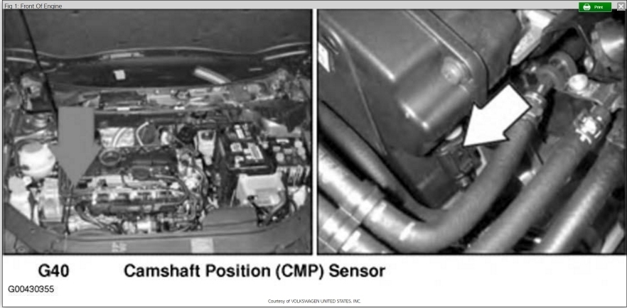

Yes it could be the CMP (CaMshaft Position) sensor but, it is also possible the timing belt was not installed correctly, if the camshaft timing is off it will set code: P0348 (VAG# 16732)
Test:
1. Access the Camshaft Position (CMP) Sensor G163 located on the back of Bank 2 cylinder head. (Between the cylinder head and bulkhead.)
A. Pin 1 Red/Black (RO/SW) is a 5 V power source.
B. Pin 3 Black (SW) is the sensor ground.
C. Pin 2 Yellow/Black (GE/SW) is the signal wire. 11 V should be present coming from the Engine Control Module (ECM) to the sensor. While the engine is cranked over (or running) there should be a clean cut square wave patter that drops from 11 V all the way to ground.
NOTE:
Use of the Cam Bar, a (special tool) is required to verify timing belt timing. Once the timing belt has been verified, removal of the valve covers to verify timing chain timing would be required. All timing marks (belt and chain) must line up together.
