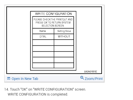

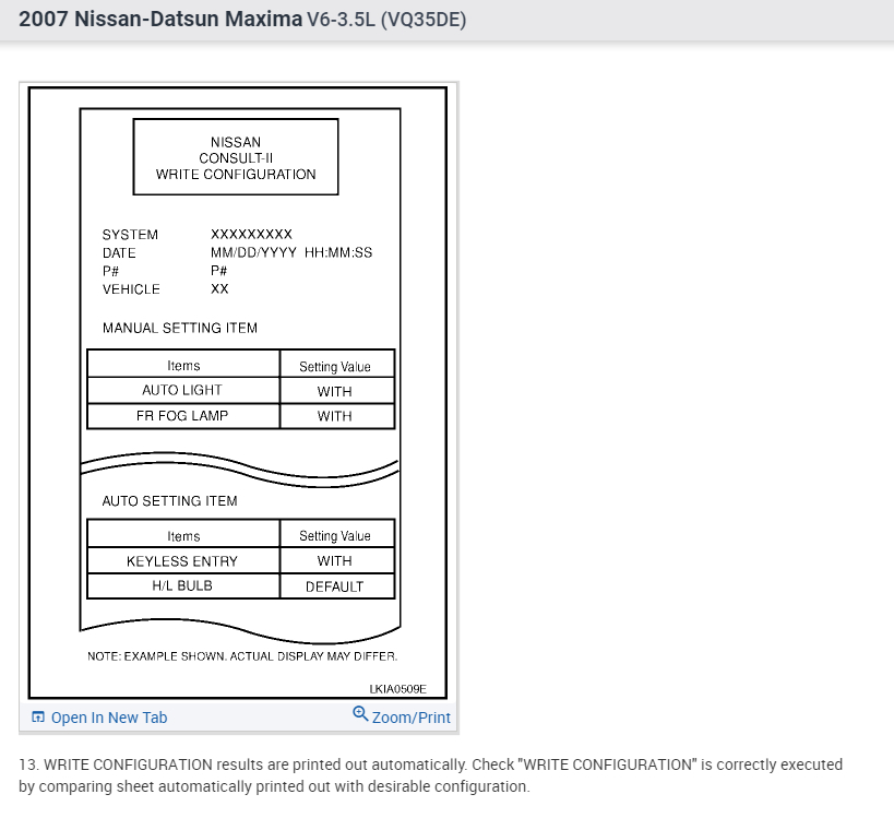

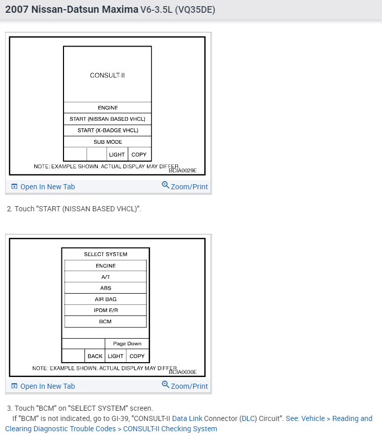

Depending on the manufacturing date, usually located on the driver side door, there are 2 BCM part numbers.
To 10/06 284B1ZK30A
From 10/06 284B1ZE50A

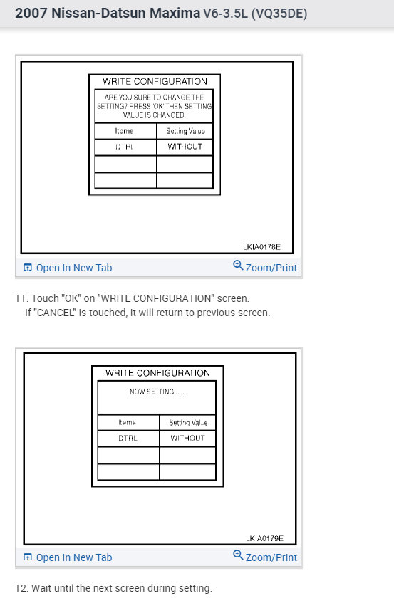

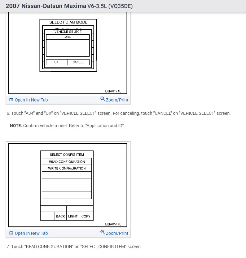

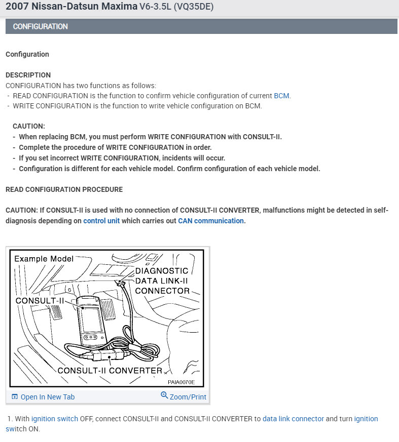

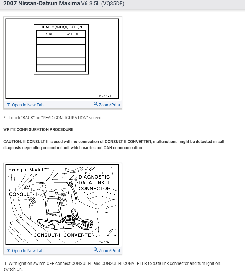

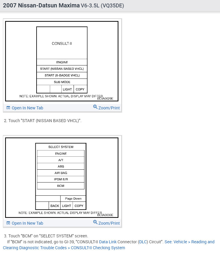

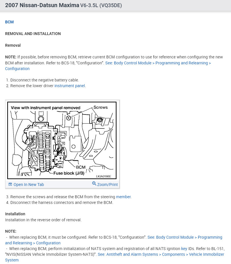

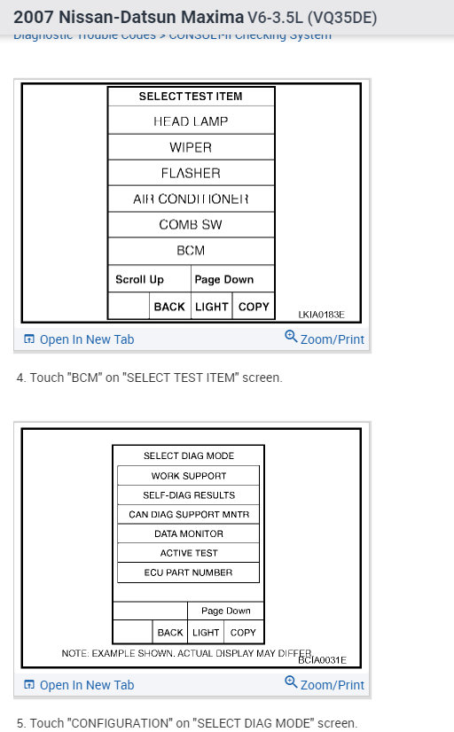

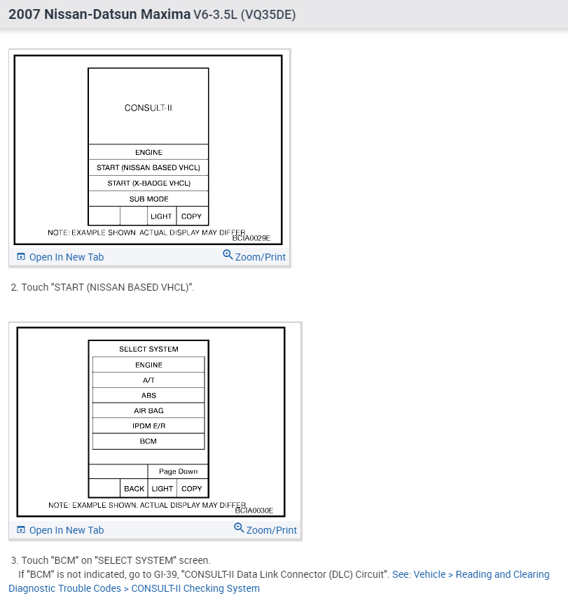

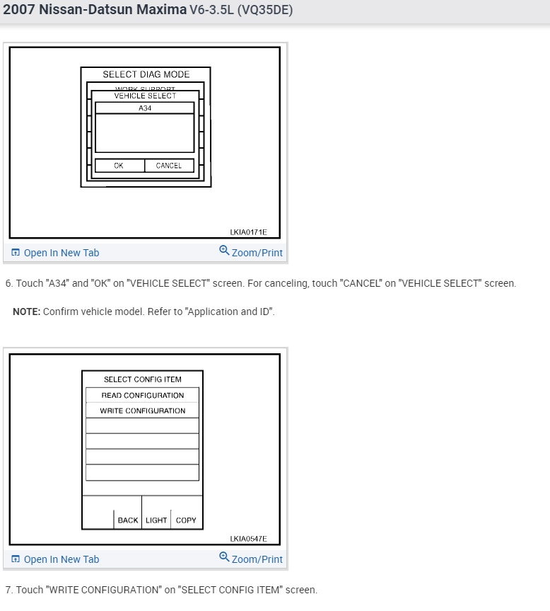

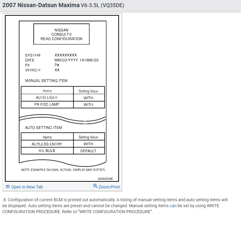

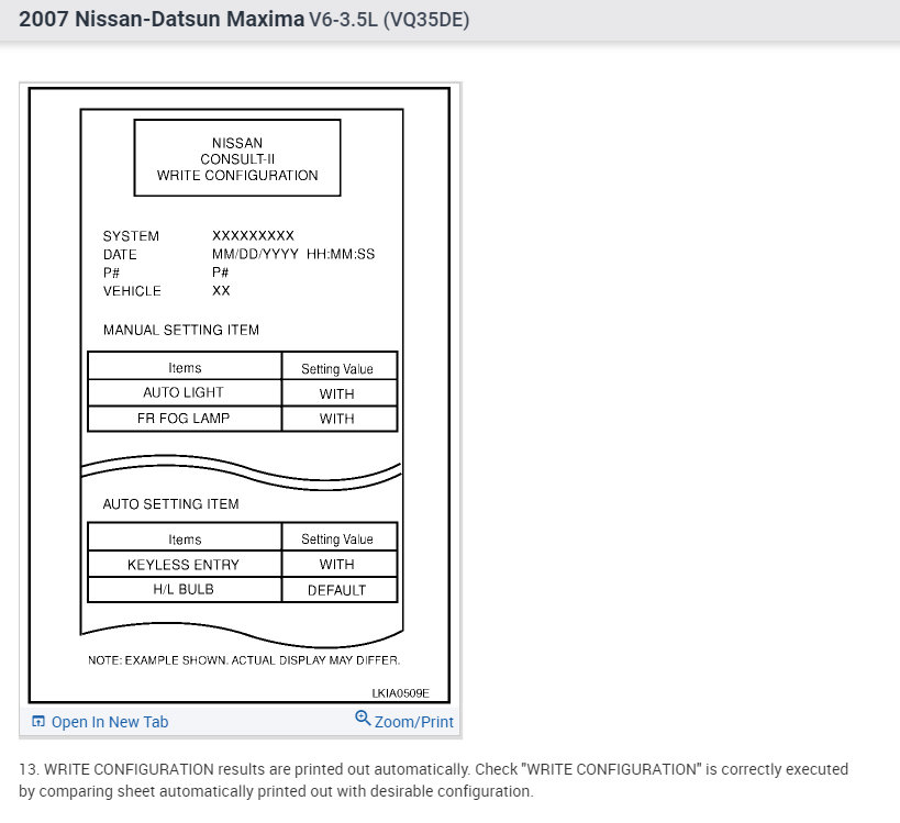

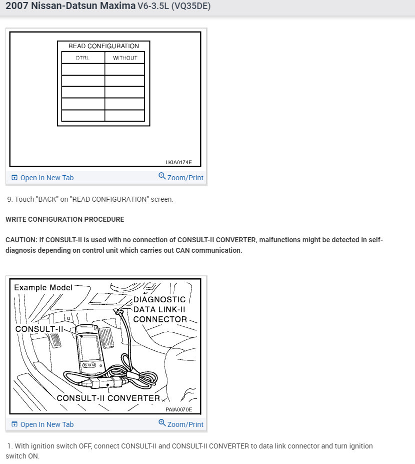

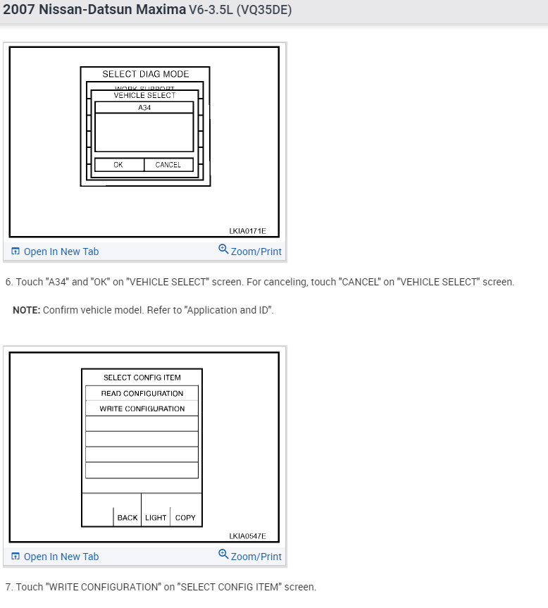

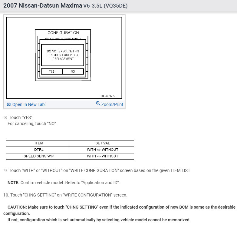

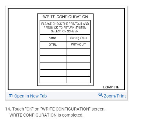

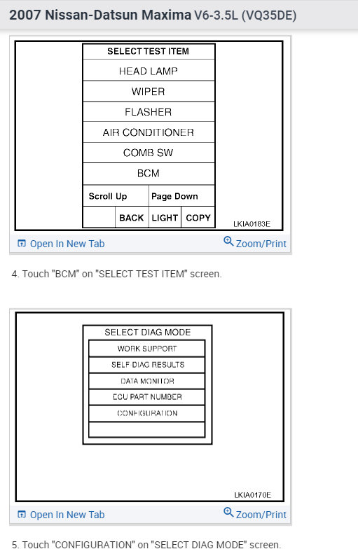

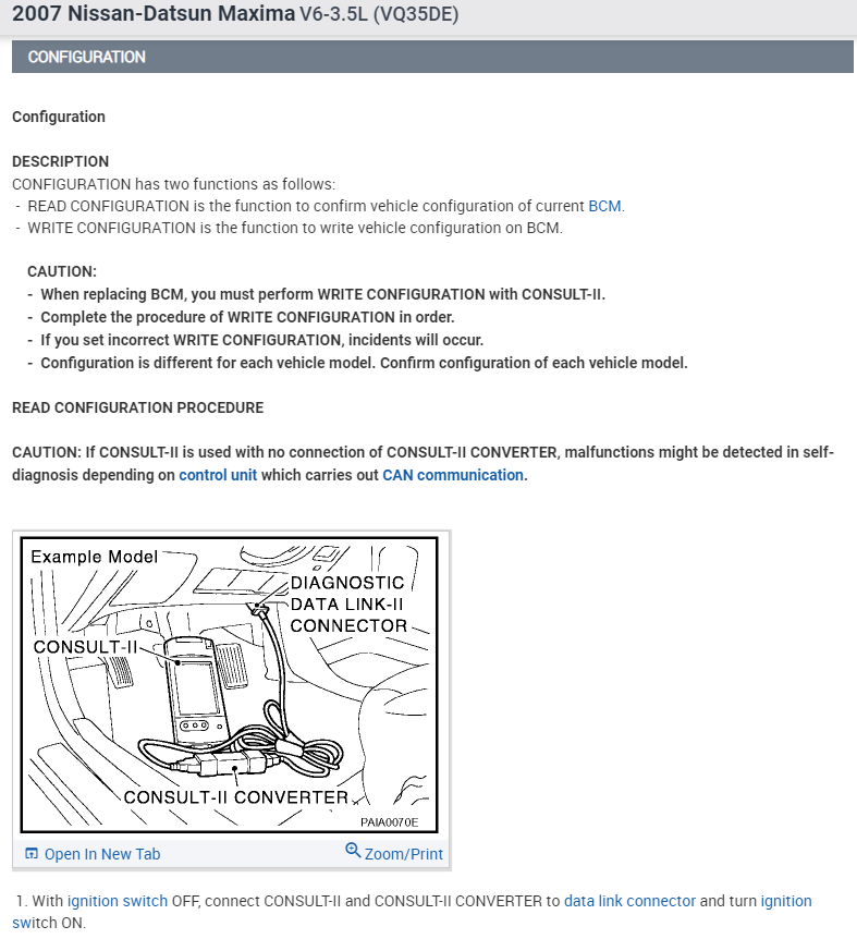

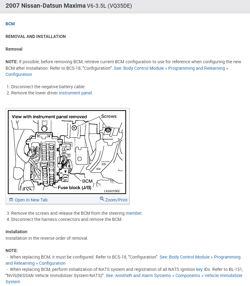

I have attached the BCM relearning process below for your reference.
Let me know of any questions.
Thank you.
