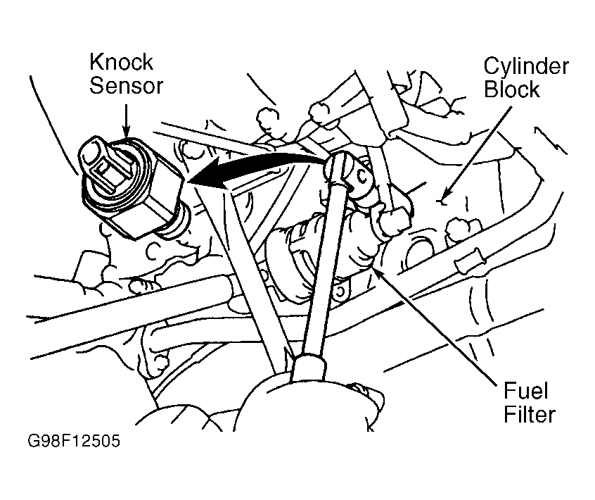

i cannot find the location of the knock sensor.

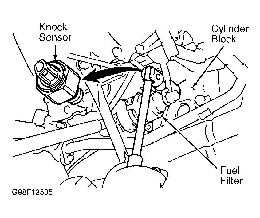

On the side of the block, near the fuel filter. Below is a diagram.You will have to remove the starter. You may also have to remove the fuel filter mounting bolts. Check out the diagrams (Below). Let us know what happens and please upload pictures or videos of the problem.
