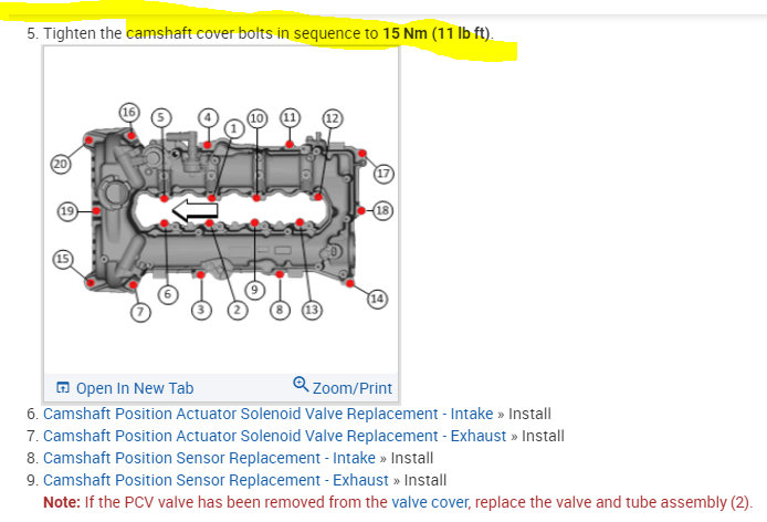

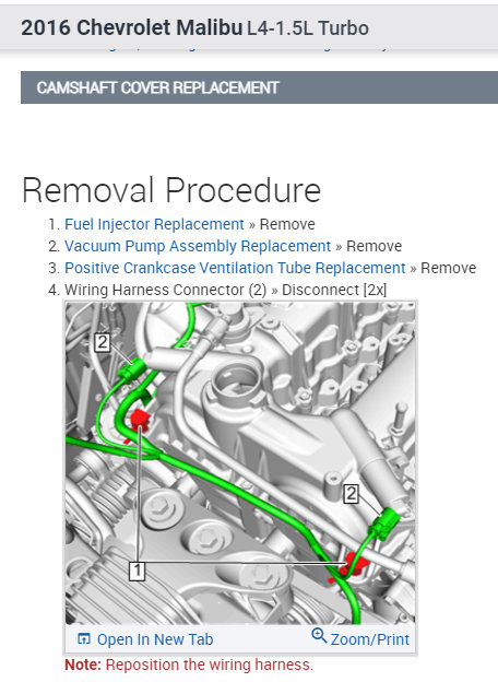

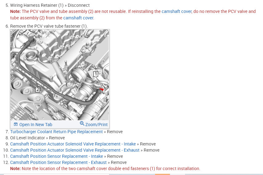

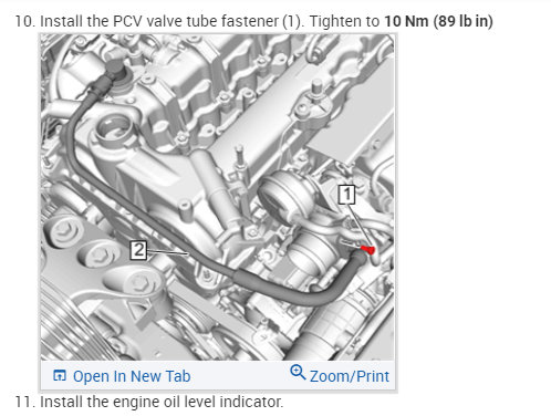

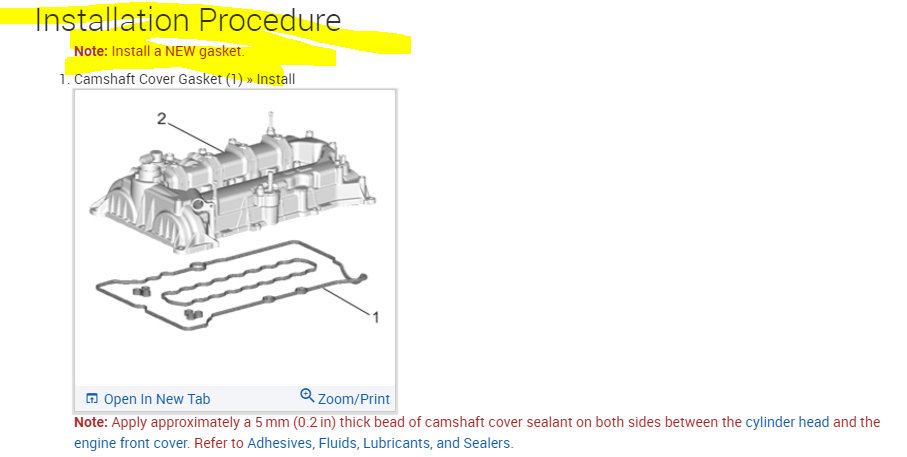

I had a brake vacuum pump break off into the valve cover, got it all apart now ready to put everything back together. I just need the Sequence and torque settings for the valve cover for the car listed above. Thank you!
