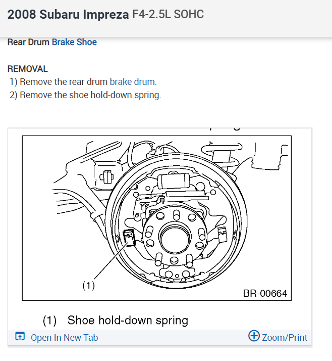

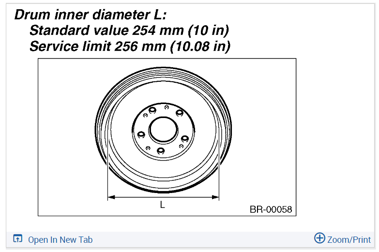

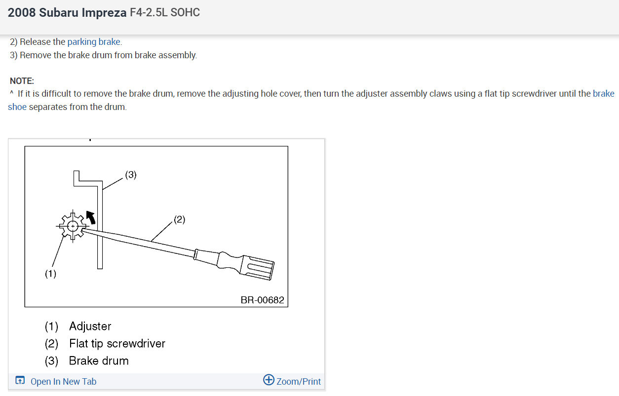

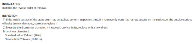

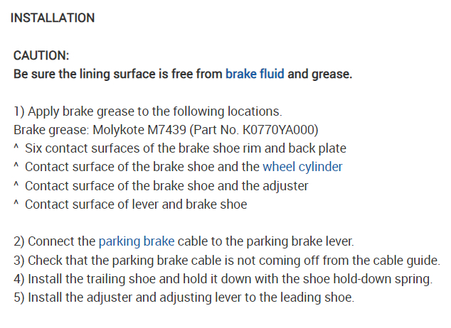

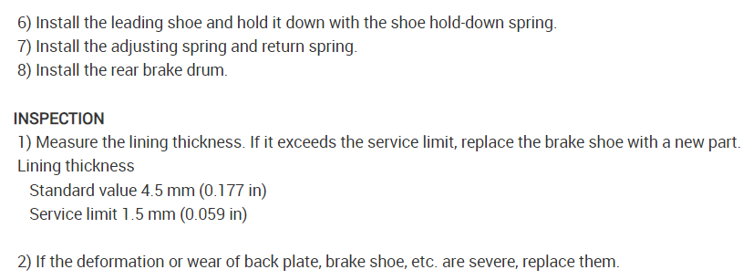

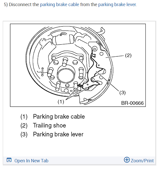

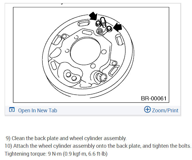

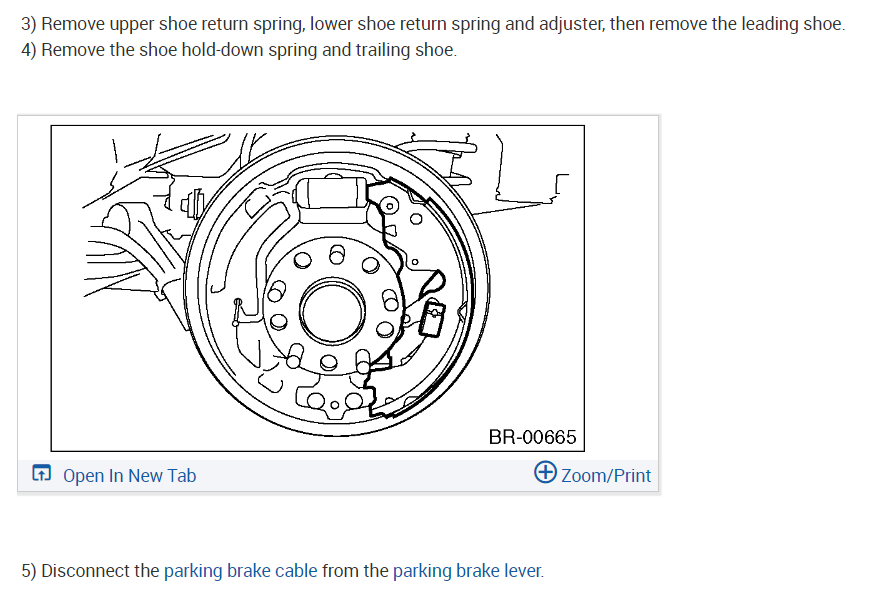

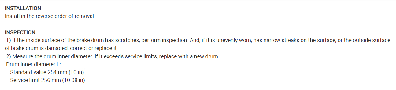

That will depend on the sub model, WRX or WRX STI or the regular Impreza? Here are the part numbers for the regular Impreza.
Drum 26740FG000 $137.30
Wheel Cylinder 26705FG000 $55.28
Shoes 26694FG000 $99.95

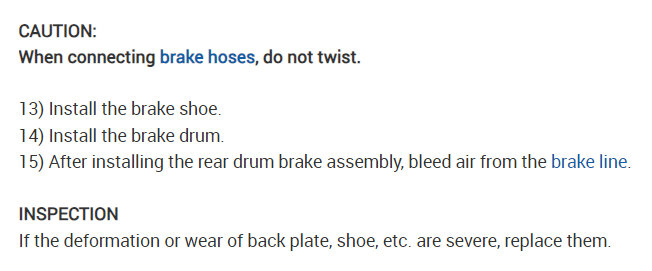

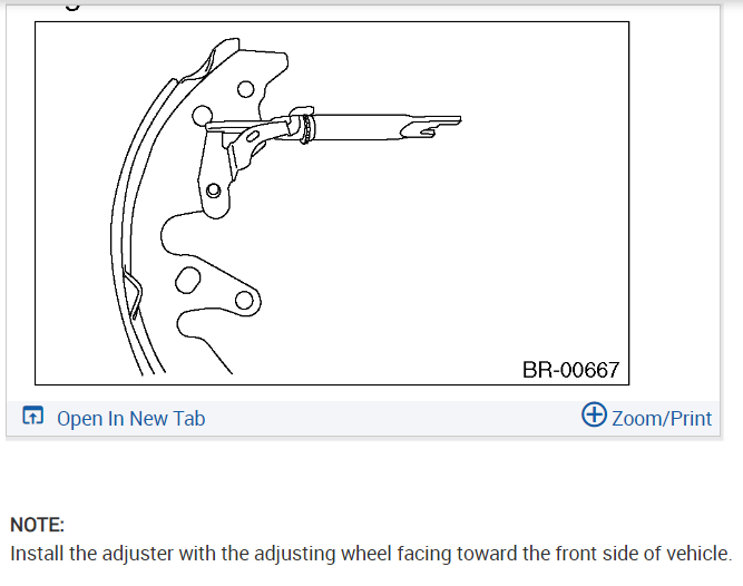

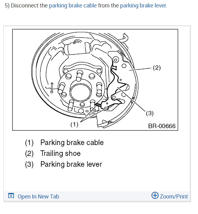

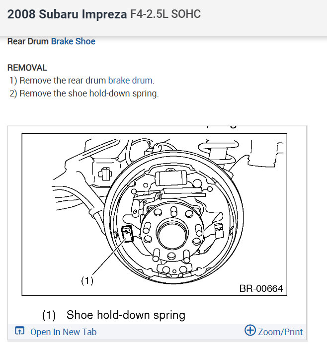

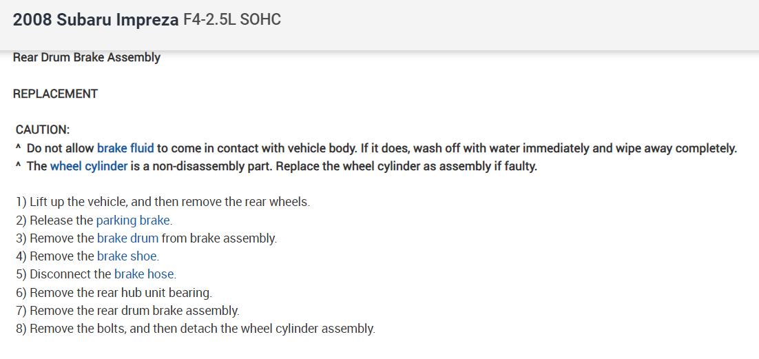

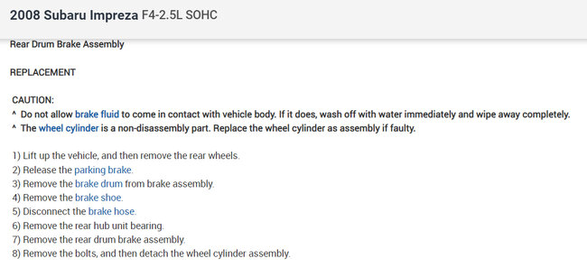

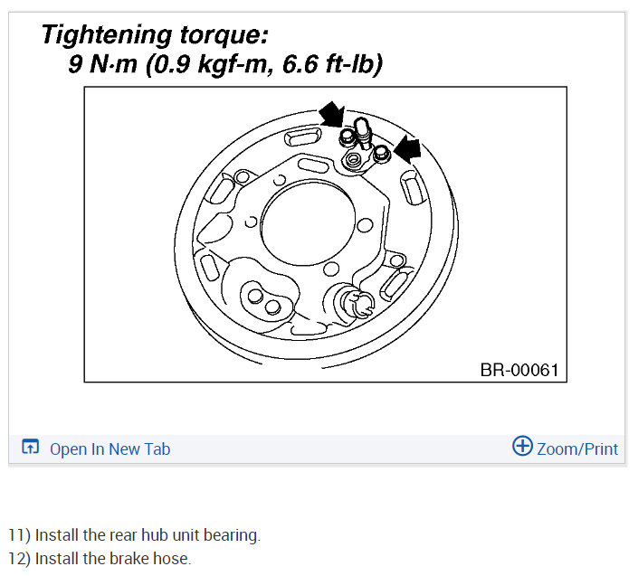

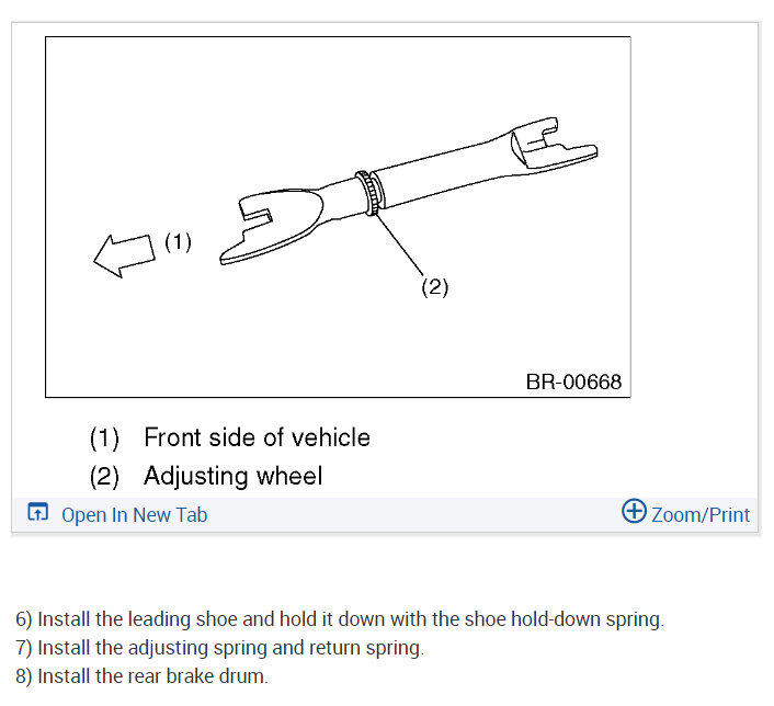

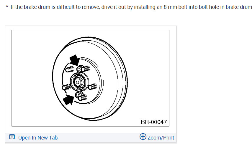

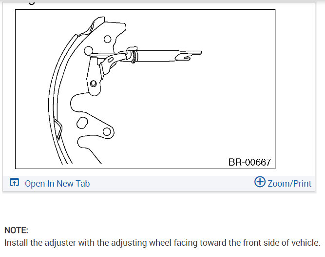

Here is how the job is done in the images below. Also, this generic guide can help as well:
https://www.2carpros.com/articles/how-to-replace-rear-brake-shoes-and-drums
and
https://www.2carpros.com/articles/how-to-replace-a-wheel-cylinder
Check out the images (below). Let us know how it goes.
