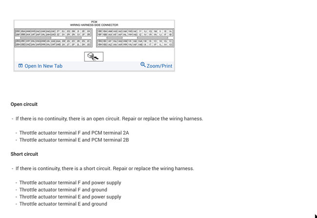

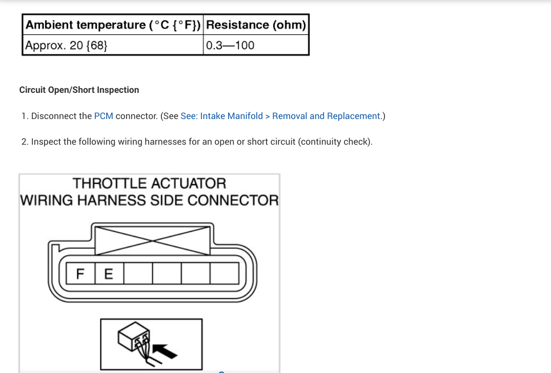

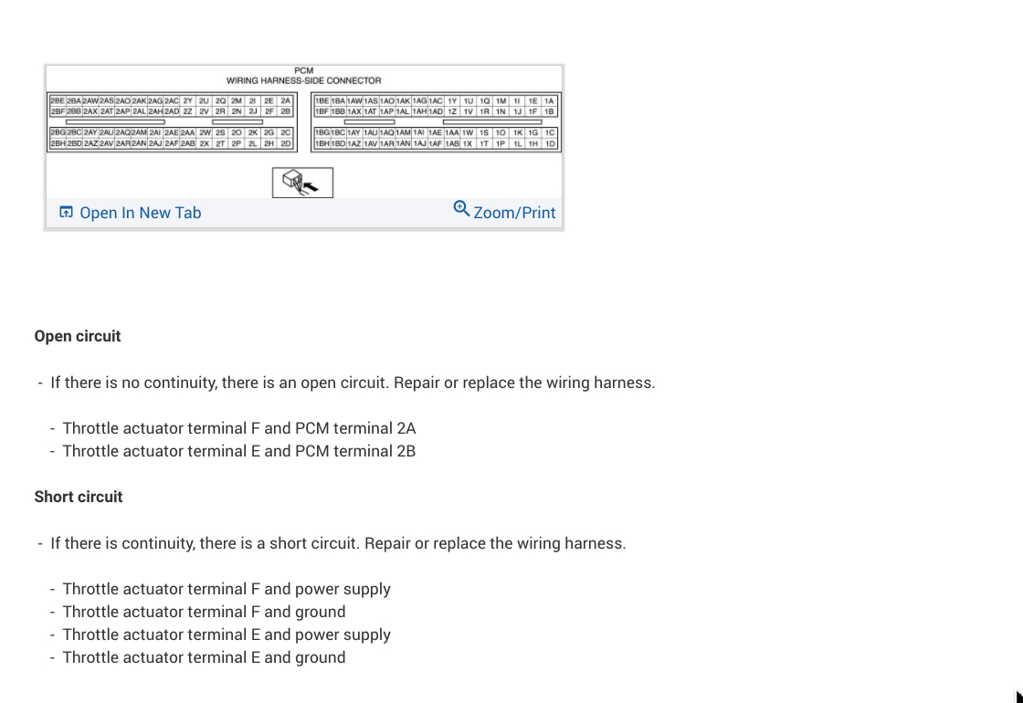

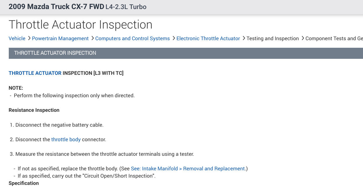

In the diagrams down below I have included the diagnostic troubleshooting guide for the throttle body from the vehicle manufacturer for your vehicle. Please go through this guide and get back to us with what you are able to find out. You will need to use a Digital Multi-meter [DMM] to go through this guide, so here is a link below explaining how to use on, if needed:
Thanks,
Alex
