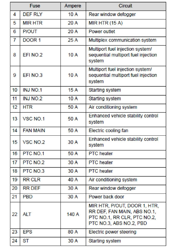

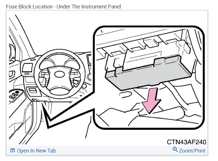

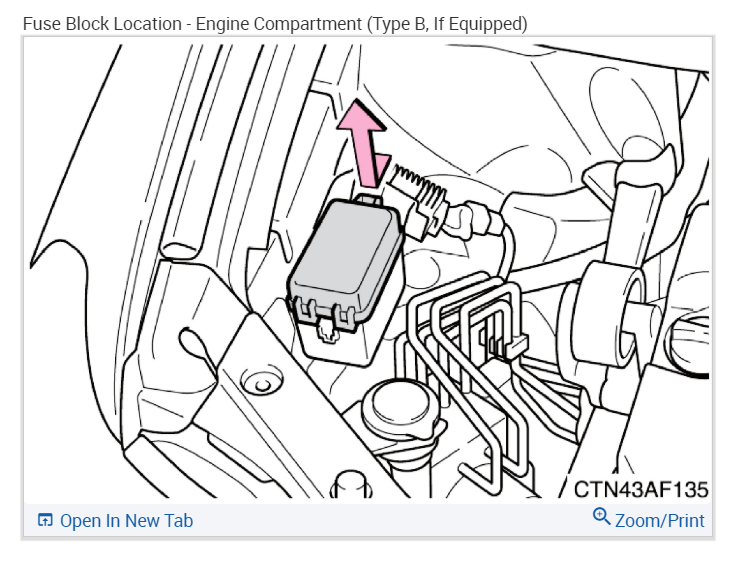

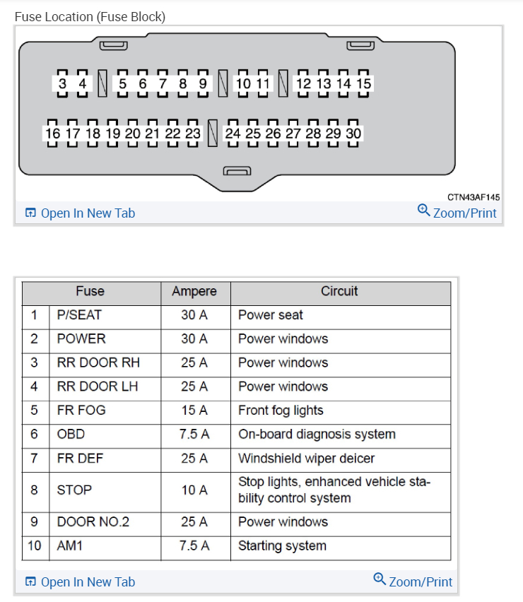

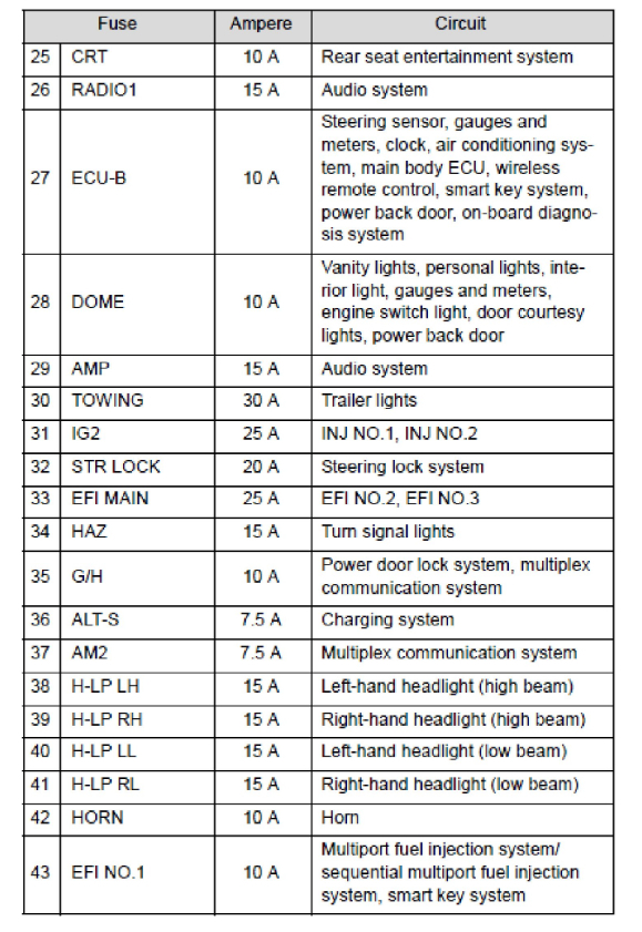

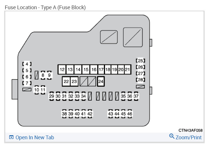

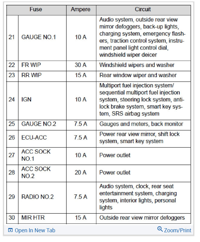

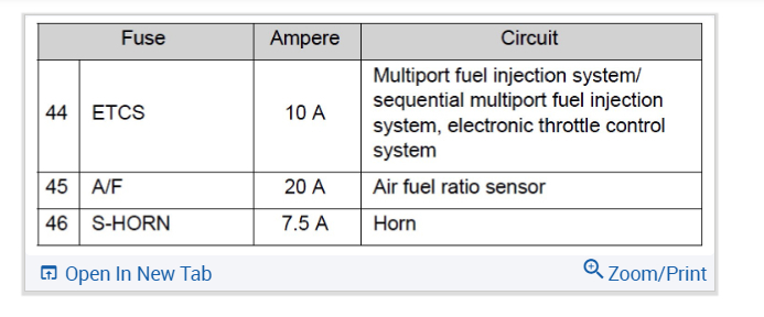

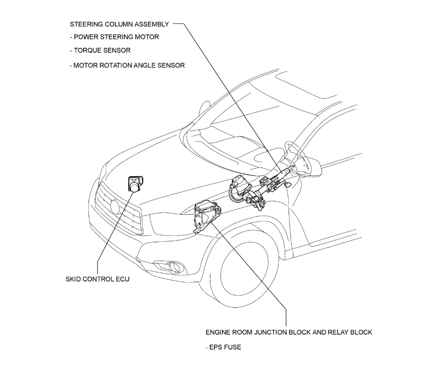

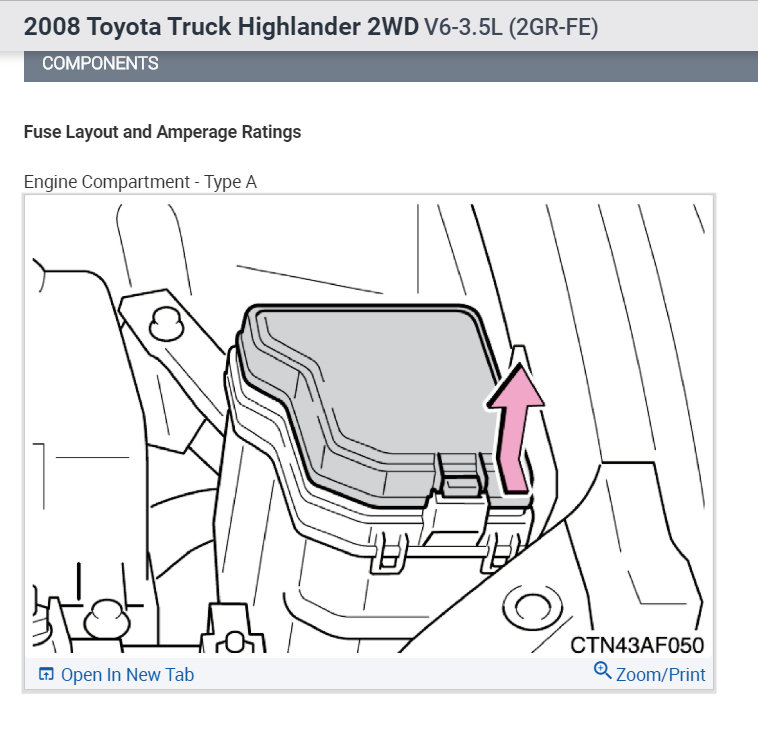

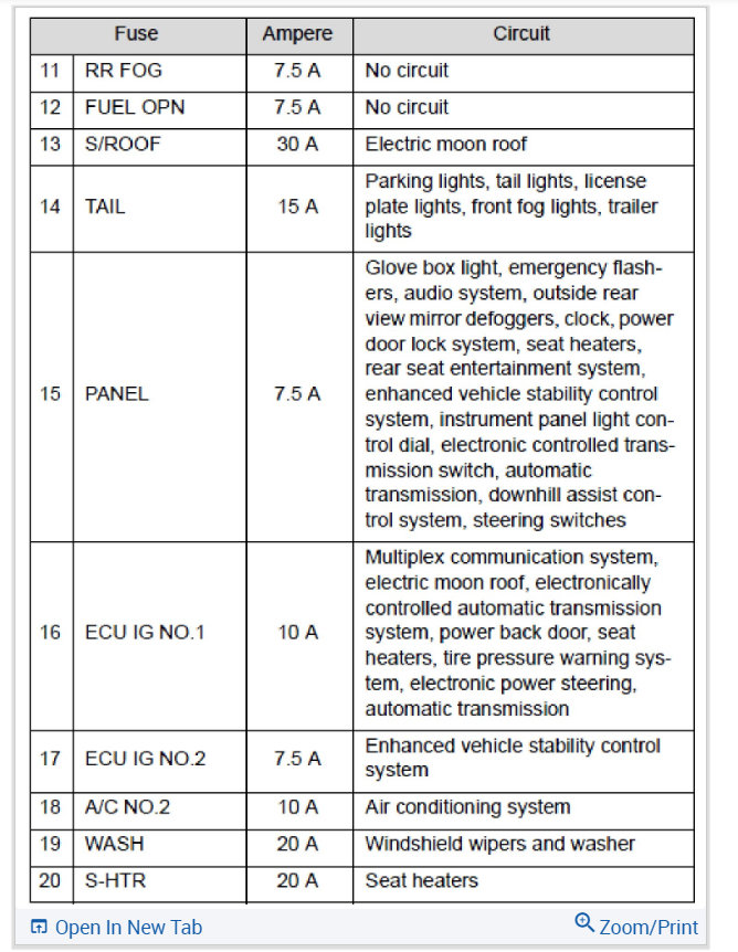

These cars have an electric steering motor which is sounds like you popped a fuse #23 80 amp for the system. Lets be sure and check the fuse. here is a guide with the fuse locations and a diagram of the steering system so you can see how it works below:
Please have the key on and check all fuses to be safe. Check out the diagrams (below). Please let us know what you find. We are interested to see what it is.
