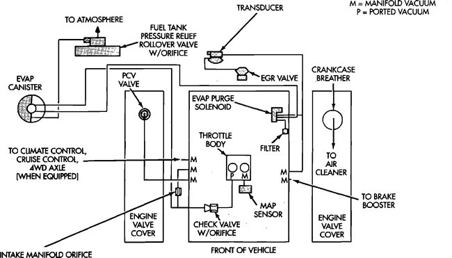

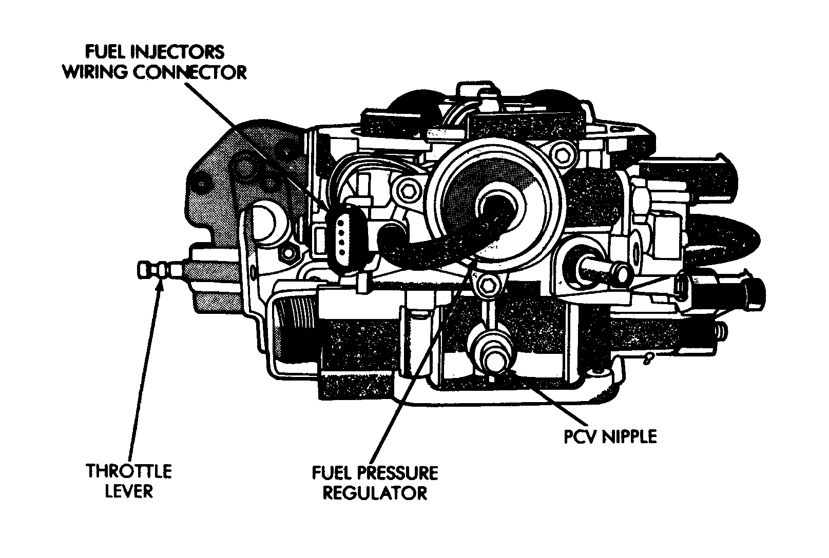

As far as the vacuum schematics, I attached two pics below. The first shows everything related to the EVAP system. Pic 2 simply shows the fuel pressure regulator's vacuum supply.
