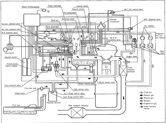

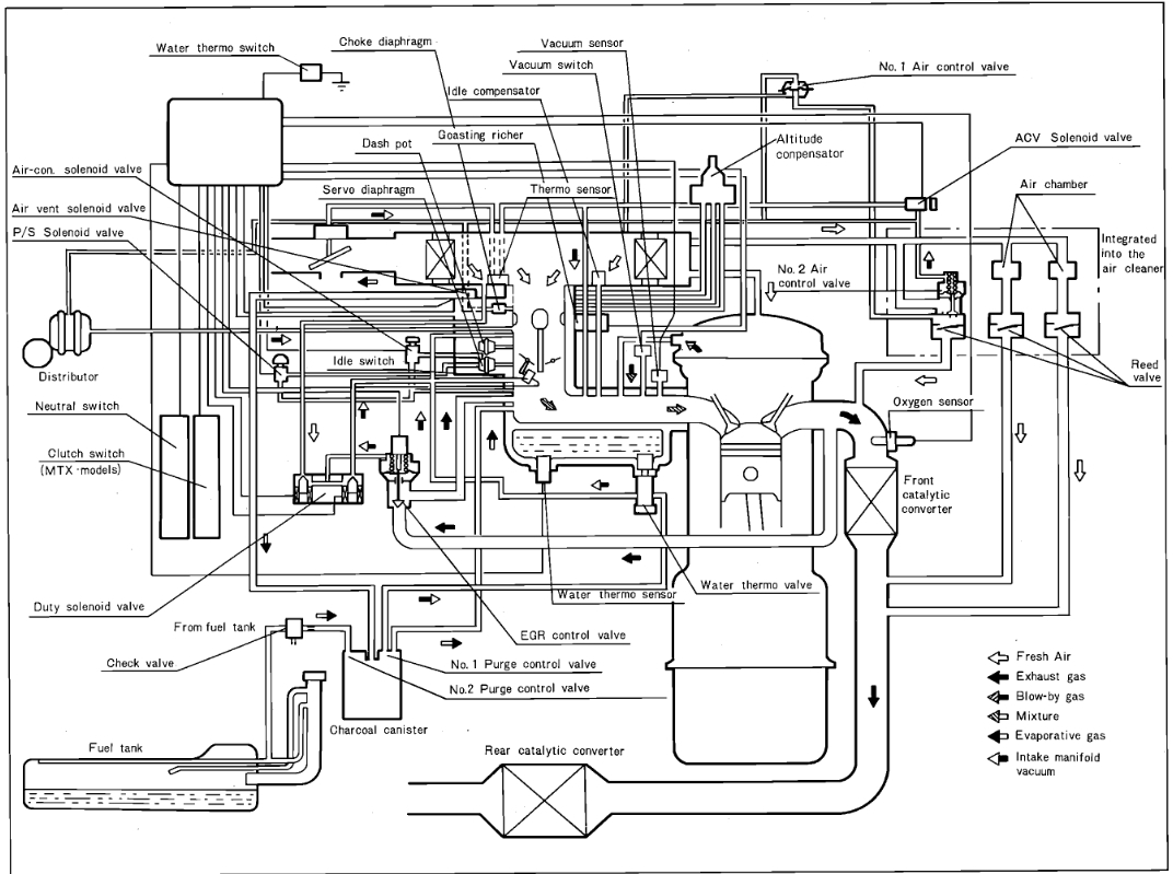

Need a diagram for the carburetor hoses on the vehicle listed above LX hatchback 4d fwd.

Yep, there are many, here are the diagrams for the vacuum lines I found. Check out the images (below). Let us know if you need anything else.
