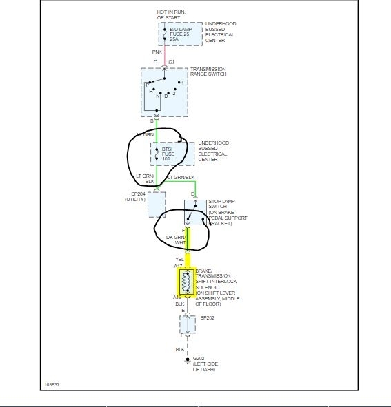

Good afternoon,
Did the replacement switch match up exactly to the old one?
I attached a diagram for you to view. There are 2 fuses for the system. Check them for power on both sides.
Also, check the wire coming out of the stoplight switch to the interlock solenoid.
