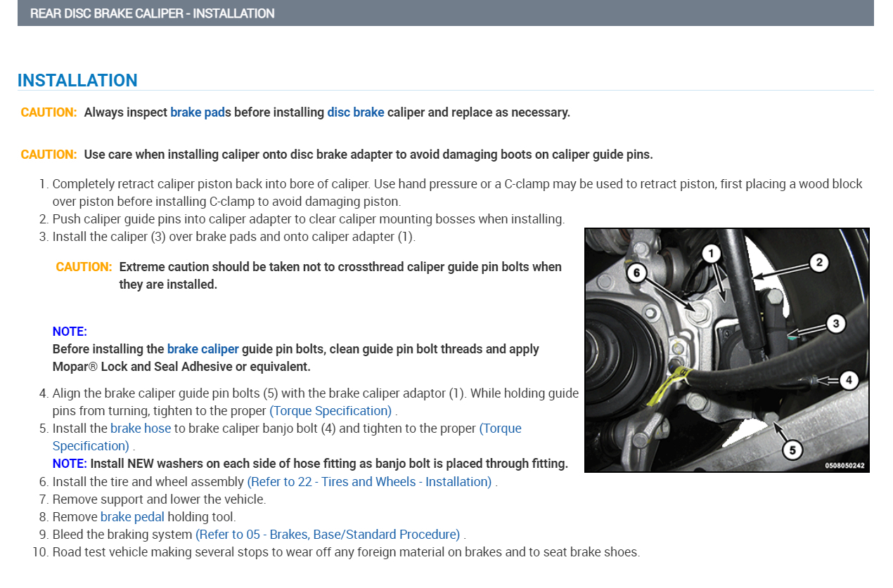

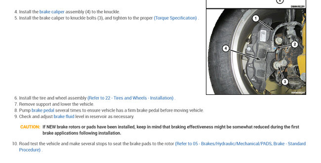

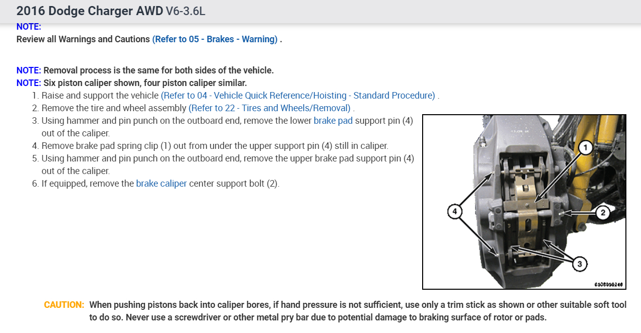

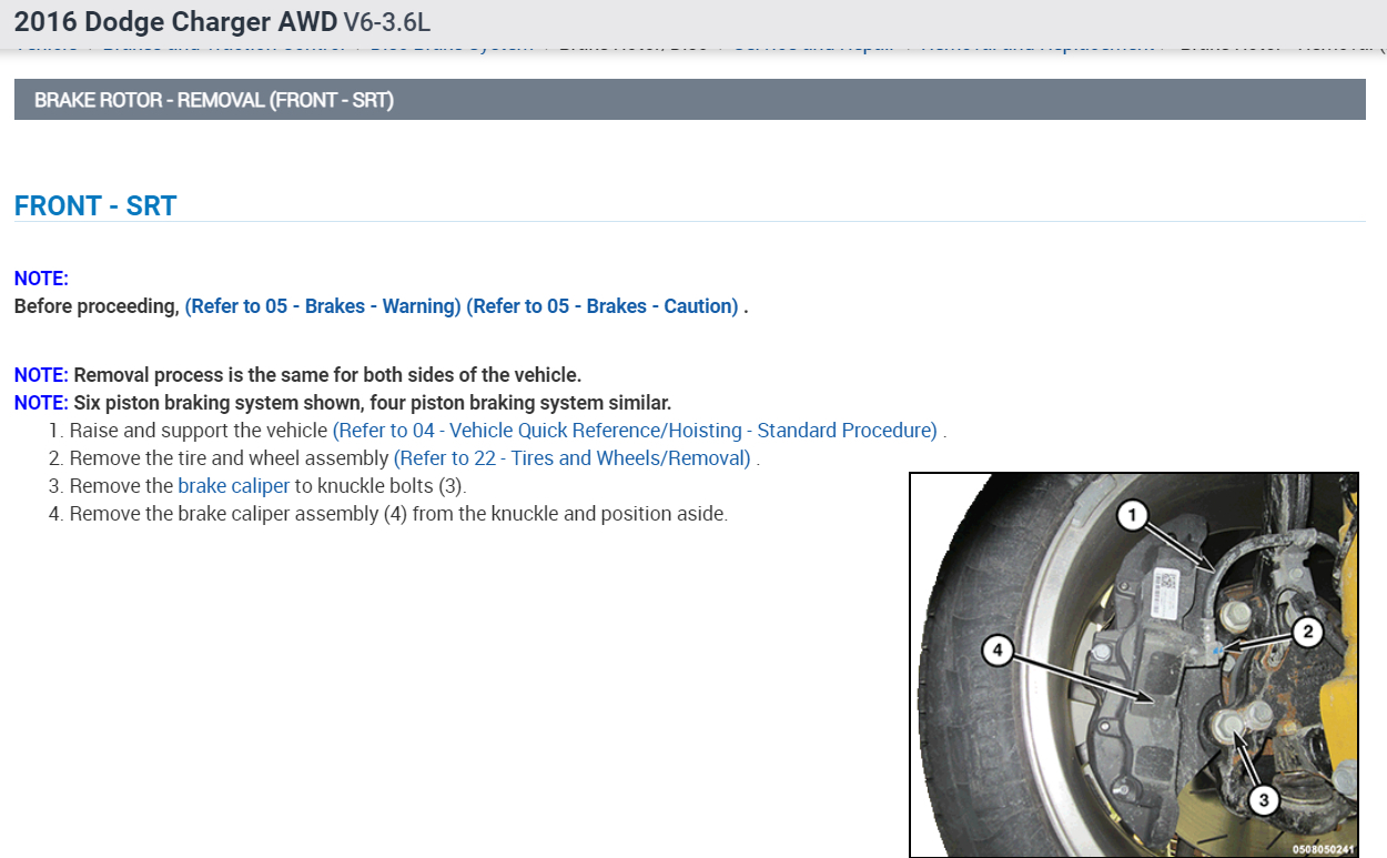

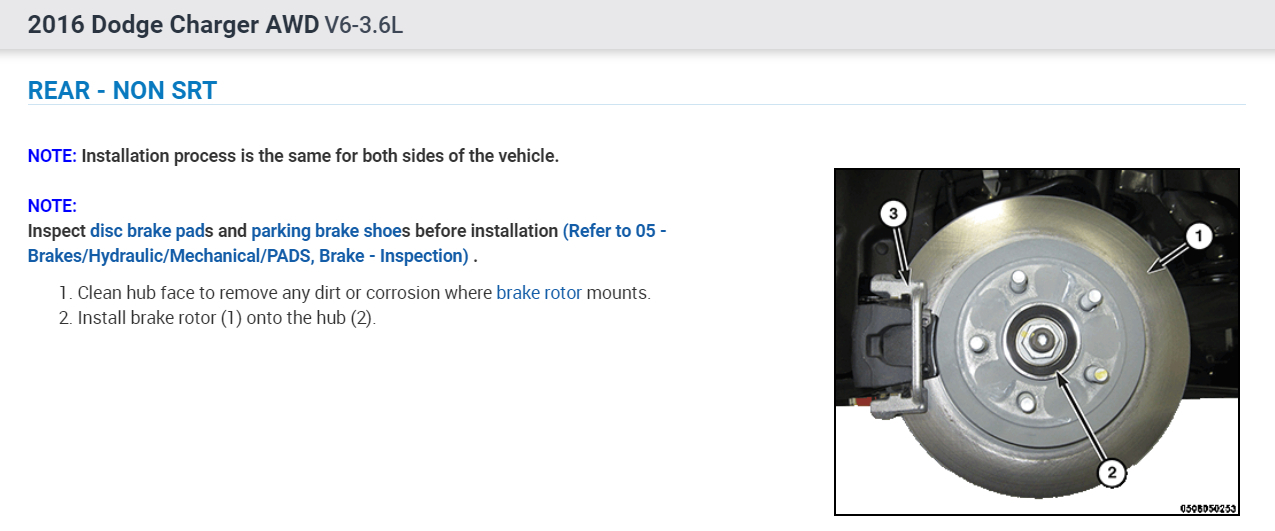

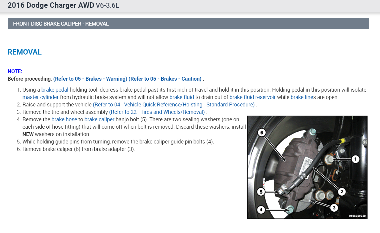

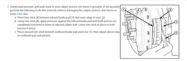

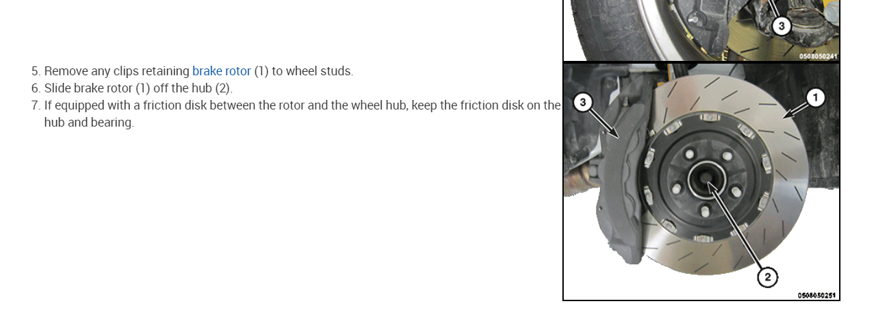

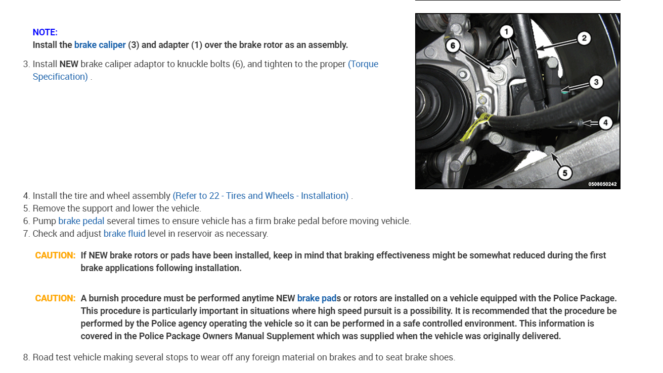

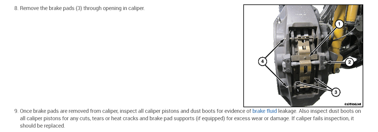

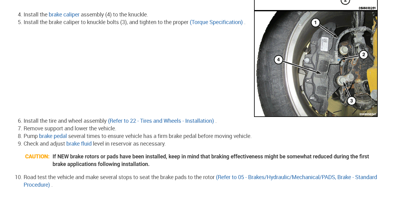

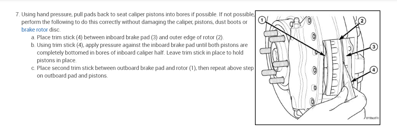

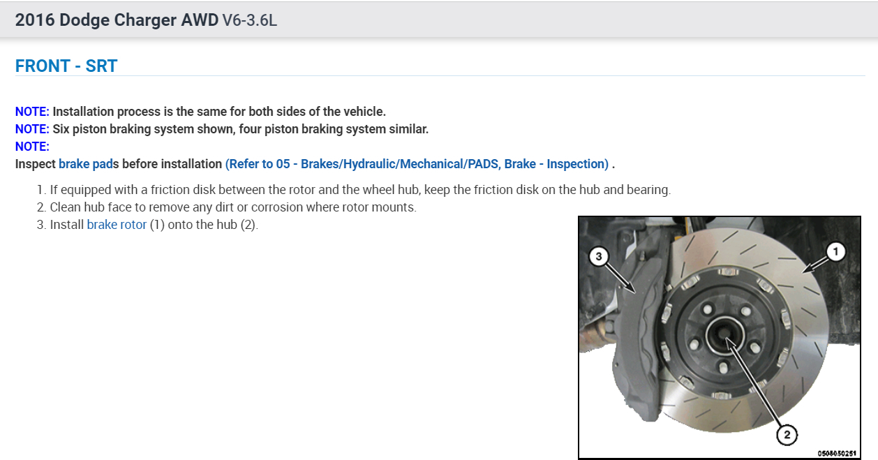

This is not normal, and brakes should never make noise. I would take it to a different shop and have them inspect the brake caliper mounting bolts and the brake pad anti-rattle clips. Here are how the front and rear brakes are installed correctly in the images below. This is for both SRT and regular brake systems. Can you please shoot a quick video with your phone so I can hear the noise? That way I can tell for sure what's going on. You can upload it here with your response. Check out the images (below). Let us know what happens and please upload pictures or videos of the problem so we can see what's going on.
