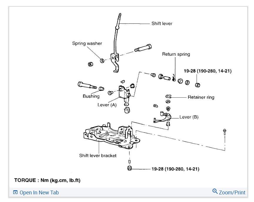

I have full travel on the stick but does not engage either gear.
Oct 22, 2018 at 7:17 PM

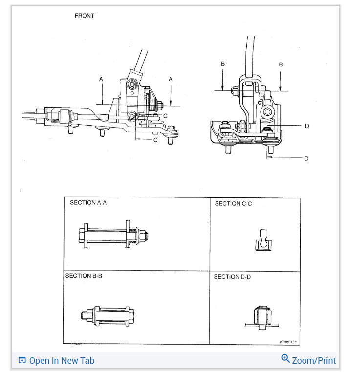

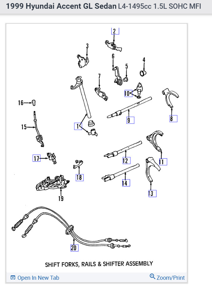

It sounds like the shift cables have worn out here are diagrams to help you confirm and replace the cables. Check out the diagrams (Below). Please let us know what happens.
