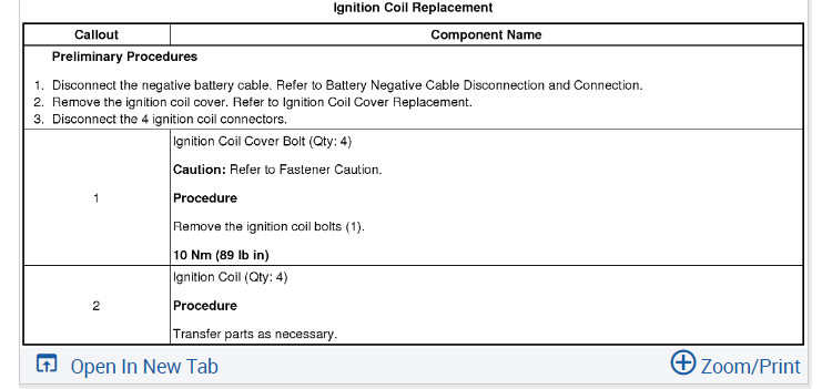

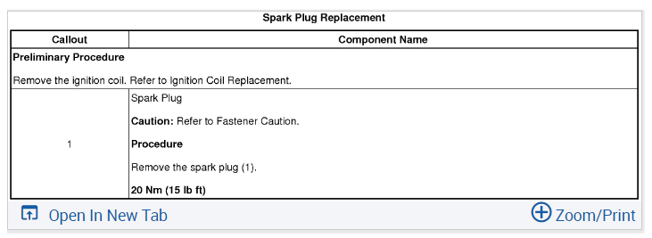

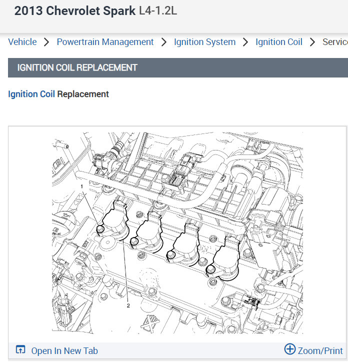

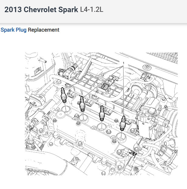

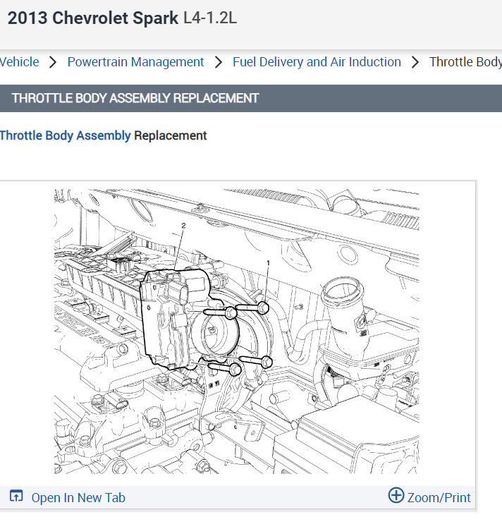

I would start with an engine tune up including the spark plugs and ignition coils and then clear the codes. Here is a generic guide to help you step by step with instructions in the diagrams below to show you how on your car:
https://www.2carpros.com/articles/how-to-change-spark-plugs
ACDelco 41-121: This is the original equipment iridium spark plug recommended by General Motors

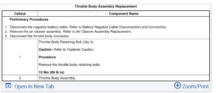

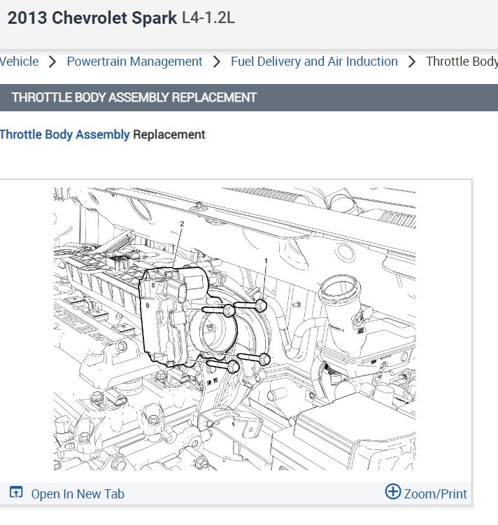

Clear the codes once completed which should fix the problem. I would service the throttle body as well.
Here is a generic guide to help you step by step with instructions in the diagrams below to show you how on your car. Check out the images (below). Let us know what you find.
