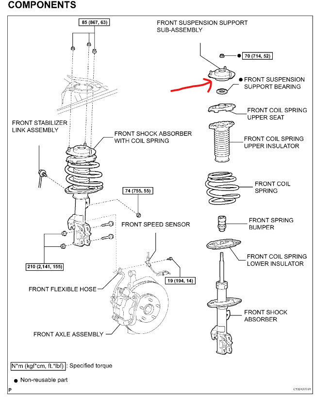

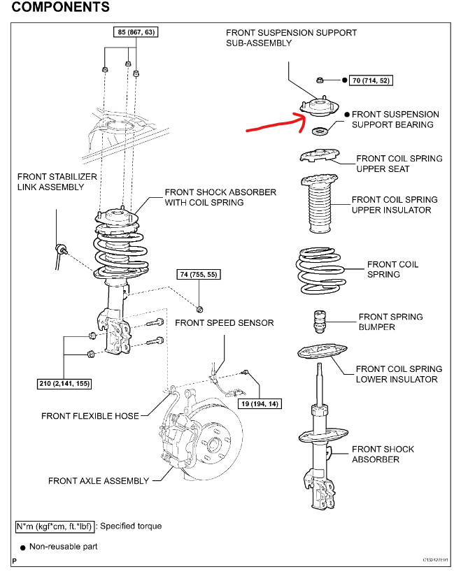

By heavy you mean hard to turn the steering wheel, correct? It sounds like the front strut bearing plates are locked up, I would raise the front of the car up with a jack and then steer the wheel, if it is easy with no strain on the pump, I would replace the front struts. Can you please shoot a quick video with your phone so I can hear the noise? That way I can tell for sure what's going on. You can upload it here with your response. Here is how to change the struts out. Check out the images (below). Let us know how it goes.

They get rusted and lockup. I would try lifting the front of the car to see if the problem goes away.
