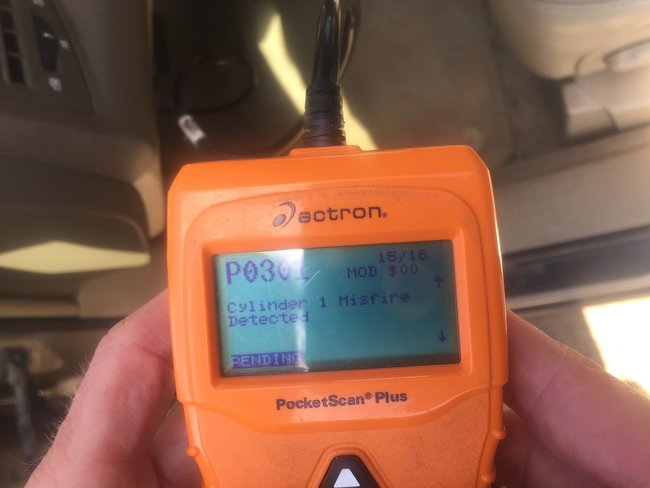

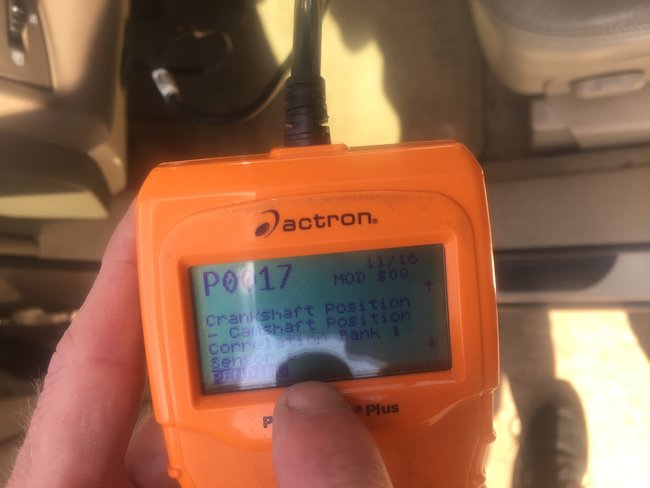

Camshaft position sensor crank shaft position sensor, correlation bank 1. Random misfires and misfire in cylinder 1.

P0301,P0300,P0017,P0014,P1101,P2097. These are all the codes that came up when scanned.
May 14, 2019 at 5:11 PM
Okay, 300 is for a misfiring in more than 1 cylinder. The most common reason is the fuel pump. Low fuel pressure will cause this.

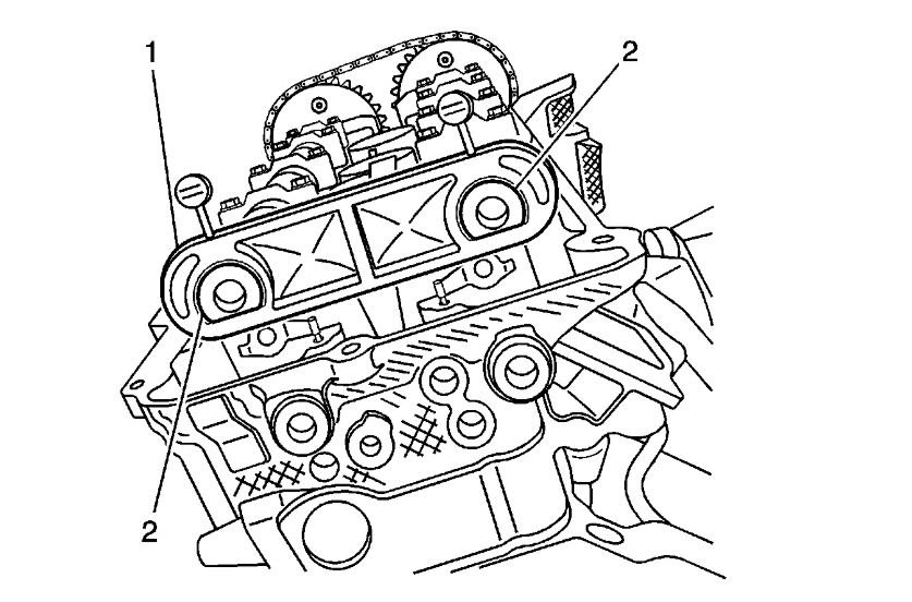

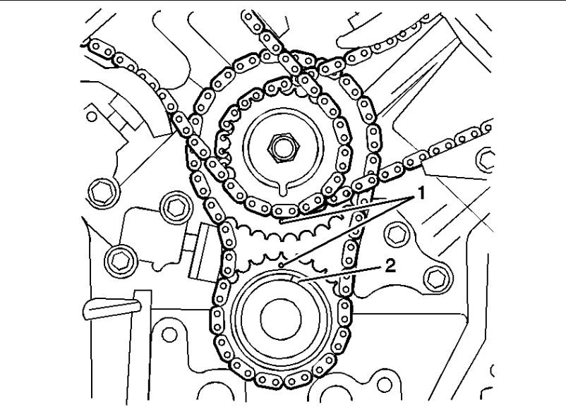

14 and 17
They are for bank 1 and 2. Good chance the timing chain is worn and the marks are not lined up correctly.

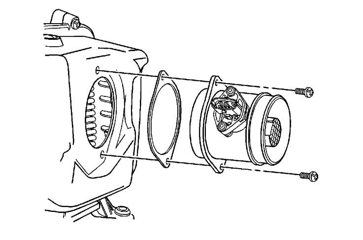

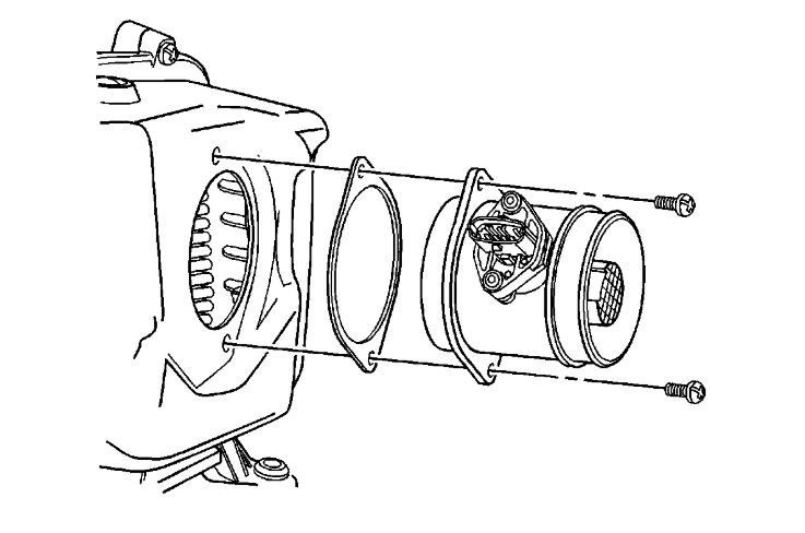

1101
Usually the mass air flow sensor
DTC P1101

I would start with the timing chains. Looks like they are worn.

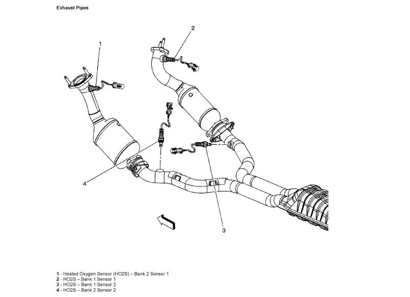

And in addition. I should have have said this sooner. But the guy I bought this vehicle from said the rough idle and misfire started after getting catalytic converters replaced.
May 14, 2019 at 5:53 PM
The converters have no effect on the rough idle.
May 14, 2019 at 6:03 PM
DAYTON41799
  • 20 POSTS
I know. But he just notified me that the problem did not start until he got I back after they got replaced. So I was thinking sensors that might have been jarred or damaged in the process.
May 14, 2019 at 6:05 PM
No, there would have been codes if that was the case.
May 14, 2019 at 6:11 PM
DAYTON41799
  • 20 POSTS
So none of those codes are for o2 sensors??
May 14, 2019 at 6:18 PM
There is one for a heated sensor. But that is for the heater portion, not the sensor part.
and again, it will not cause the engine to run rough.
